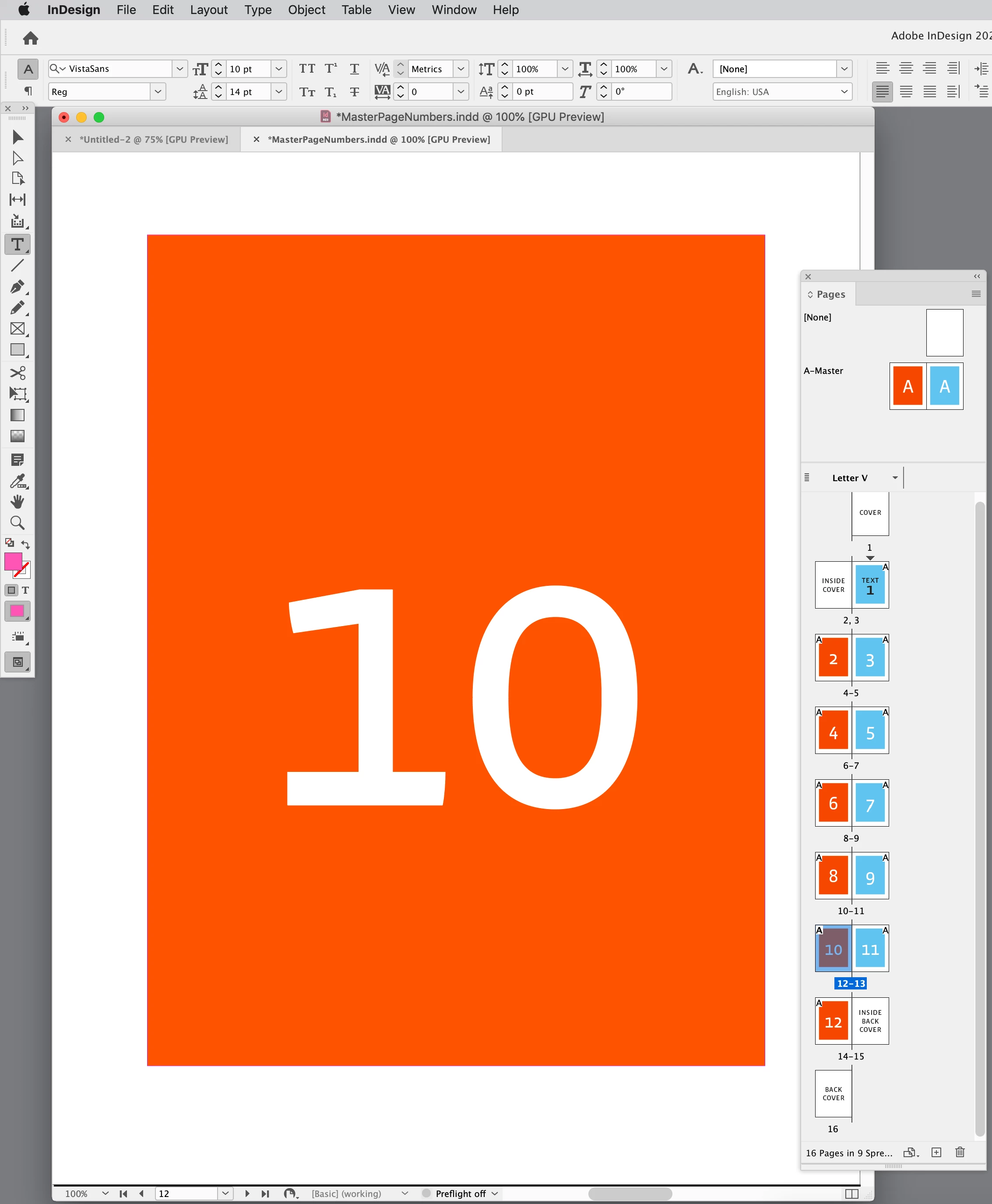

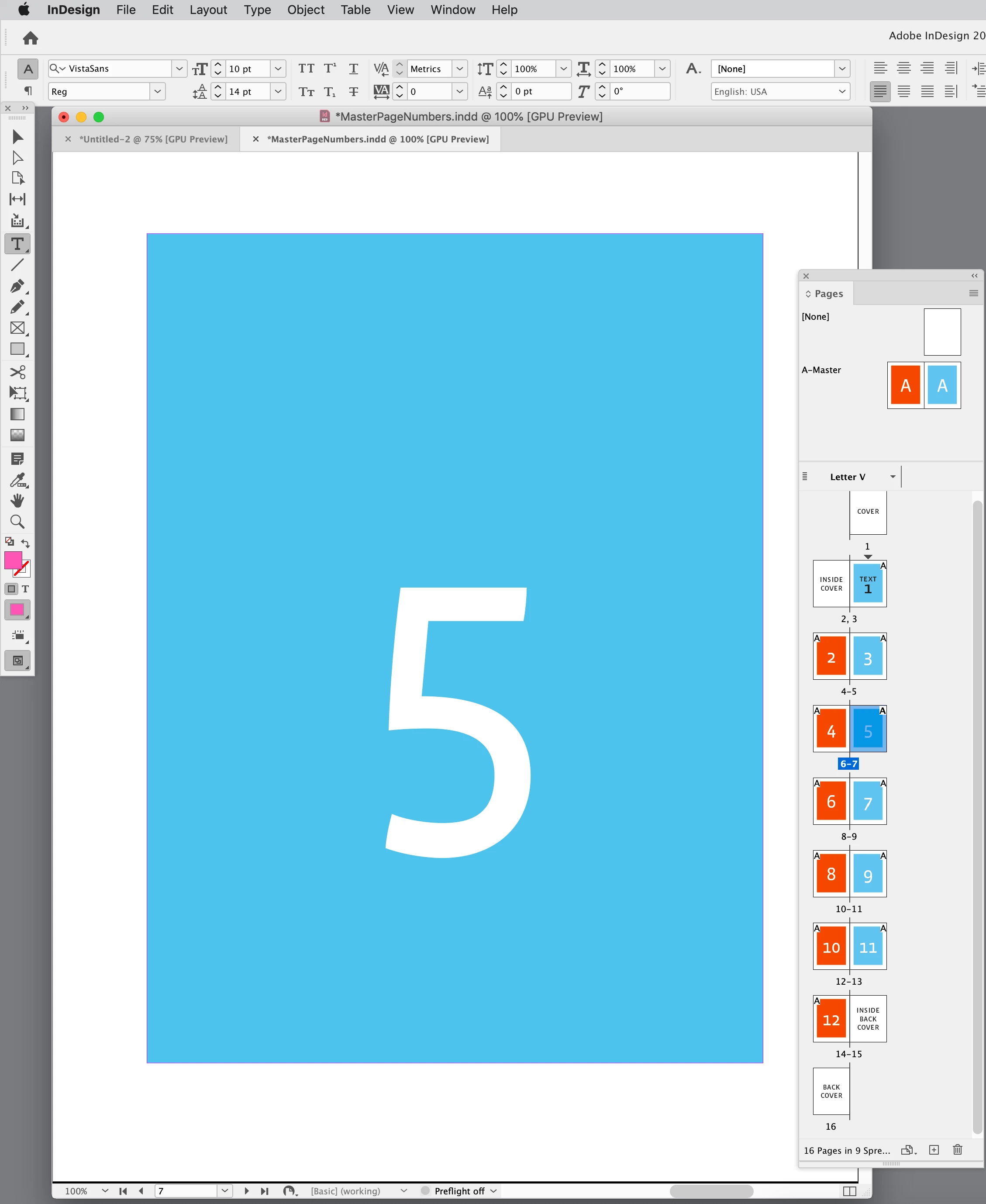

Adjust your layout window so a single page fills it, then double click a page in the Pages panel. Here the view is of page 5, and a double-click of page 10 centers 10 in the layout window:
A layout window’s bounds are scriptable.

How did you achieve that?
Fit page in window doesn't work in facing pages mode for me.
It just fits the spread.
rob day
September 30, 2022
I adjusted the layout window to be the same aspect ratio as the document page.
