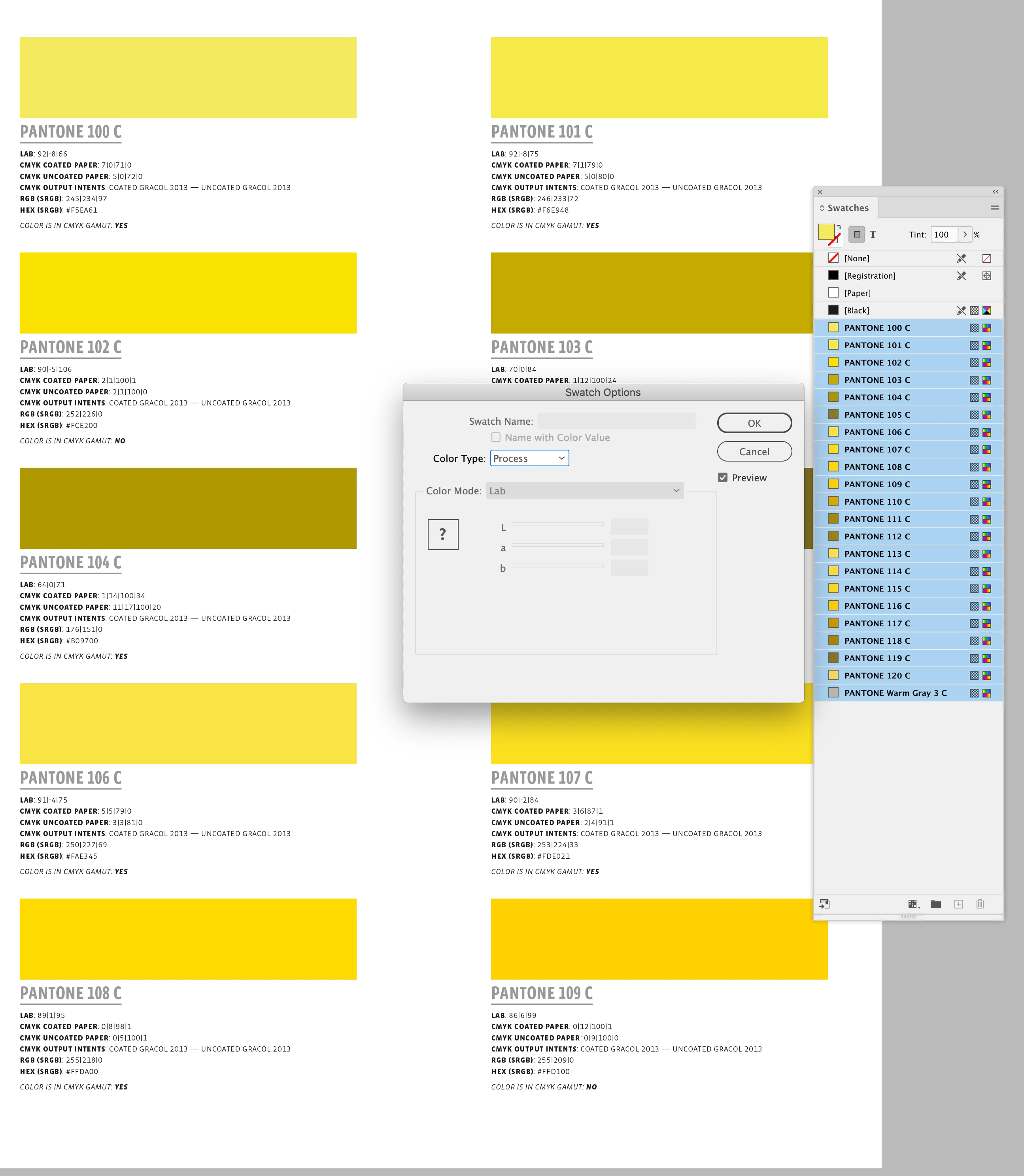

Another way to do it is Shift-click all of the Pantone Spot colors, choose Swatch Options from the Swatches flyout menu and set the Color Type to Process. With the colors set to Process the conversion to CMYK can happen by settting a CMYK Destination in the Export>Output tab:
Ink Manager does not properly color manage the conversion to CMYK when a solid Pantone ink is set as a tint. If you know all of the logo colors are set to 100%, Ink Manager will work.
