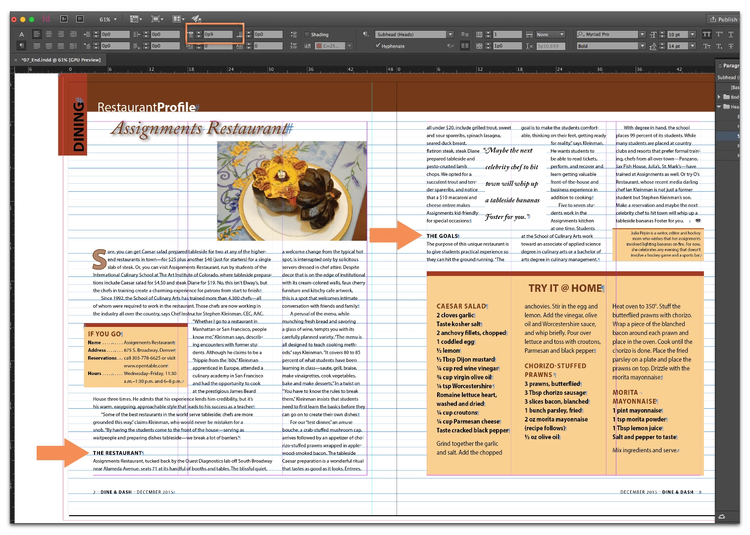

I'm trying to cut down the amount of space between paragraphs within one text box, or adjust the setting for when you press enter to make the space smaller within paragraphs. I'm trying to align some text to a baseline grid and would like to cut it down by a line or two. In the image, it's the space between the two sections under "Work Experience" that I'm trying to decrease. Also, is there a way to make this change apply to only one paragraph?

    Baseline grids are awesome in that they align everything to the grid. And they can be a nightmare because they align everything to the grid.
    If your body text is, say 10/14, the baseline grid should be set to 14 pts to match the body text leading. If you add even one point (minuscule!) of spacing after, the text hops down 14 pts to the next grid line. Spacing is always added in integral multiples of the grid value, in my example 14, 28, 42, etc. When you need to add flexibility into the spacing, it is time to take that element off the grid.
    In the first example, in the main story the body text and subheads are on the grid. Even though the space above is defined as 0p9, they pop down one entire grid line (14 pts).

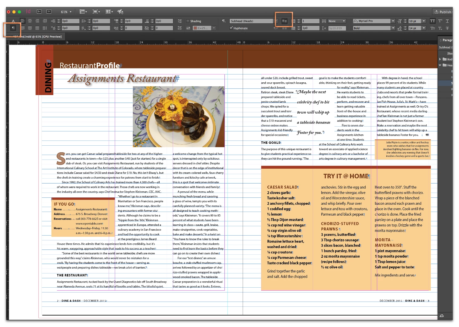

    In this example, the subheads are off the grid and adhere to the specified spacing value.
