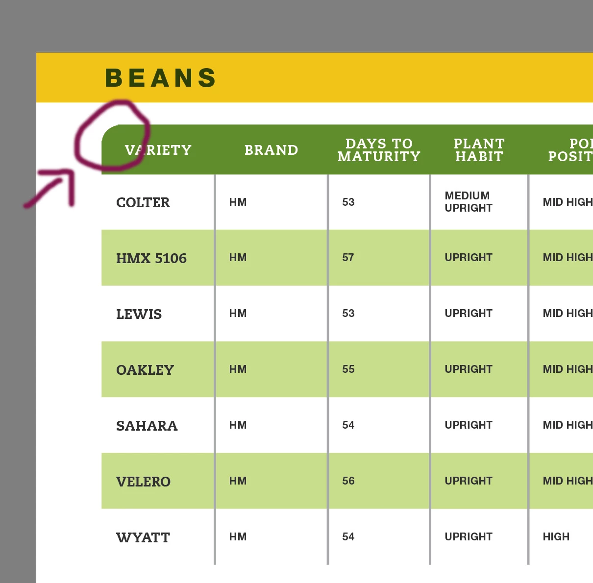

I've looked around the forums and not been able to find the answer to this question.
I am trying to achieve this effect on the outer corners of a number of tables:
I have tried to create an additional empty column to the left of the first column, convert that new corner cell to a graphic cell, convert that graphic cell to a rectangle and then round one corner of the new rectangle. Unfortunately, I ran into two problems with that: 1) The additional column added unsightly "padding" to either end of the table and 2) Unless I made the column very wide (leading to more padding), I was not able to have a rounded corner of a large enough radius- it seems like the corners are limited to being rounded only to half the width of the object.
So my question is: how do I round the corners, as in the image above, on only a couple of cells per table, without running into the problems above?
Thanks!

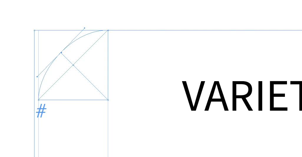

you were on the right track trying this by converting a text cell to a graphic cell.
But you'll need a couple of cells to get the right rounding, the smaller radius.
And you are restricted to a limit: the minimum width and height of a cell.
Could be a problem, if the radius is very small. So best set all insets of the cells at least in the header row to 0.
In steps:
[1] Make the width of the side column the size of the radius.
[2] Split a cell. Depending on your radius you'll have to do that more than once:

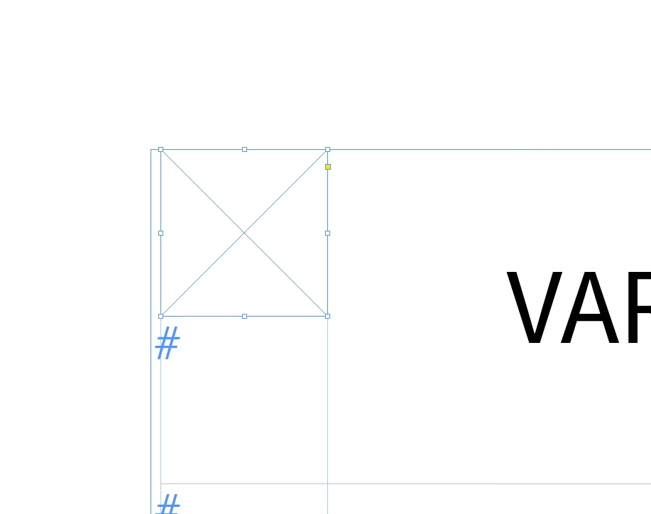

[3] Do a graphic cell out of the corner text cell:

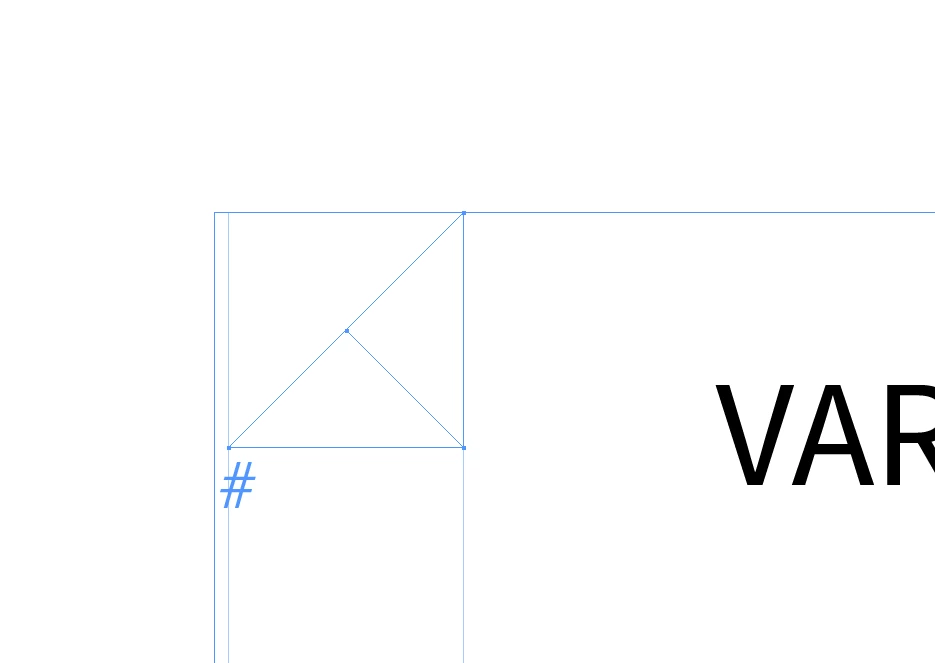

[4] Remove a path point:
[5] Add a path point at the diagonal of the triangle.

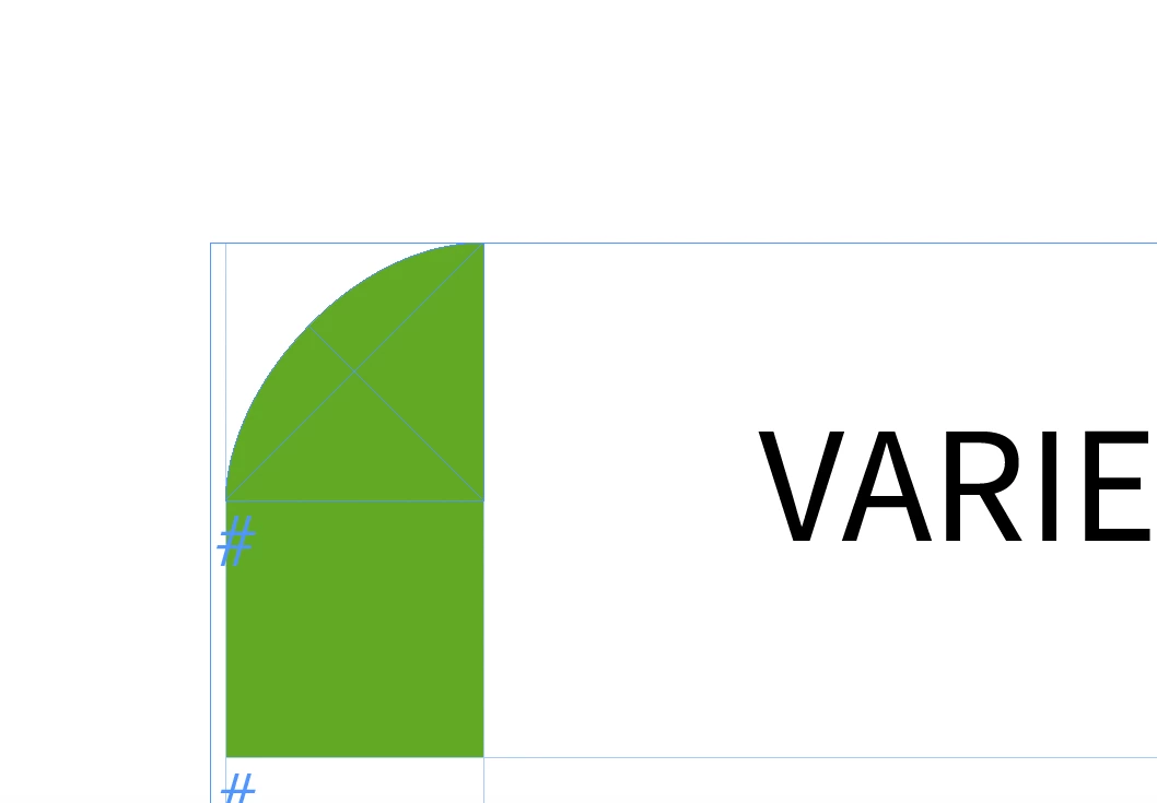

Convert the path point to a symmetrical curve point, drag the path point towards the left upper edge and adjust the handles so that a quarter circle is done.
[6] Apply fill color.
You now could copy this corner cell over to the right corner cell and flip the object in the graphic cell.

May 22, 2017
Hello again,

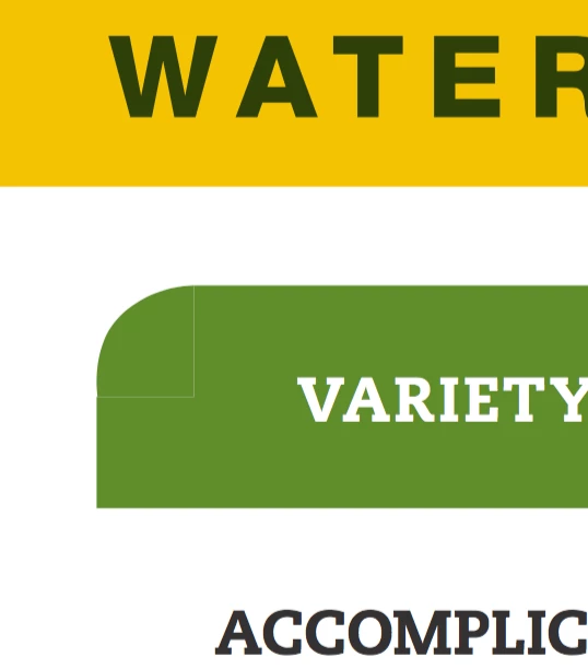

I've gone ahead and created all of the rounded corners as you suggested. It certainly seemed to work well. But I am having a glitch come up and am wondering if you have any ideas.
When I create that rounded upper half of the cell, I can get it to round more or less correctly. But there is a micro-gap between the color of that corner cell and the surrounding cells- probably no bigger than one pixel. Here is a screen shot:
Despite trying a bunch of things, I've been unable to get rid of that. Do you have any suggestions for how I might do that?
Thanks so much!
May 22, 2017
make sure, that:
1. The cell borders are not only 0 in stroke weight, but also that color [None] is applied to the stroke.
2. Make sure that the same x values are used for the path points at the right edge of your quarter circle and that the same y values are used for the path points at the bottom. I can see from your screenshot, that the pathpoint at the bottom left edge will npt align with the left edge of the cell.
3. Check the point type of the path points so that you can be sure that the two edges are absolutely orthogonal.
4. Finally check the dimensions of the quarter circle.
Its width and height should be exactly the same as the cell's width and height.
Uwe

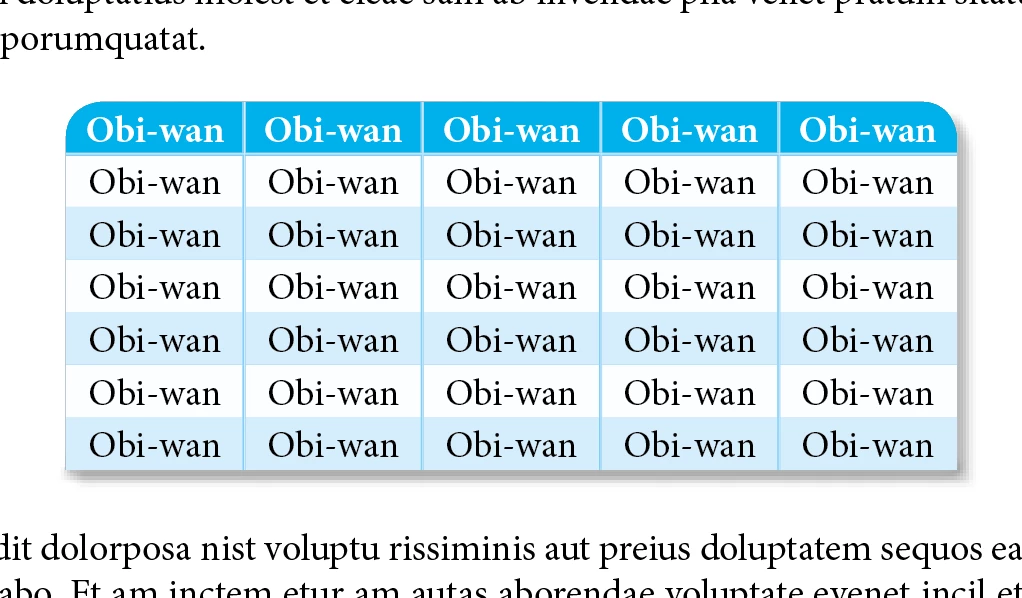

Serious!    I've just typed "round corners table" and the first catch is:
Round corners of a table in InDesign
… and this video:
… and finally this:
Maybe the op wasn't interested because this script is not for free!
