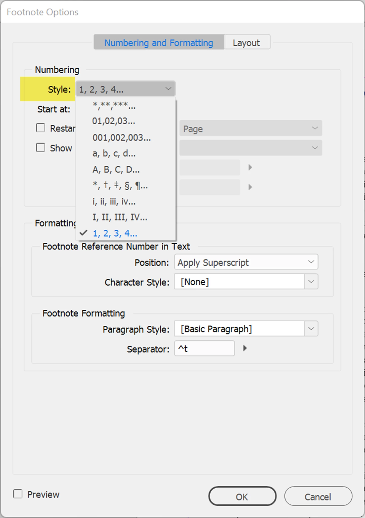

1. References/Footnotes require specific tagging and hyperlinks to be fully accessible. If InDesign's footnote utility is used to insert the footnote, then you'll have acceptable tagging in the PDF.
However, InDesign's footnote utility doesn't let you use any Dingbat character, only those shown in the Footnote Options dialogue box below (Type / Footnote Options):

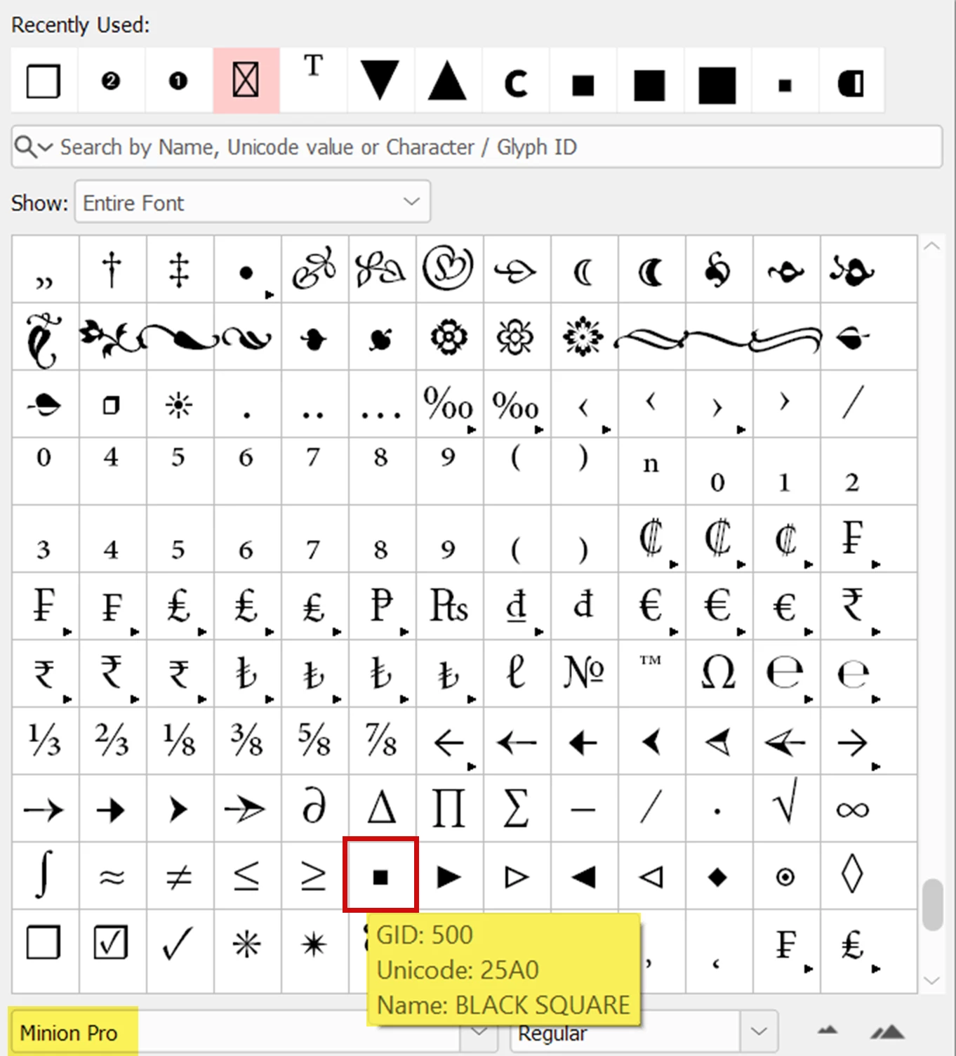

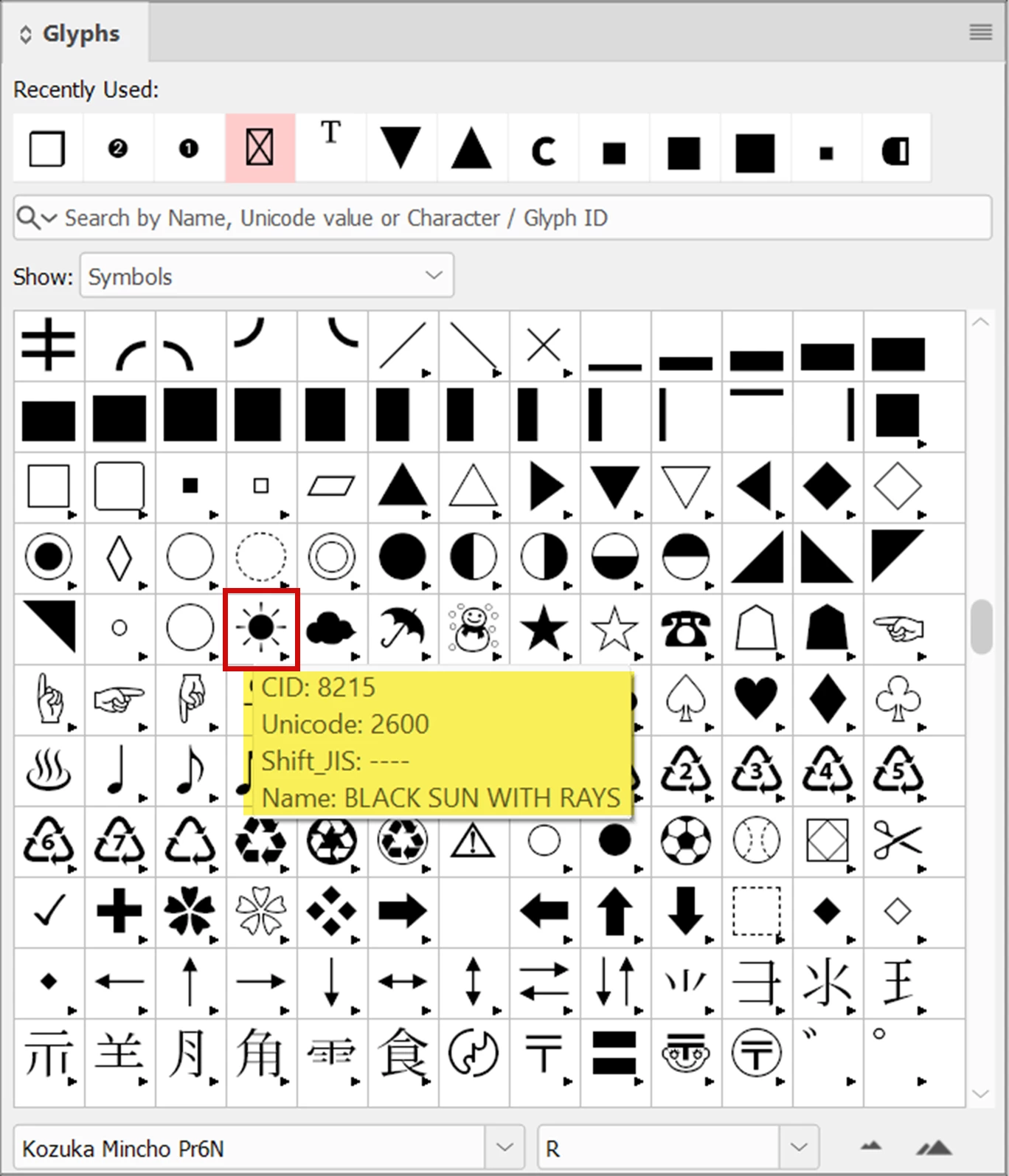

If you still want to use a Dingbat character, you can't artifact it (aka, hide it): it's required so that the <Reference> tag and hyperlink can be applied to it. Therefore, you must use a Unicode glyph from an OpenType/Unicode font so that it can be recognized by screen readers and other AT (assistive technologies) — and voiced appropriately, along with the hyperlink to the footnote.
Different OpenType/Unicode fonts have different dingbat glyphs on them, so use InDesign's glyph panel to discern which has a glyph for your purchases. Over over the glyph and check its Unicode codepoint and Unicode name:
The usual Symbol, Zapt Dingbats, Wingdings, and Webdings fonts are not Unicode and won't work for accessibility, so check your fonts to choose one that is OpenType/Unicode.
