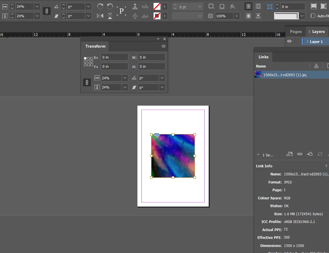

Anyway - how does InDesign Calculate it?
Same was as you can

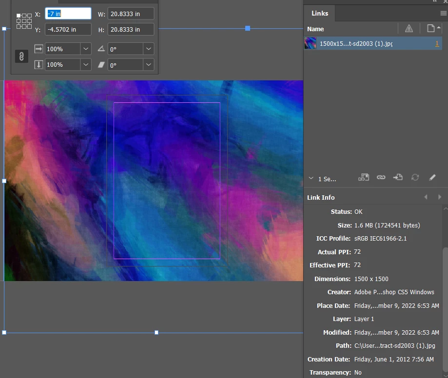

If it's 1500 x 1500 @ 72ppi
You place that at 100% then it's 1500 x 1500 with 72 pixels per inch
Your size is 1500/72 = 20.83inches

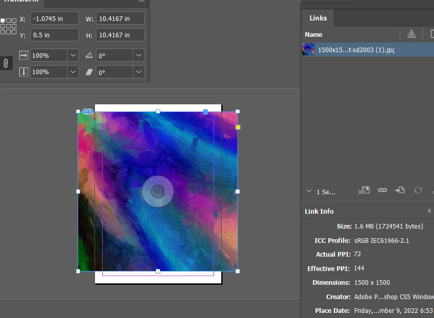

If you place it at 50%
And it's half the size
And double the resolution
A 72PPI image placed at 24% will yield 300PPI

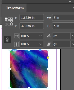

If you wanted to know what that size is before placing.
Original size is 1500 x 1500
so it's 1500/300
= 5 inches
That's it - basic division of the Pixels by the resolution.

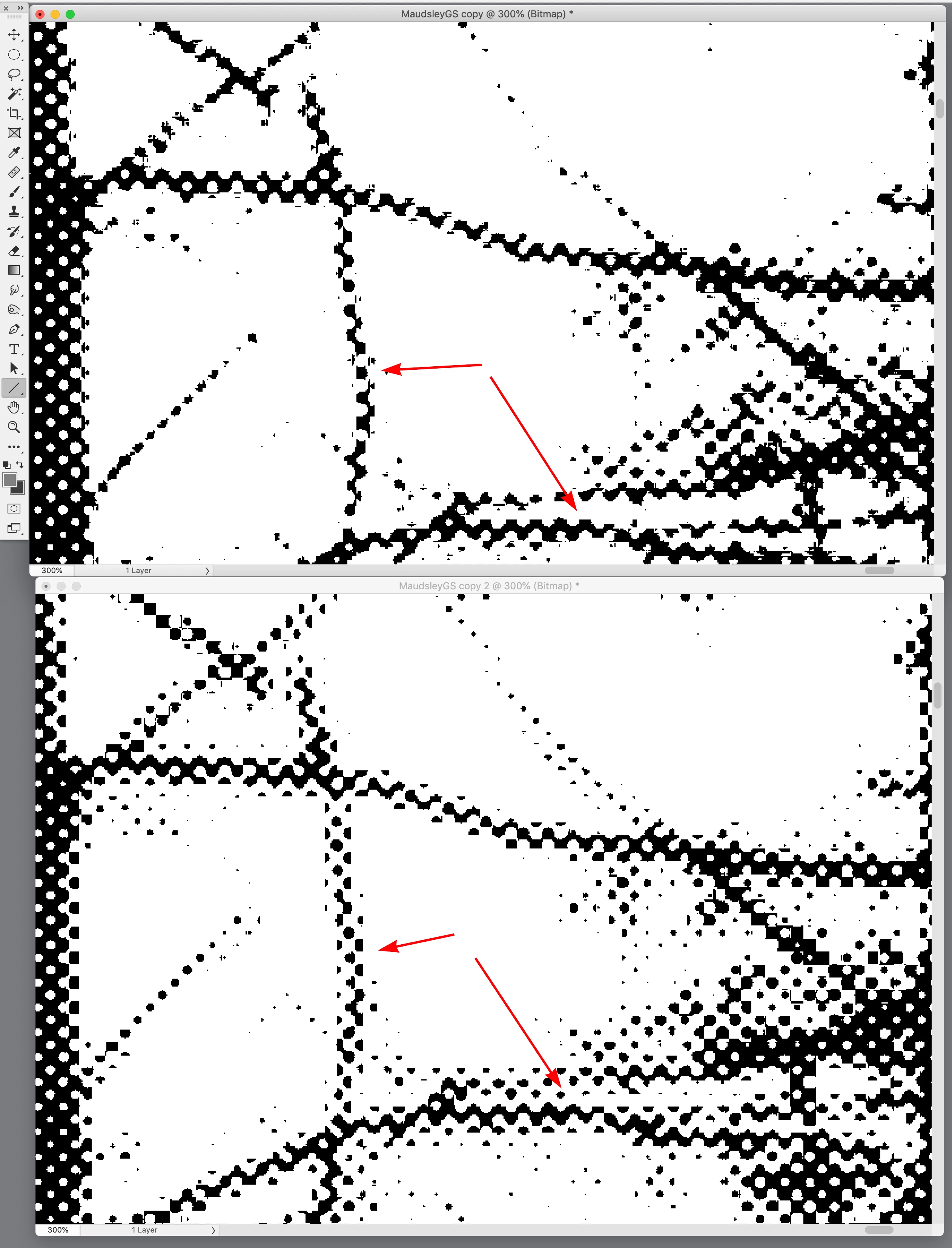

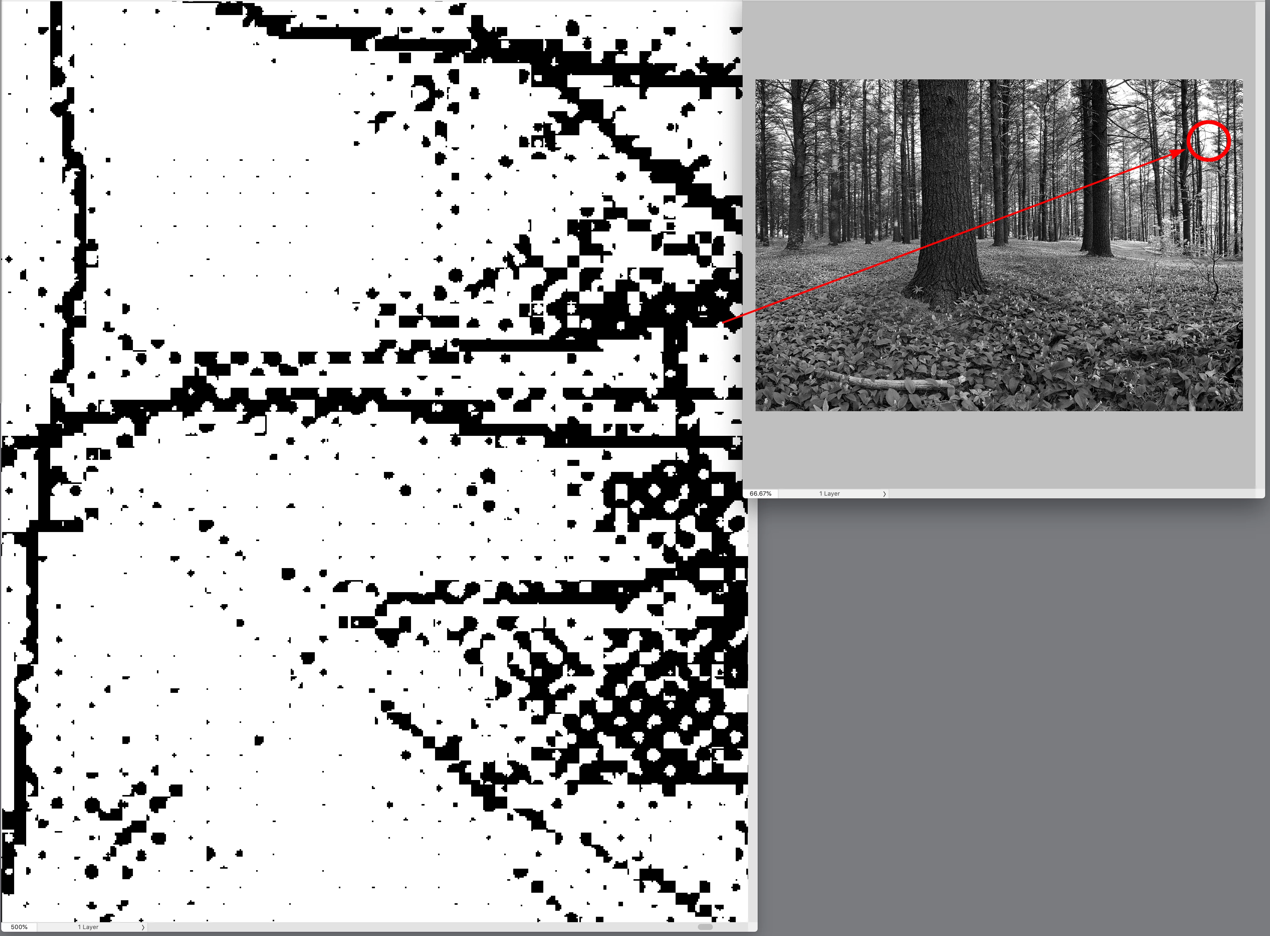

Hi Eugene, I think the idea that there is a multiplier that works for all images assumes the halftone screen pattern is uniform, but that’s not the case with images that have areas of fine details at high contrast—higher resolutions would be decernible in those types of images.
In this halftoned example the fine details in the tree branches approach line art and there’s no longer much of a screen pattern running interference:
Here are 150 LPI simulations at 2400 DPI—600ppi top and 210ppi bottom. I can see the structure of the halfone screen in the branches is different—in the 210 version they are fatter and softer:

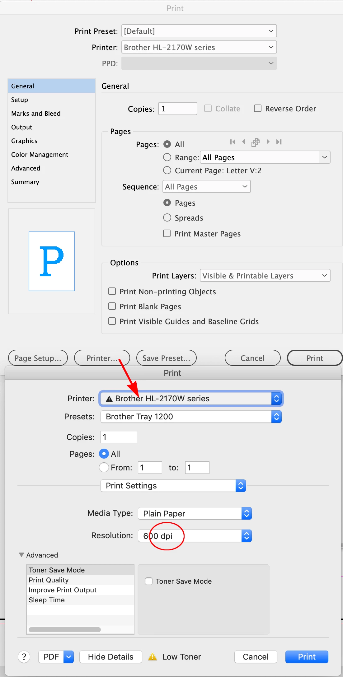

DPI is the print device resolution, which is set by the printer driver not InDesign.
As Peter suggests most print devices convert a continuous tone image into either a halftone screen, which has a resolution referred to as Lines Per Inch (LPI), or a stochastic screen.
The halftone screen dots are drawn with the smaller printer dots, and the illusion of tonality is created by modulating the size of the halftone dot. A platemaker outputting at 2400 dpi can accurately draw a 150 line halftone screen, my 1200 DPI laser printer can draw a 90 LPI halftone screen.

InDesign can read and scale image resolution, which is referred to as Pixels Per Inch (PPI). The image resolution of  a placed image at 100% is listed as Actual Resolution in Link Info panel, and the scaled image resolution is listed as Effective Resolution. If you scale an image with an Actual Resolution of 300ppi to 50%, the pixels are half the original size so its Effective Resolution is 600ppi.
