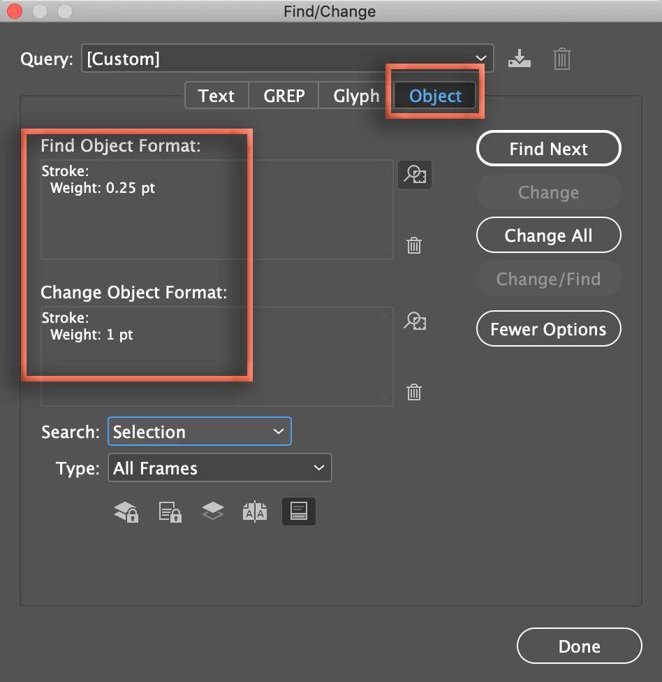

Barb Binder
Jun 5, 2019 3:55 PM UTC
For others reading this thread who just want to update one variation—and not a range of variations—you can use an Object Find/Change.
~Barb
