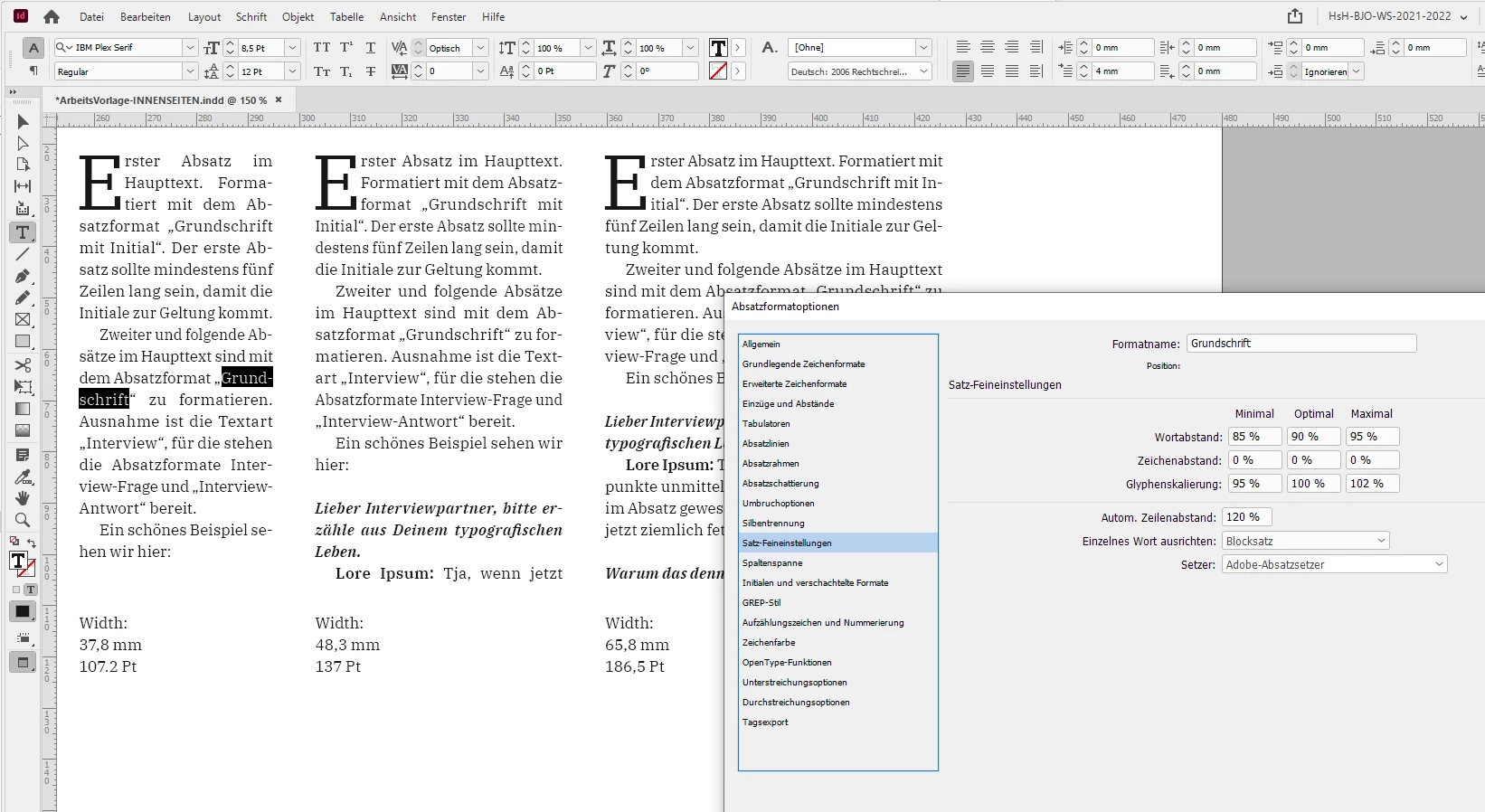

Hi jmlevy,
there are no magic numbers here. It depends on the font, font weight, font size and a myriad of other factors set in the paragraph style.
See into this sample below where the narrow column is not optimal for the German text, but the other two function very well. You can always tweak a bit and optimize. And you would perhaps end up with 4 to 5 basic styles where the layout person has to use style A for text column widths around 35 to 40 mm, style B for text column widths around 45 to 70 mm and so on.
And there is also the paper color. Text column one would be perhaps frowned upon when printed on a glossy paper, but hardly if you print on a newspaper with low contrast between the text color and the background.

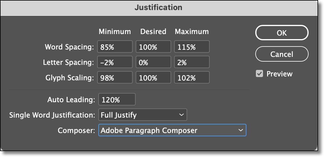

Hi @Pauliina5E3D:
First of all, you should be able to type in Finnish—we have translation options—although what you wrote was very clear.
Here are the settings that work well for me—you can experiment with the values to see what works best for you. Do keep in mind that you want to have a line length of at least 40 characters (including spaces). When lines are too short, nothing really works well.
~Barb

Than set "Minimum" - "Desired" - "Maximum" values
vladan saveljic
October 9, 2021
you can set that values in:
Paragraph Style Options > Justification > Word Spacing
