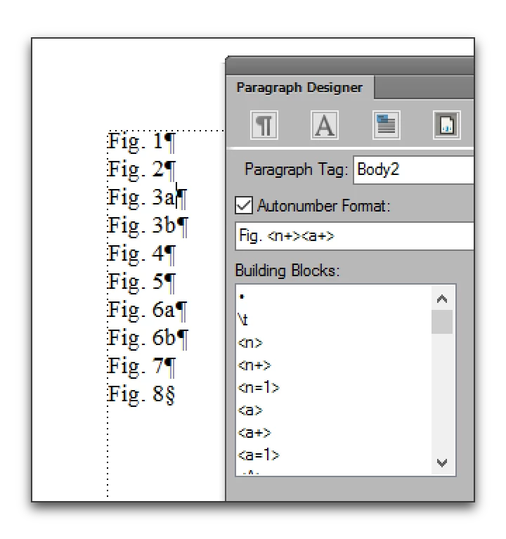

So here is where I am on your question, Janus: I can do this in Adobe's other page layout program— FrameMaker—with three styles, (which I worked through to make sure I had the logic down). But I can't recreate it in InDesign—I'm bumping into limitations that I don't see my way around. I love a good puzzle, but I'm stymied.
