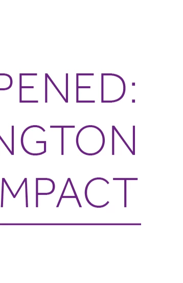

I very rarely use right aligned text (maybe ten times in a career of 40 years) but I have a use for it now in a book. How do I align right aligned headings but still have the ability to adjust them so that they align visually? The heading is over 3 lines - the first ends in a colon, the second ends in N and the third line a T and they all need spacing so that the right line ends looks visually aligned.

Thanks everyone for your suggestions. This wasn't a long doc so there were no TOC issues to consider and I didn't want to spend the time setting up individiual paras and invisible characters. The solution I used was a hack but was by far the quickest and simplest - just make the text range left and add spaces to the left until they aligned on the right, with a little bit of tweaking to the left hand spaces before the text. Crude but effective.

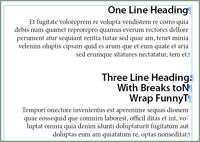

The only consistent way to get the level of control you're seeking, especially with being able to tweak characters beyond the nominal frame line, is —
  • Use an artificial right margin; e.g. set the body text in a few mm or points.
  • Use a paragraph style for the heading that allows either one line, perfectly aligned right, or allows multiple lines for multi-line heads so that each line can be right-space tweaked, including "outward," to get the exact alignment desired.
Things like inserting invisible characters is a hack (that I occasionally use, but only in "art" layouts, not running text) and the need to do "negative" kerning etc. means some phantom space has to be built in to allow it. I can't think of a second approach, overall, for a running document.

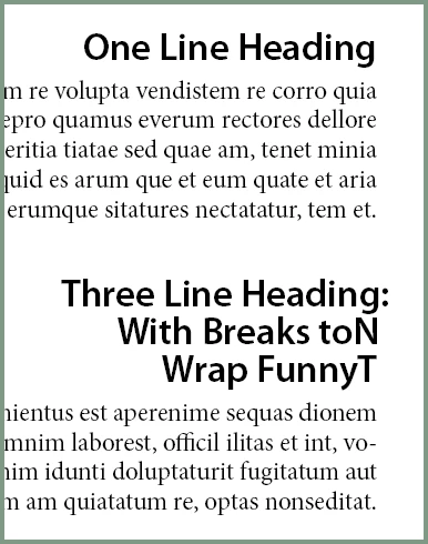

Like this (crude, but). Single style used for both headings.
Adjustments made in right margin spacing (default 6 points) on the three-line head.

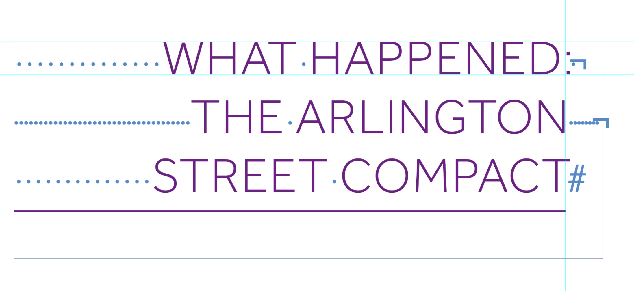

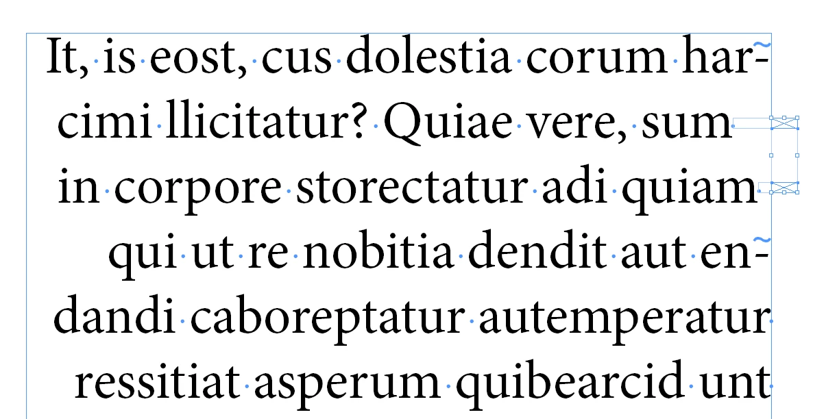

There is a trick to do that: at the end of each line type a dot (or any other character), then apply negative kerning to the insertion point between the 'real' last character (colon, T, N) and the following dot.
You can make those characters invisible by applying the Paper colour.
Problem is of course that those dots appear in the table of contents, so you'll have to delete them there after you generate the TOC.
This is a variant of forcing letters out of the frame on the left in left-aligned text. There you can use invisible characters (such as a discretionary hyphen) for the dummy characters, but unfortunately that doesn't work in right-aligned text.
