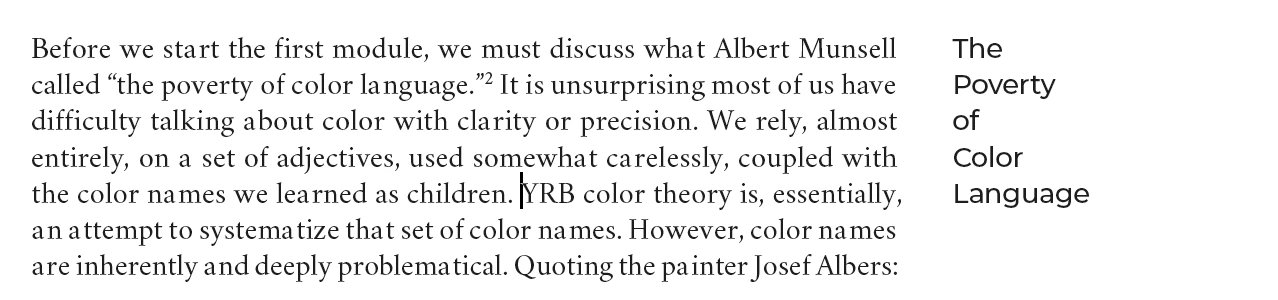

I'm using a single column of body text with section headers on the side. See photo.
How do I anchor that sidebar text box to the first line of this paragraph, so that it flows?

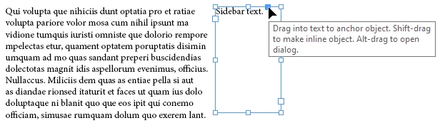

Correct answer John Mensinger
Select your sidebar text frame, then hover your pointer over its anchor node and follow the instructions in the tool tip.

John MensingerCommunity ExpertCorrect answer
January 10, 2022
