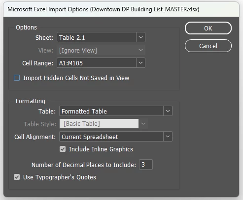

I have a column in a table that contains numbers between 1-100, and I would like the cells to fill with a color based on the numerical value. For example, 80-100 would have a green fill, 50-79 would be yellow, and 0-49 would be a red fill. Is there a way to do this?
    m1b

    DWheelsAuthor
    Apr 7, 2026 5:46 PM UTC
    Thanks, I’ve tried that, but the formatting doesn’t come in from Excel. Any ideas why? When I import the Excel file I set the Table Formatting option to “Formatted Table.”
    Dave Creamer of IDEAS
    Apr 7, 2026 5:48 PM UTC
    Try it again. It didn’t come in formatted for me the first time.
