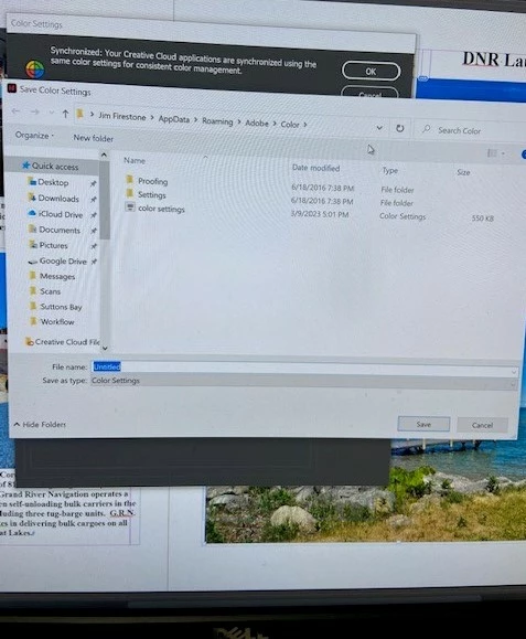

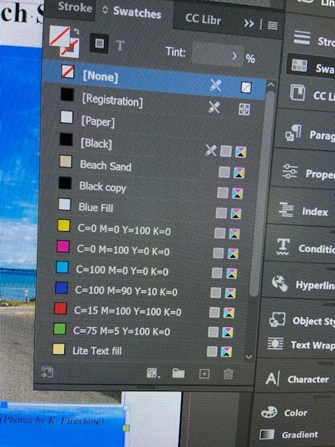

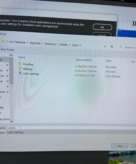

How to change all book photos from RGB to CMYK.
I think I'm in over my head. When I go to package my book, it tells me I have an error that 501 out of 505 (about) photos are in the wrong color scheme.  I've looked at as many posts here as I can find but haven't found an answer. I've looked at some YouTube videos, but I can't seem to follow them. In some cases I'm told to click here and, on the drop-down menu click here. The click here part I can't find. I don't know if  I want to change the RGB to CMYK. If you can tell me what setting I have wrong, I would appreciate it. I"ve tried to include the photos I thought were necessary, but if you want another, I'll try to get it.
