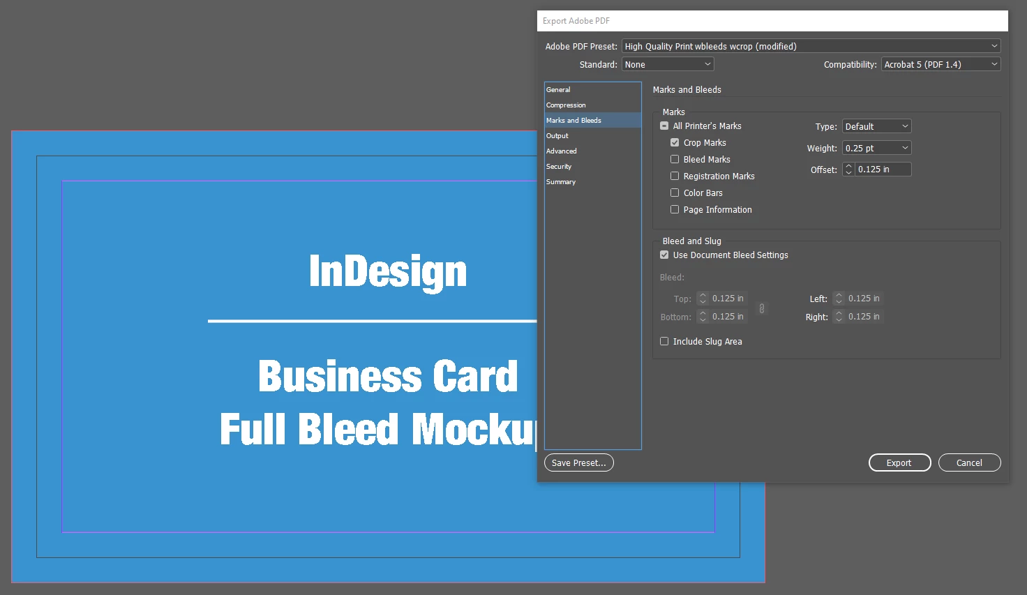

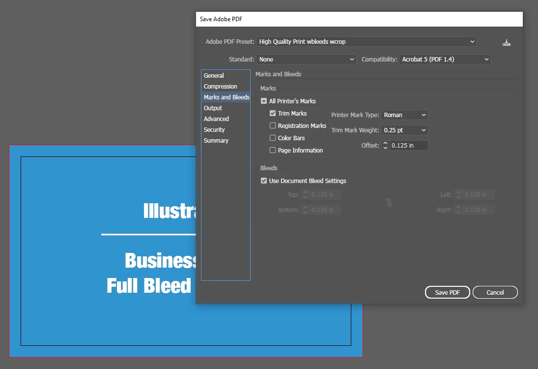

I am the graphic designer for my print company. I am trying to automate some processes and we produce a lot of full bleed print products. An issue I have encountered between InDesign and Illustrator is that it seems they have two different sized crop marks. I have all of my export settings the same, however when I export the files from each of the programs, the finished file size is different. Yes the trim size is correct for both, however it becomes an issue when creating n-up print templates. Any suggestions to help correct this?

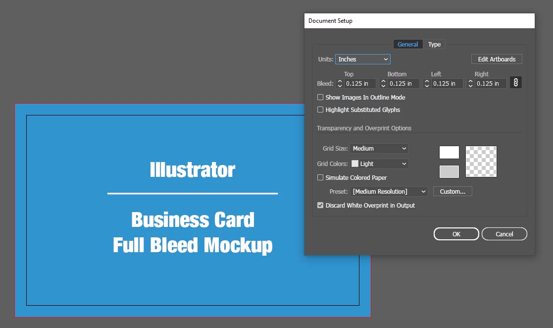

Illustrator Document Setup Settings:
Illustrator Export Settings:

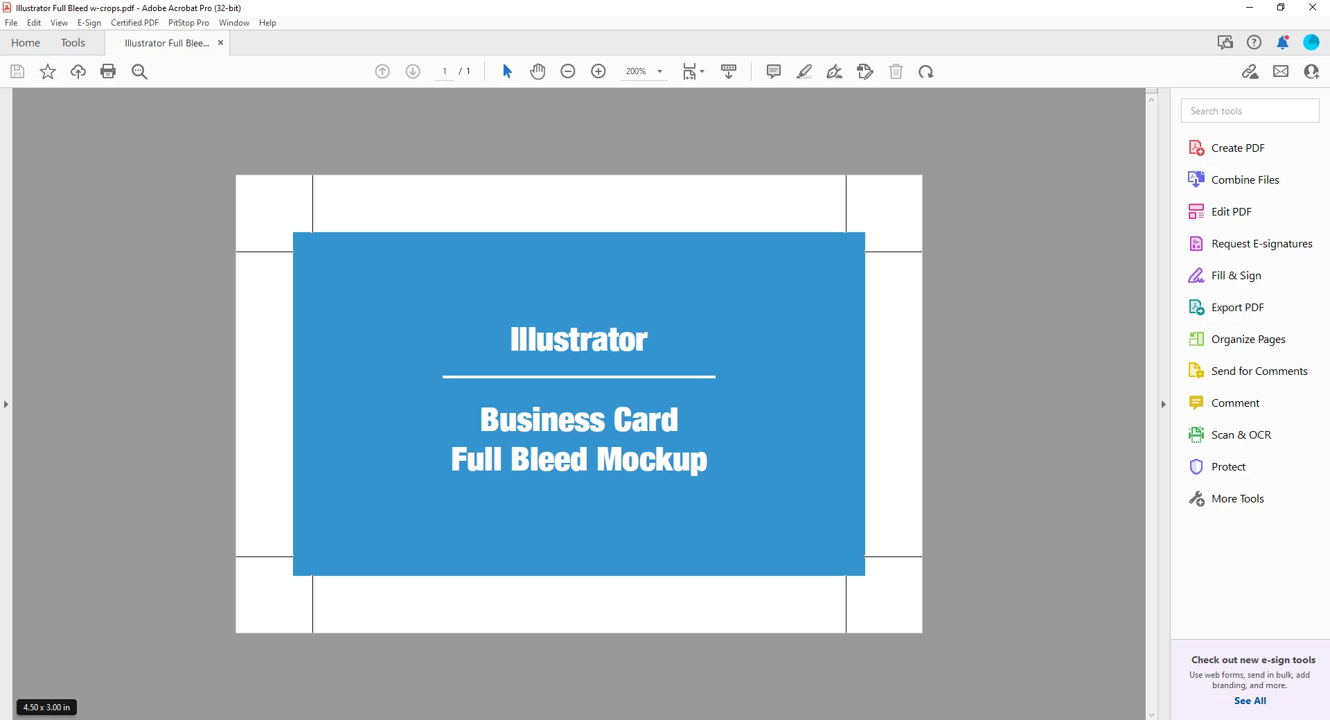

Illustrator Finished File Size (bottom right: 4.50in x 3.00in):
InDesign Document Setup Settings:
InDesign Export Settings:

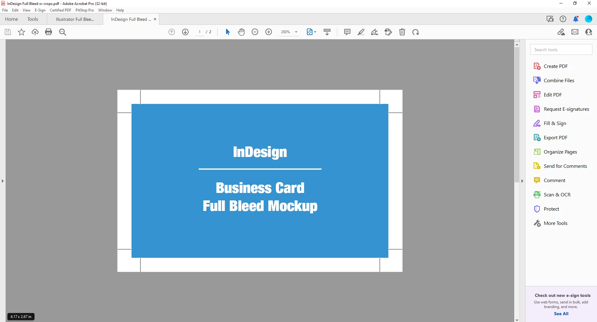

InDesign Finished File Size (bottom right: 4.17in x 2.67in):
Am I missing something super obvious? Any ideas how to correct this and keep them consistent?
Kaitlyn Monsivais
Correct answer rob day

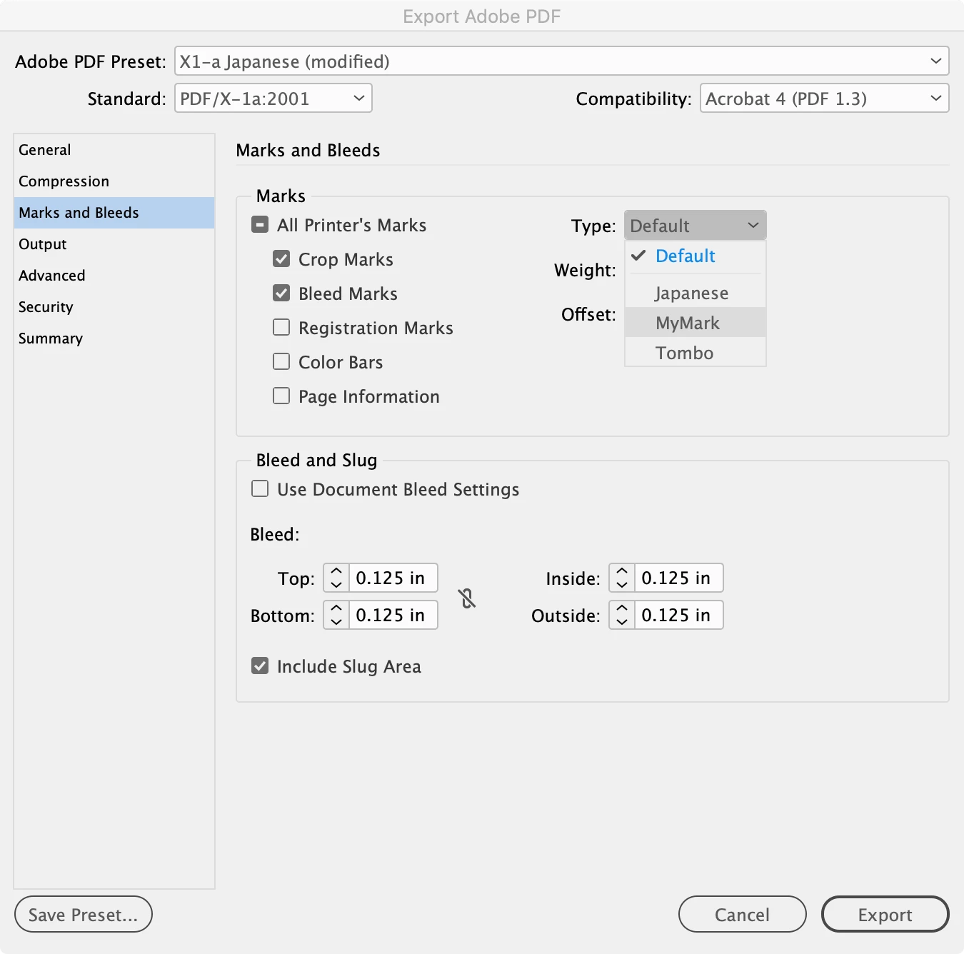

Hi Kaitlyn, You could add a .5" slug to your ID Document Setups and include it in the export preset, that would export the ID doc as a matching 4.5" x 3.0" .
Also, Marks Type can be customized, but it’s tricky see this CreativePro articlefrom 2006:
https://creativepro.com/creating-custom-printer-marks-in-indesign/

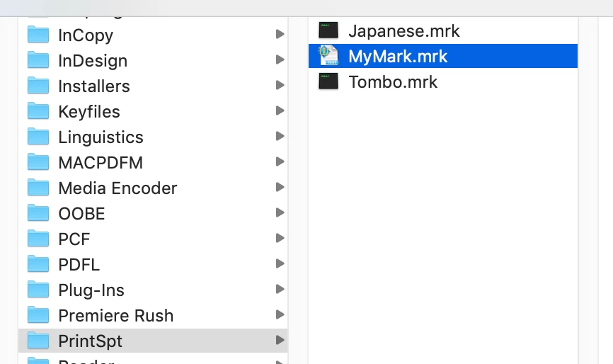

The InDesign .mrk file is saved here on OSX:
⁨Startup⁩ ▸ ⁨Library⁩ ▸ ⁨Application Support⁩ ▸ ⁨Adobe⁩ ▸ ⁨PrintSpt⁩
I can’t figure out where AI’s marks are saved.

Another thing you can do is adjust the offset of the marks in InDesign. I have a PDF export preset for my favorite printer that sets the bled to .125 and the crop mark offset to .2917 which adds a total of .5 inches outside the trim on each side.
rob day
October 31, 2022
I just tested a custom .mrk file and setting the length of the FourBleedMarks to 27 points (.375") produced a 4.5" x 3.0" ID export without adding a Slug
