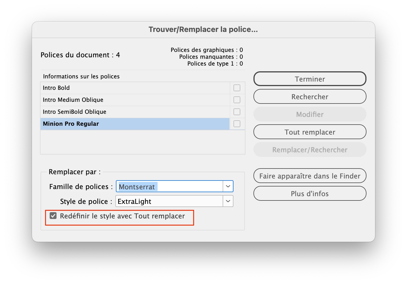

    Hi ​@marikap3737523
    Isn't the native function (find font) sufficient? If you tick the appropriate checkbox, you’ll replace the font in the style definition.
    Jul 7, 2026 4:13 PM UTC
    Find font does replace the fonts, but leaves the (+) signs in front of the styles. You can't remove them all at once, because they are needed in some places.
