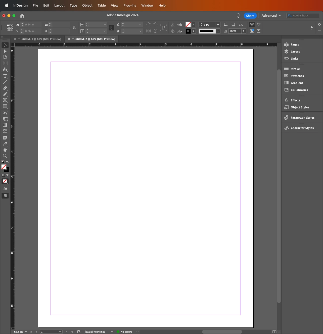

I set up a new document and changed the measurement units from the default picas to inches, which is what I wanted for this 8.5-inch x 11-inch page. My horizontal and vertical rulers now show the page sized correctly, but the tick marks are displayed in increments of two (0-2-4-6-8-...etc.). I want to show them in increments of one (1-2-3-4-...). How do I make this change?

Zoom in.

And you may have to set to Decimal inches as well.
October 31, 2023
Peter:
It certainly changed the tick marks but not the displayed numbers. Zooming in works. Thanks for the response anyway. I appreciate it.

Or increase your display resolution/display size. My MacBook shows each individual inch mark at Fit Page in Window view.

Barb:
This doesn't work on my HP, but zooming in does. Thanks for the response anyway. I appreciate it.

Hi Joe-New-to-InDesign (love your user name!):
Yes, it's dependent on your display (monitor) size and available resolutions—that's all I was trying to point out. Those of us who do this work for a living end up often end up with 1 (or several) large, high-definition displays because we need the space and detail to see what we are doing.
