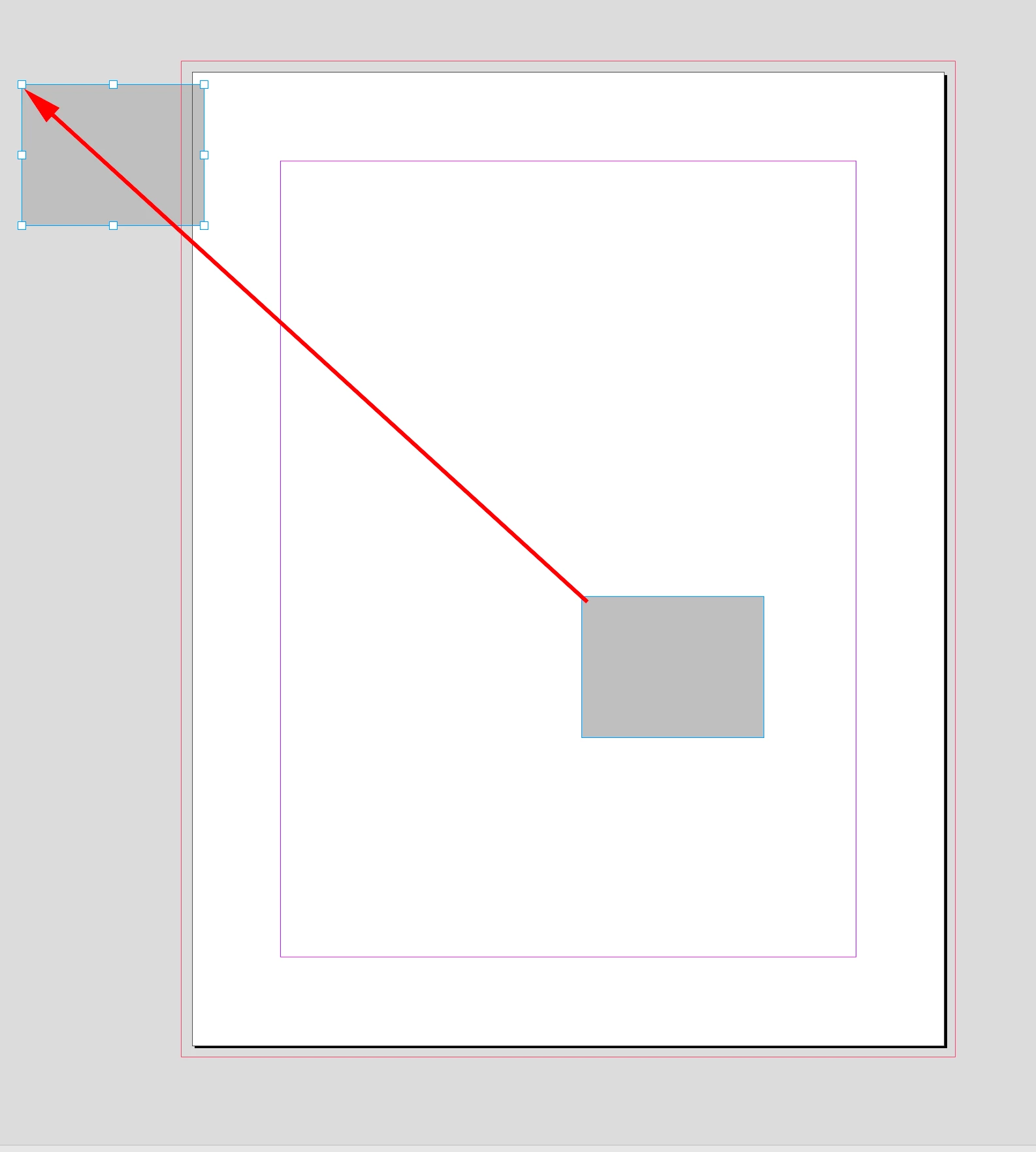

I want to move the upper right corner of a selection of items to a specific position. But at the moment the reference point of the selection of items is on the lower left corner.
app.selection[0].move([10, 10]);
Is there a way to change the reference point to the upper right corner in InDesign using ExtendScript?

I want to set the position selection by setting the position of the upper right corner of the selection.
With app.selection[0].move([10, 10]); I always get this:
Are you looking for this?:
Subtract the width of the selection from x:
var doc = app.activeDocument
var s = app.selection[0];
var b = s.geometricBounds
var w = b[3]-b[1]
s.move([10 - w, 10]);

November 15, 2022
Hi @Alexander17 , the move() method is to x,y, so you shouldn’t have to set the reference point. Make sure the rulers are set to 0—does this work?:
app.scriptPreferences.measurementUnit = MeasurementUnits.POINTS;
doc.zeroPoint = [0, 0];
doc.viewPreferences.rulerOrigin = RulerOrigin.PAGE_ORIGIN;
app.scriptPreferences.measurementUnit = AutoEnum.AUTO_VALUE;
November 15, 2022
The rulers and the measurement unit are not the problem. The rulers are set to 0 und the measurement unit is correct.
I want to set the position selection by setting the position of the upper right corner of the selection. But at the moment the reference point of the selection is the lower left corner.
rob day
rob dayCommunity ExpertCorrect answer
November 15, 2022
var w = b[3]-b[1]
