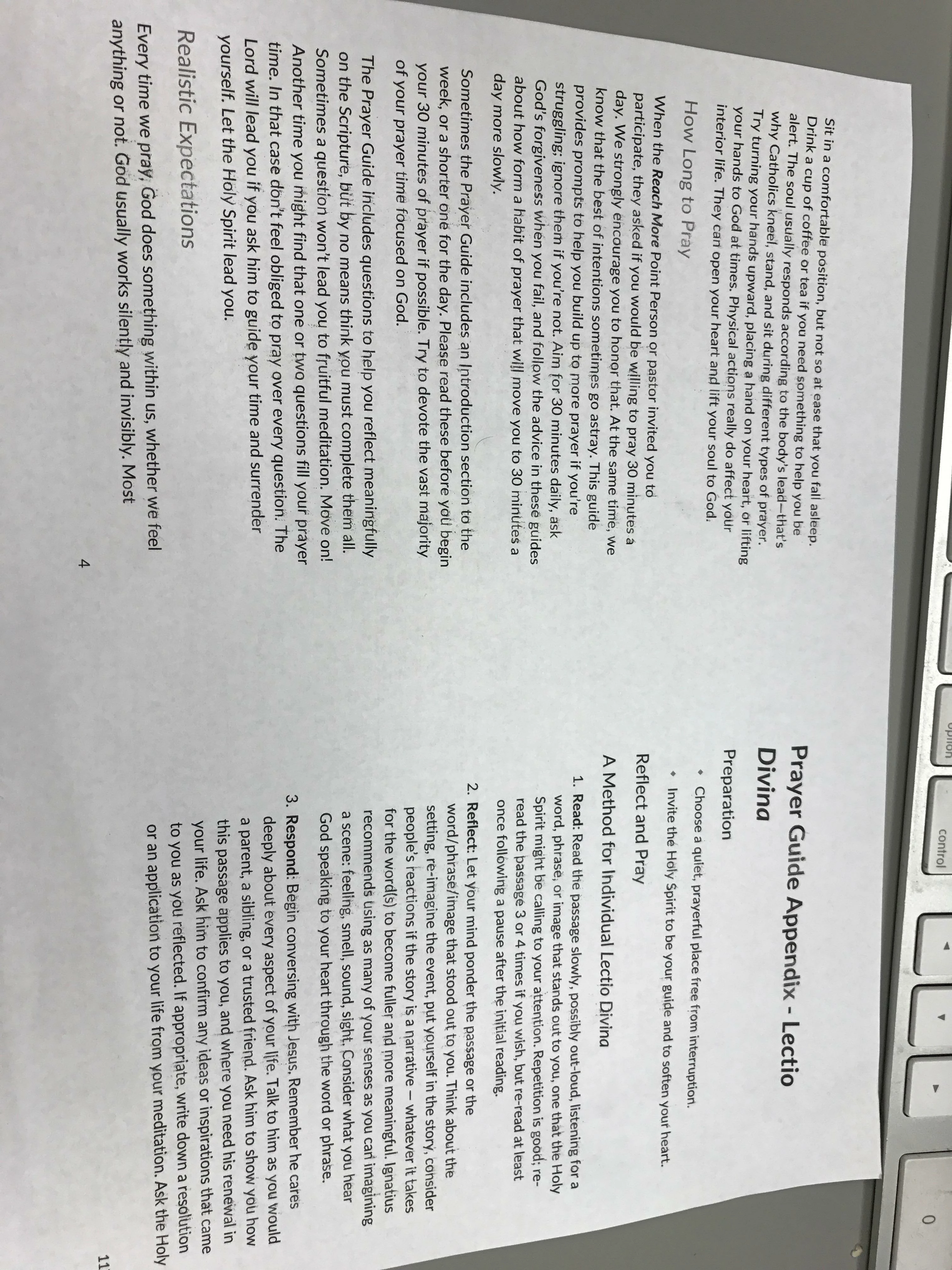

I am looking to resize a pdf of several 8.5 x 11 size pages onto Landscape 8.5 x 11 sheets with 2 pages on each sheet.

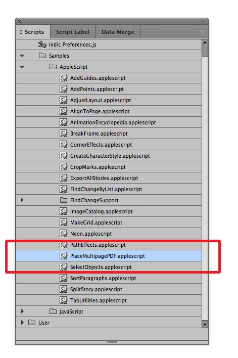

    There is a way to quickly add multiple page pdfs to an InDesign file using a scrpt that has been included in the last several versions of InDesign. First though I am assuming from your screen shot that the two pages across in landscape are the two pages shown. If that is the case I would start by rotating the entire pdf in Acrobat so that it is landscape. Since you said that the pages are already 8.5 x 11 that should work out OK.
    Then create an InDesign file that is 11 inch x 8.5 inches with Facing Pages unchecked and margins of 0. In the open file go under the Windows Menu to Utilities and choose Scripts. The Scripts Panel will look like the screen shot below:
    Under Samples>Applescript choose PlaceMultiplePDF.applescript and double-click. You will then get a navigation window and use it to find the pdf you want. It will ask you what page you want to begin and say page 1. If, as I said before, your pdf is the correct size all of the pages will pop into place. If they are not already the correct size the sizing can be then done in InDesign but at least the placement will have already been done.

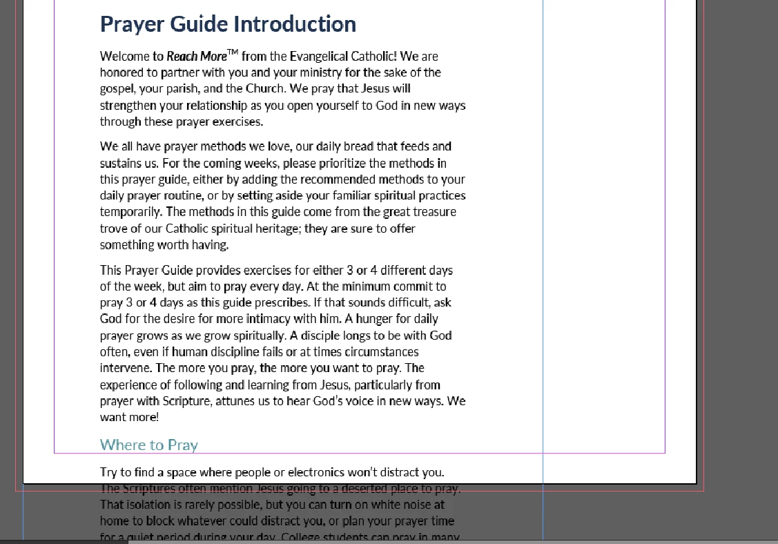

    I did all that you have said (and have done it before), but I still ran into the problem of needing to resize all the pages to fit 2 of them on each 11 x 8.5 page. How would I go about doing that?
    July 24, 2017
    This is the problem I'm running into.
