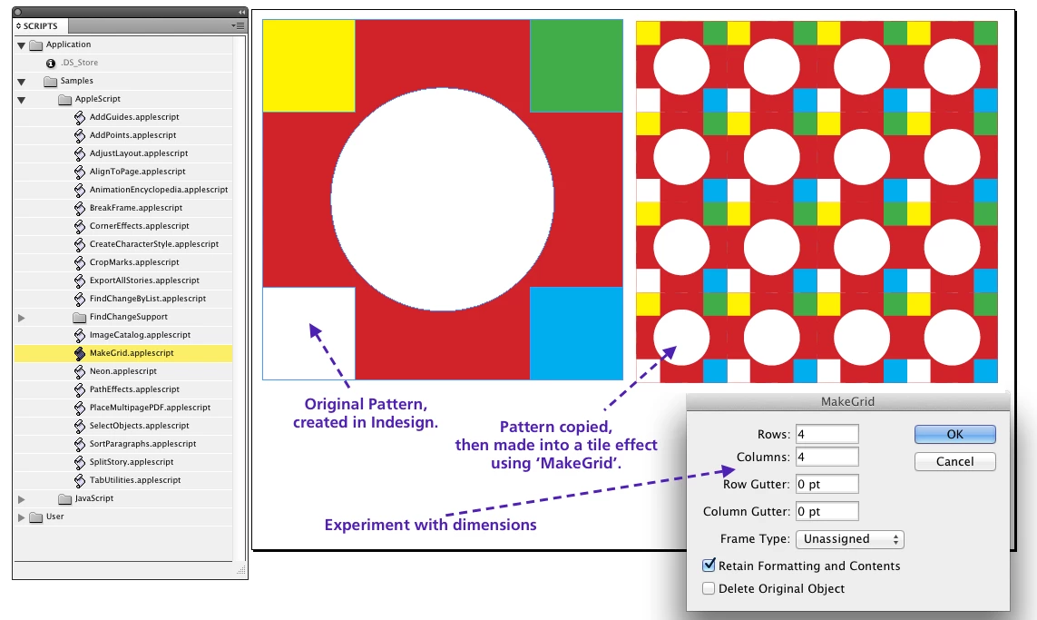

Hello Joe Caldwell
I am using a Mac and Indesign CS5.5
This is another option, it may be of use if you want to make a tiled pattern?
This works with imported images and patterns you create within Indesign.
1. Create a pattern (duplicate your original pattern to keep a copy)
2. Top Menu - Window - Utilities - Scripts - MakeGrid.applescripts
3. Click and select your pattern, you may have to scale your pattern to A4 if you want your pattern to repeat to an A4 dimension or a dimension of your choice, as the smaller multiple pattern replaces the original pattern.
4. In the ‘MakeGrid’ dialogue box put dimensions of your choice to experiment and click OK.
(see example below)
Hope it helps!
