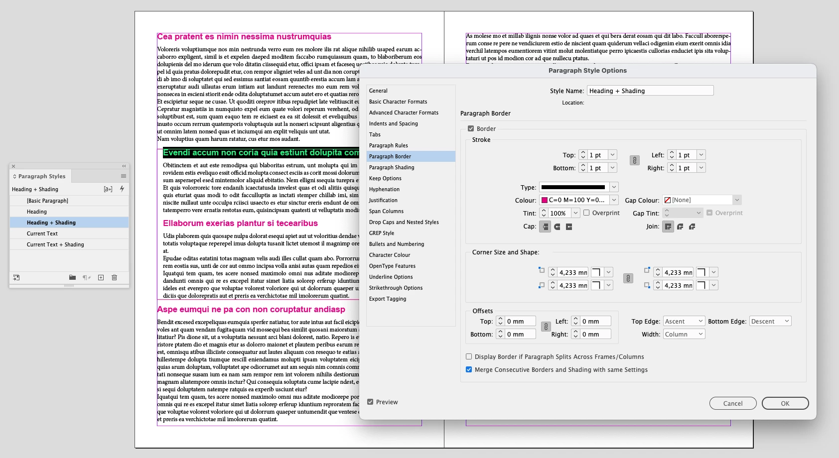

ETA: In a quick test, this was the best I could do in ID:
which exported (in both Kindle Previewer and Thorium Reader) to this:
So to get both of them with perfect merged borders, I think CSS styles will be needed. Use three identical but separately named styles in ID, which will merge perfectly, then tweak them in CSS to adjust the borders and settings on each to more or less match the ID example above.
