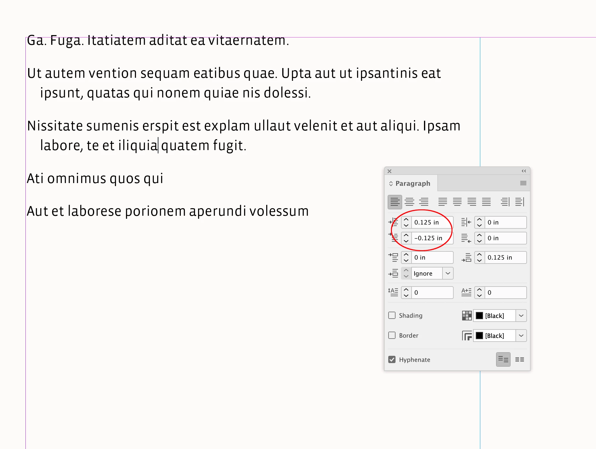

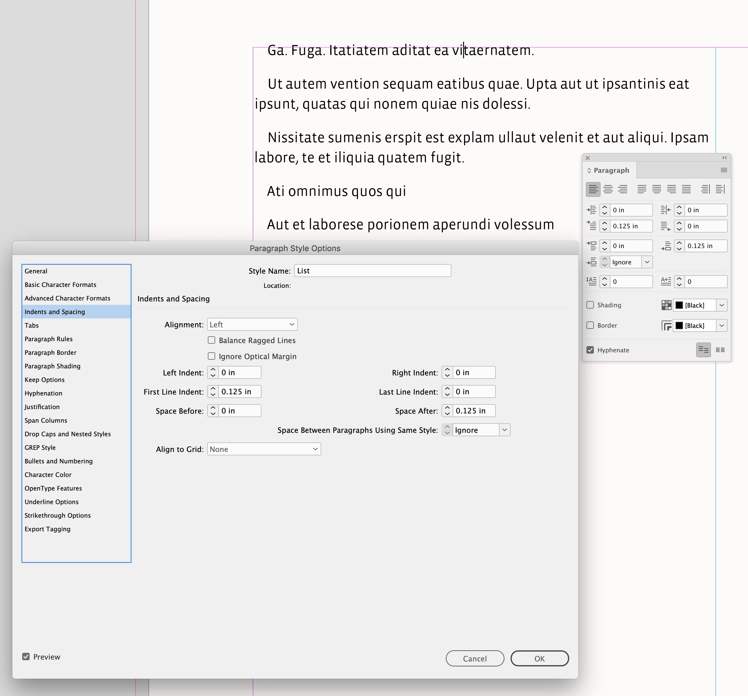

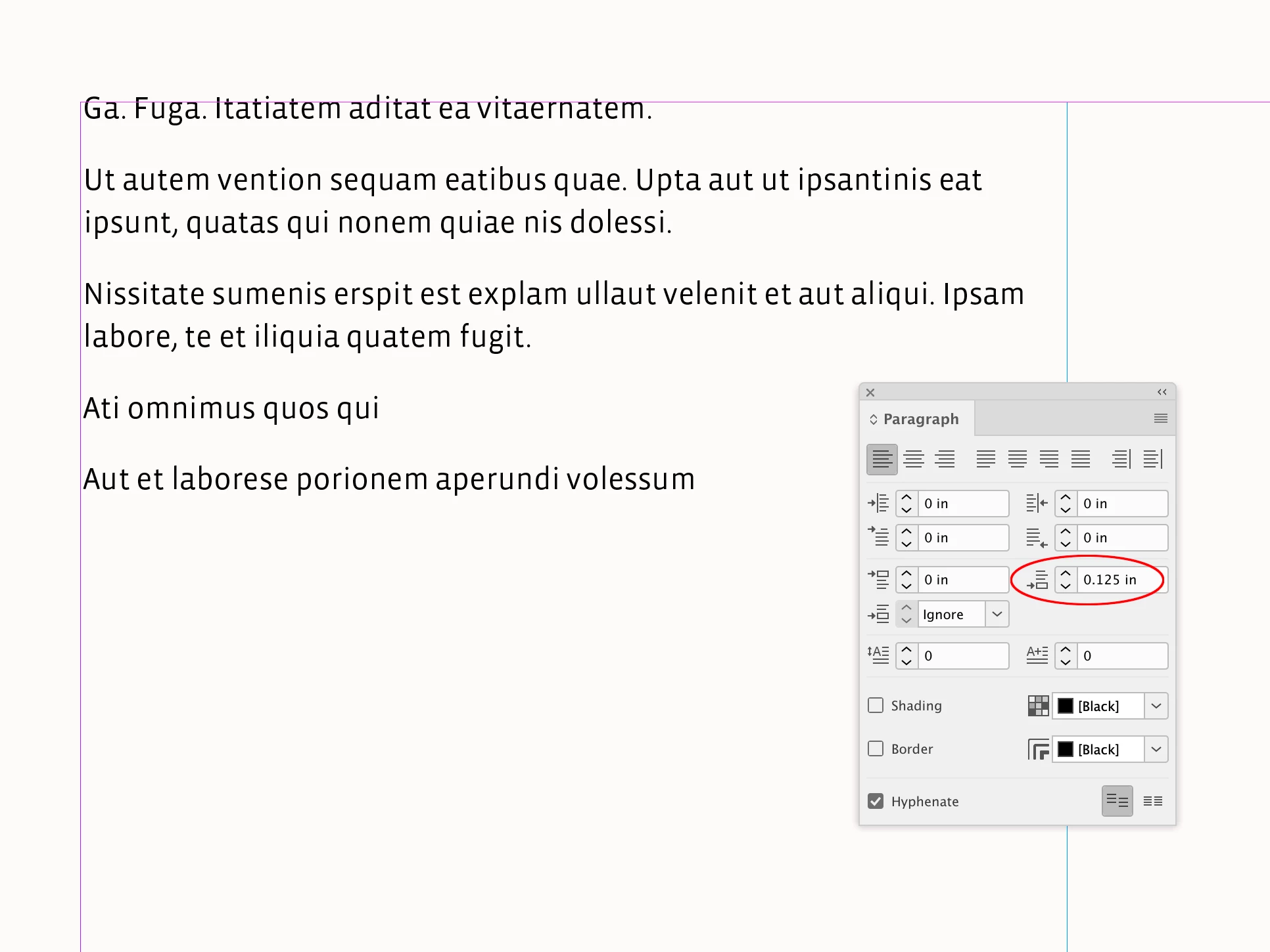

Oct 17, 2024 9:16 PM UTC
Hi @Walker31335233cnei , Can‘t you do it with Space After and Indents?

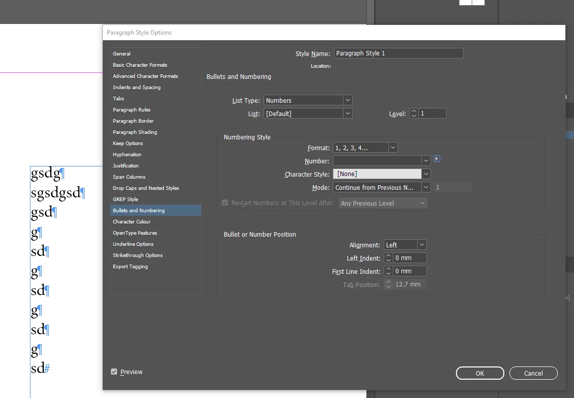

@Walker31335233cnei
OK. It won't work for bullets - but as you don't want to have anything displayed in front of the text - switch to Numbers - and make the "NUMBER:" field empty:
Or it really has to be bullet list and can't be numbered one - even without numbers?
Oct 21, 2024 4:38 PM UTC
For accessibility purposes, I just want some kind of list. Hadn't thought to try a numbered list. I couldn't figure out how to delete a bullet so if I can choose no number, this may work! I'm going to look through these replies and see what will work best for my specific needs. THANKS for offering a suggestion.
