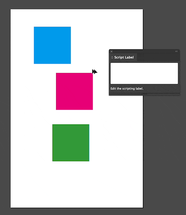

Hi @Ben-ind, there isn't any super-handy method that I can think of to do this.
One approach could be to add an event listener (to the document, for example) that would trigger every time the selection changed. It could then add your desired info to the selected item's Script Label panel. A better UI would be to create a CEP panel to show the info, but that is quite a bit more involved unless you've made one before.
Here's a quick example implementation to give you the idea. To help manage the event listener, I've set it up to alternate between adding and then removing the listener each time you run the script.
- Mark

Hi @Ben-ind, can you give us an example of what the stored data (or txt file written data) would be, for a given sample page? And how do you plan to access it? That will get things moving the quickest I think.
One thing to look into is the "insertLabel" and "extractLabel" functions of many Indesign objects. With, say, myOval.insertLabel(key, value) you could probably achieve what you want. At any time you could do myOval.extractLabel(key) to retrieve the value.
- Mark
- Mark

You could add it to the oval's label property, or Prototype another property to the Oval object model.
