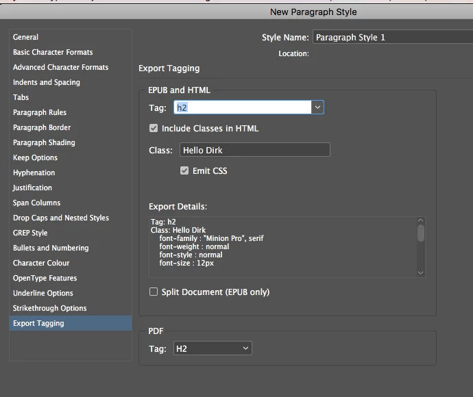

From the UI, see pic. I want to insert my own tags where you see H2.
I know these would normally be used for accesibility, but I have my own reason for overriding these.
Thanks.
P.

Hmm, the highlighted upper kEPUBTagEditBoxWidgetID is EPUB rather than PDF.
kSetStyleExportTagValueCmdBoss(0xCA2A)
IID_IWSTRINGDATA "EPUB"
IID_IEXPORTTAG "xx"
other interfaces matching their widgets.
As a kTextComboBoxWidgetBoss you can modify the text.
There is no separate command to produce some "xx" tag.
The values end up within IID_IEXPORTTAGVALUES of the kStyleBoss, but there is no notification on that change.
The lower kPDFTagEditBoxWidgetID uses the same command, but
IID_IWSTRINGDATA "PDF"
As kDropDownListWidgetBoss the user can't add other tags.
When I use kXMLCreateTagCmdBoss via Tags panel the new tag is still not offered, even though the tags panel is mentioned in the above article. Thus my question, can you add to that dropdown using the UI?
Speculation / did not try: Feels like not so much. I wonder if you address the widget and add a translatable string to the IID_ISTRINGLISTCONTROLDATA where the translation is your tag, what happens then? I would not suggest that though, because when you open the dialog without your plug-in such a value may confuse the dropdown setup.
If you need your own tag, how about going via XML structure, XML story along the article?
