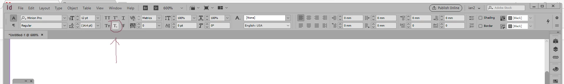

I use InDesign CS 6 to design a publication for a charity. I need to use subscripts from glyphs in one article & can only install numbers 1 to 3. Cannot install any more numbers beyond that. What am I doing wrong or rather what must I do to get this subscripts from number 4 onwards please. Thank you for your help.

select the numbers you want to subscript and click on icon I have marked

I don't think you are talking about subscripts here (which is the button Ian pointed out to you).
You don't tell us how you are "installing" your subscripts currently, but I am betting that you pick them out of the font using the Glyphs palette. A typical font does not contain digits as subscripts -- lower than the baseline, and used for chemical compounds such as H₂O and for enumerating variables, such as item₁. They usually contain a few default superscript numbers though: ¹, ², ³ ("for historical reasons", as these few characters appeared quite early in fonts).
With that possible terminology confusion out of the way: the button for superscripts is the one above "T₁" that says "T¹". Hovering above the button tells you what it does. The same functions are also available in the flyout menu of the Character panel.
