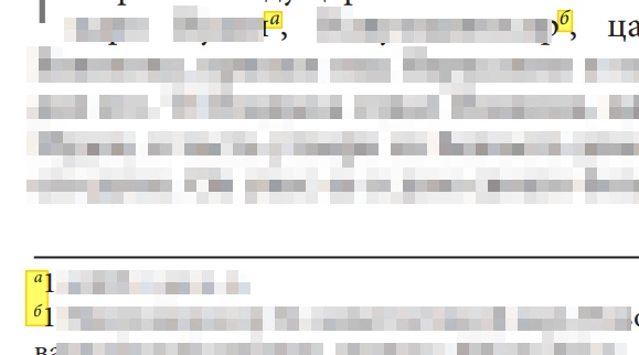

Thanks again Peter for all of your help.
I was able to get your original script working for customizing the footnote markers. It indeed allowed me to use a specified pool of characters/symbols as the footnote markers. Below is the script that ultimately worked for me.
I only made some simple modifications:
  • Grab the footnotes from all of the stories (instead of tables)
  • Commenting out the `inlineTable` function call.
  • I commented out the anonymous function wrapper, for aiding debug purposes. I'll likely uncomment those moving forward.

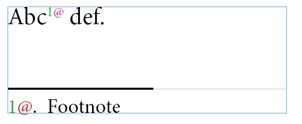

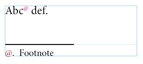

In that case the way to go is to add your own footnote reference and number symbols to InDesign's, and hide InDesign's symbols. Here's an example.
The real footnote references and numbers are standard InDesign, here, Arabic numbers, shown in green. You add your symbols, here shown in red:
To hide InDesign's references and numbers, set them in 0.1 points and set their horizontal scale to 1% (and maybe set the character colour to Paper), which hides them, but they are still present:
When the document changes the footnotes flow as expected because they are still real footnotes. When you add or delete any notes you'll have to update the fake numbers, but that's a fairly straightforward script.
