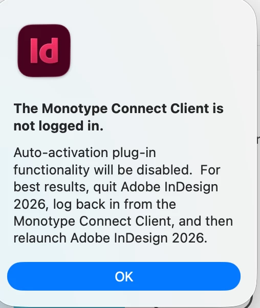

I no longer use the Monotype program. How do I delete the plug in from InDesign?

    there is no uninstaller. There is no script in the scripts panel. Yet the message that it is not plugged in appears whenever the program is opened.

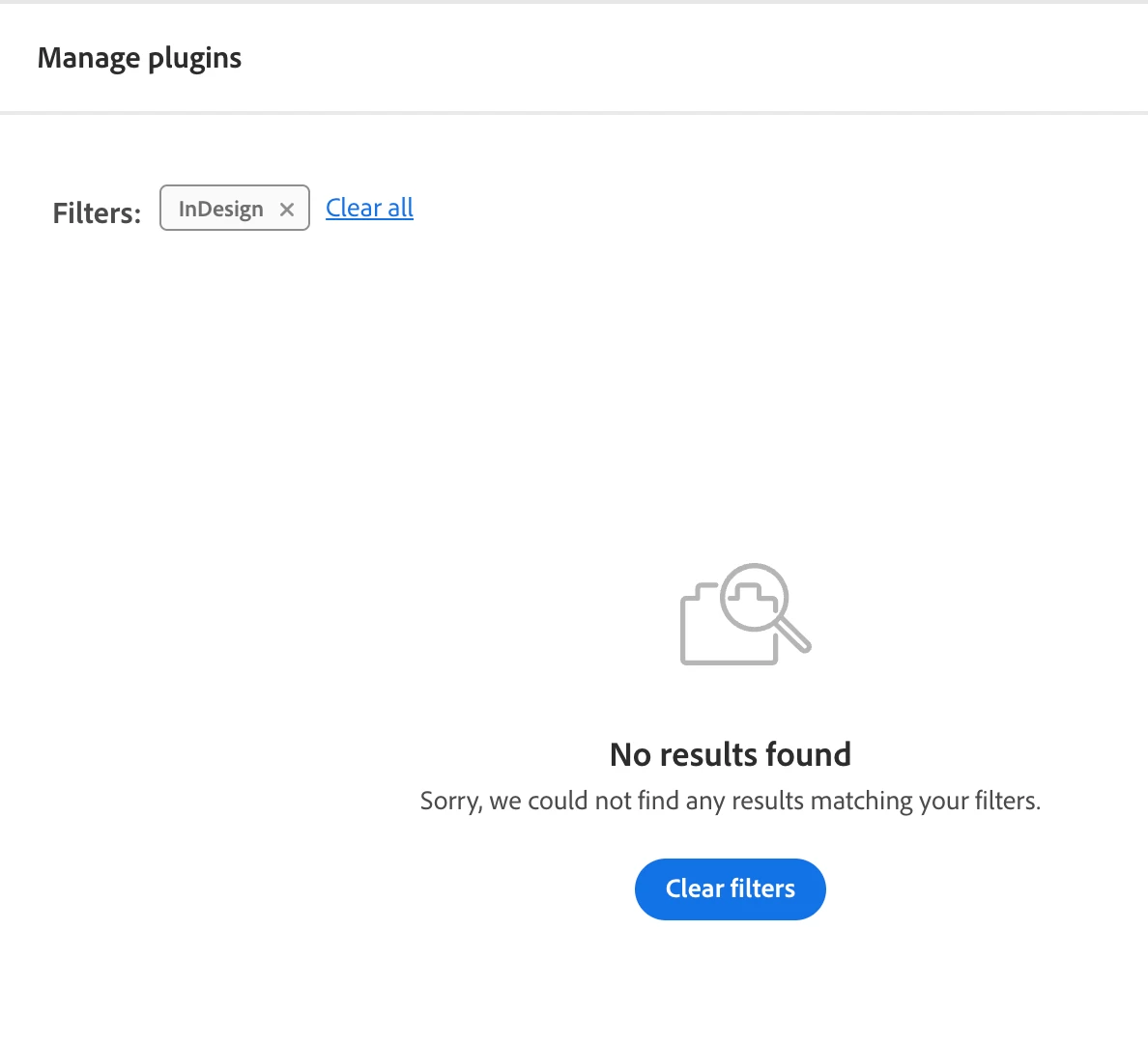

    Oct 15, 2026 7:27 AM UTC
    Not sure if I included this screen shot.

    Oct 15, 2026 5:05 AM UTC
    The plugins folder is empty. Yet when I open InDesign I get a message saying the plugin is not plugged in. I removed the Monotype program entirely some time ago. Where is the installation directory?
