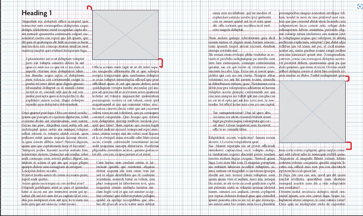

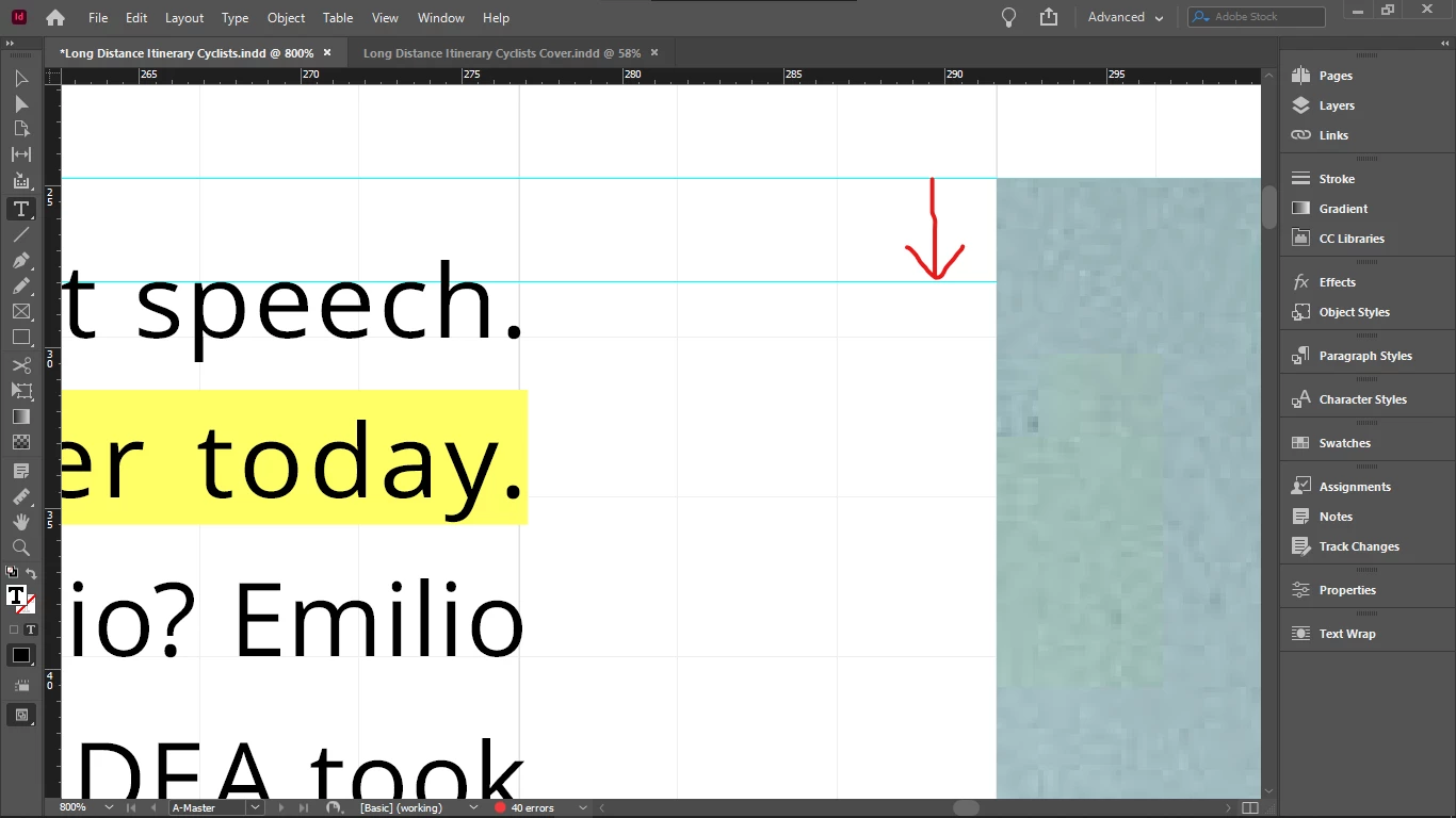

I want to size all my objects (text, images, everything) to exact document grid increments for the sake of easy drawing/resizing of objects on new pages.
So I activated snap to document grid.
I never need to display my baseline grid because I have set its height to my document grid cell height, so it's incorporated in my document grid.
The irritating thing is that everything works well with the document grid increments objects (bottoms, sides) except the upper boundary of images.
So I always have to crop the top of all images with text on the side down to the median line of the the text line on the top, to get them top-aligned, the cropping shown by the arrow:
So if I do crop them (and I have to, because the disalignment is visible), then all object boundaries are layign on the document grid, except the top of images that have text on the side - so this is quite disappointing.
Because the point is to not see any lines between document grid lines.
The disalignment is especially visible now when I doubled the size of my document grid blocks / and height of my baseline. I did that to be able to see always the real number of baseline grid blocks, no matter the zoom level - because I use them as units, when drawing/resizing my objects on the grid. When my grid block was twice as small, InDesign displayed 4 blocks as 1 block in Fit Spread In Window mode, and that is the mode I use for drawing / resizing / editing - except the top cropping of images I mentioned above.
Forcing my text into every second baseline (for this I must revert my document grid block / baseline grid height to half to get a reasonable leading - which I can't because I must see the real number of blocks at any zoom level) does not solve this issue either, because even if the baseline height is not that tall, the top disalignment betwen the text frame and image is still visible, and additionally, having text in every second baseline only, it causes the top offsets of elements under the text box to be taller, if the number of lines in the text box is even, because then the one at the bottom will be forced to stay empty, adding the impression of extra height to the top offset of the element below it.
Does anyone know such a fix for this issue, that would enable me to keep everything: my large baseline height / document grid cell dimension, not forcing text in every second baseline, and not needing to crop the top of images with text beside them after placing those images - that would create lines inside docuemnt grid cells, and that's what I wanted to avoid by drawing exactly on the document grid, so it wouldn't mess up my vertical math when calculating in my grid units (which I would like to use also as real units, for example when setting offsets, because remembering all the decimals and dimensions of say 3 document grid blocks is not practical).
Thanks.
Correct answer James Gifford—NitroPress
My text is forced into every second line.
And it's very unlikely that you will get other text to align using this setting. Here's the only real solution to your request that everything line up on a grid AND there be no gap above text when next to an illustration at the top of a page:
Probably not what you want, again. But if it's not clear by now, what you want is basically impossible. You can have your precise grid that everything snaps to regardless of layout variations, or you can have that top-text/illustration alignment, but (other than as in one of the last two examples I've posted, which are otherwise nonsensical) you can't have both.

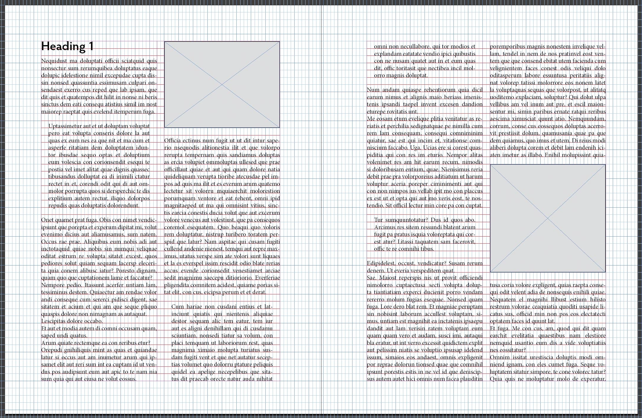

I am more than a little baffled at the depth of complexity and confusion in this thread.
This took me about ten minutes to set up from scratch:
...and as nearly as I can tell, it addresses every point the OP is concerned with. It uses three text styles, an object style, and adapts with perfect alignment to every adjustment made.
Chris  P.  Bacon
August 21, 2022
Top of text and top of image is not flush.
That was my issue, I needed to crop the text down.
How can you solve that without cropping off the top of the image?
The 2 offsets marked in each image are not the same dimensions.
Okay, you mean maybe they don't have to be? I know they can be equal if you don't draw your objects in exact document grid increments (some object boundaries would be lying in between document grid lines).

rob day
August 18, 2022

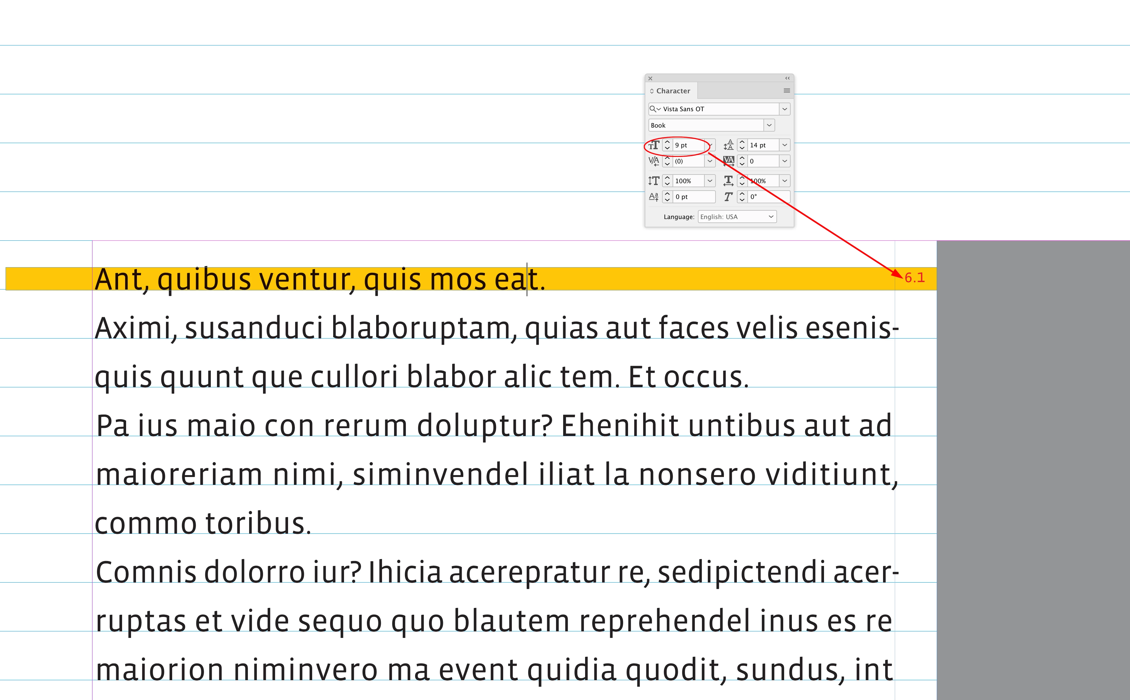

Hi @Chris P. Bacon
If you have your text aligned to a baseline grid, you can’t align an image frame to the baseline grid and expect it to line up with the text’s cap height.
Here I have 9/14 text aligning with a 14pt baseline grid—the font’s 9pt cap height is at 6.1pts above the baseline, and 7.9pts below the baseline above. I would have to move the image frame in order to get it to align with the text’s cap height.
Chris  P.  Bacon
August 18, 2022

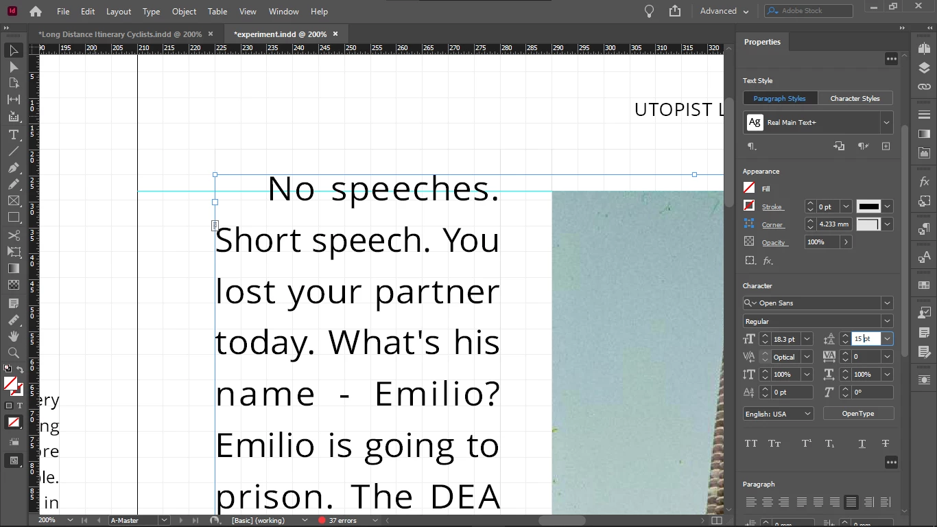

More precisely you have to crop the image (frame) because if you move it, it would cause additional disalignments. That is what I also said, I am just thinking how to automate these croppings so that the image frame doesn't change (to keep the offsets relative to the frames, and to avoid extra "lines" that are not exactly laying on the document grid).
What about forcing the text in every second baseline by setting the text size just a tiny bit taller than the leading, so that the median height would be approximately the same as the baseline height, and only using odd number of lines for columns so that the last and top line would never be empty? Could this technique eliminate this issue?
Chris  P.  Bacon
August 18, 2022
This is what I mean. Sorry setting the leading taller than the text size is what I meant, to forcing the text in every second line, and then increase the text size to (almost) match the baseline height.
Peter Kahrel
August 18, 2022
Set the first baseline offset of the text frames to Cap Height.

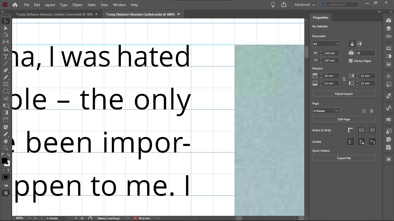

Chris  P.  Bacon
August 18, 2022
Making the text median height the same as the baseline height (just a tiny fraction bigger so it would force text in every second baseline) would actually eliminate the need of top cropping of images, and it would yield a slightly larger than usual, but acceptable leading, but there would still be 2 issues left:
- two small baseline height / document grid cell dimension, so I could not see the real number of blocks on the scale I am composing in
- extending the offset of elements below, if the number of lines in the column is even
