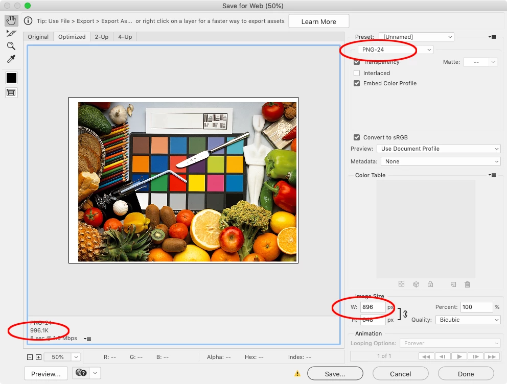

This image does not compress very well at all as a 24-bit PNG. It‘s just under 900pixels in width and its file size is 996k at 24-bit:

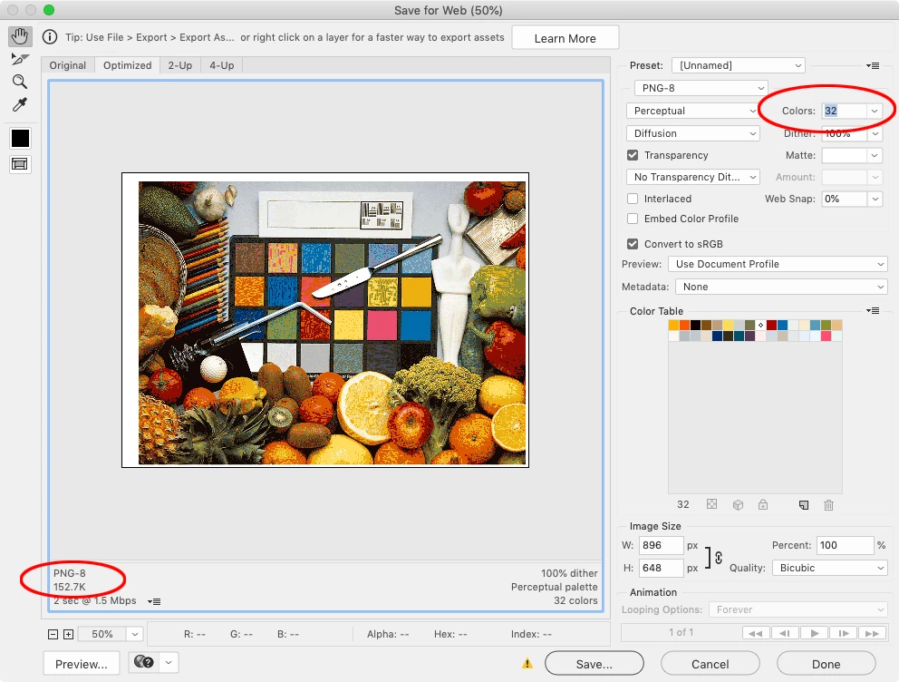

Saved as an 8-bit PNG with a 32 color palette I can reduce the file size to 152K, but the quality is very bad because the image needs more color variation:

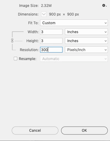

The relationship of the pixel dimensions to the outptut (Export image) dimensions are the same in PS and ID. If you want to export an InDesign page as 900 x 900 pixels at 300ppi, set the document up as 3 x 3 inches, same as you would in Photoshop:

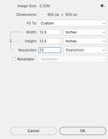

If you want the 900 x 900 pixel image to export at 72ppi set the ID page to 12.5 x 12.5:
