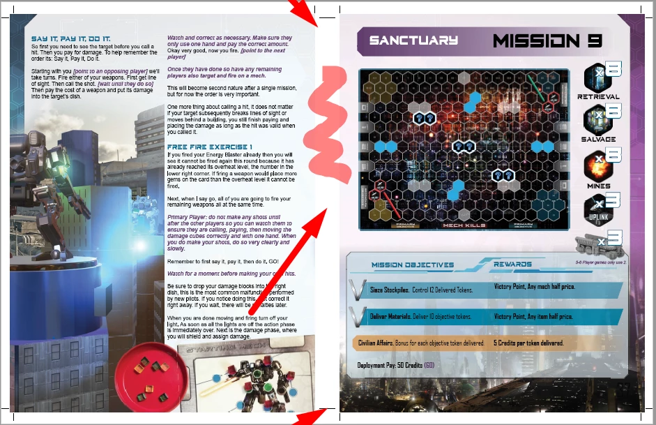

2. The issue with the latter comes when we convert these individual pages into a 2-Up Duplex printed saddle stitch booklet. So if there are white spaces and bleed marks surrounding the individual pages then we got white spaces and bleed mark in the center of the document.
Here is an example. See how the spine area is all messed up. AS you can see here we actually removed the inner bleeds to attempt to fix this but it still leaves other marks and white space etc... the two pages should be seamless in the center.
IF someone can tell me how to create a pdf from indesign with the bleed content but without the marks then I am pretty sure I can convert that into a booklet with the correct bleeds on the outside of the 11 x 17 spreads only.

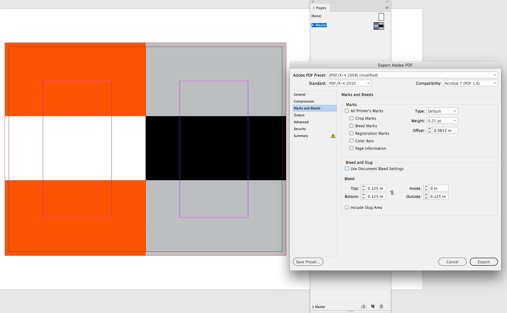

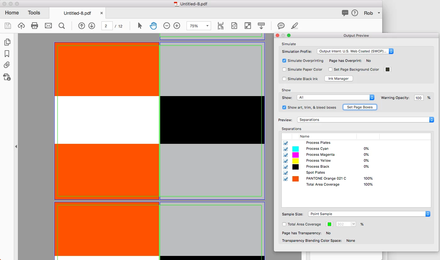

Uncheck all of the printer marks and include a Bleed with the Inside set to 0
In AcrobatPro with art. trim and bleed boxes showing, and the Page Display set as Two Page Scrolling

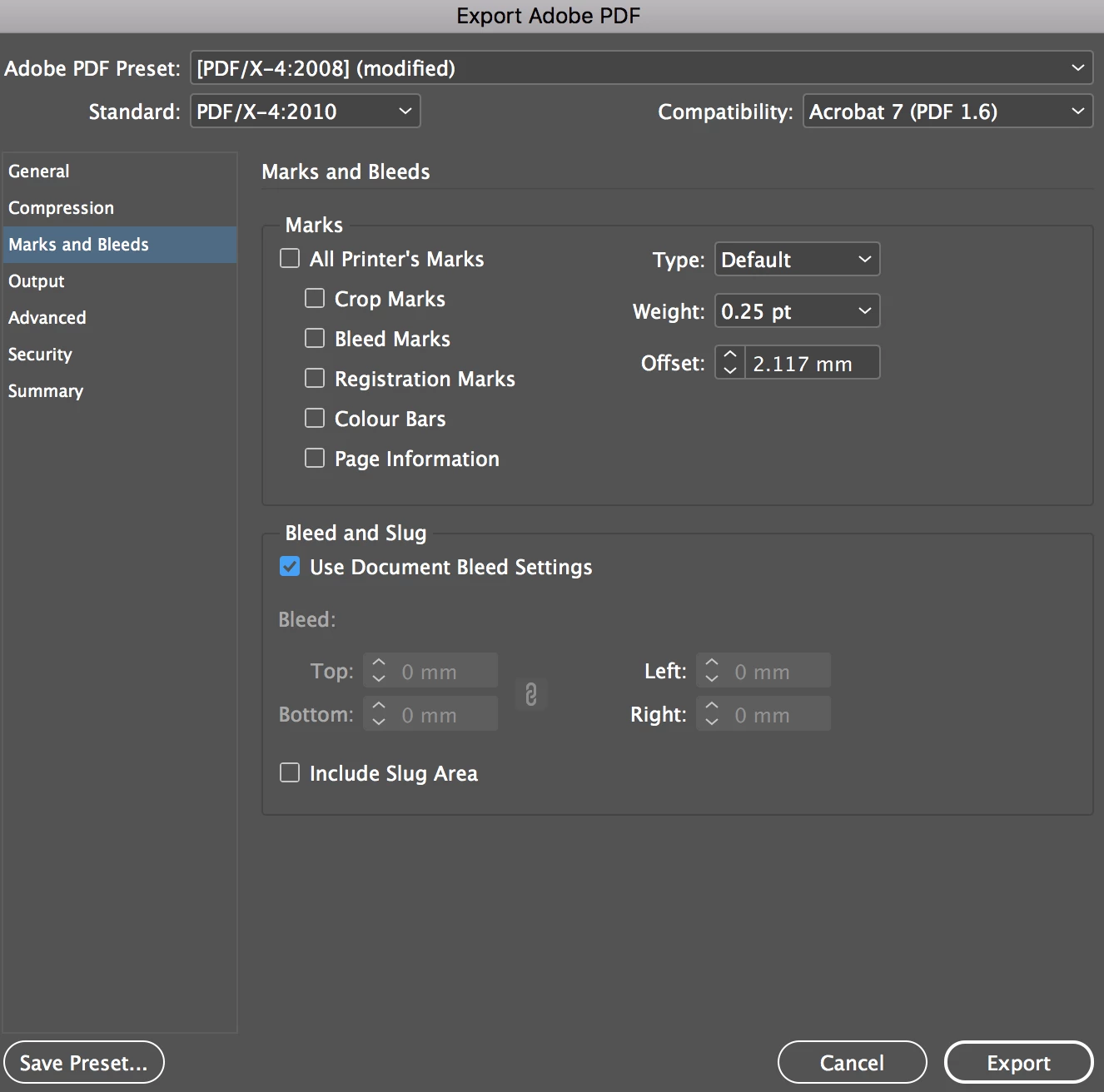

Thanks guys such a simple thing huh! Of course clicking no printer marks but clicking use document bleed settings worked perfectly. Thank you!

Tick Use Document Bleed Settings and leave Printers Marks unticked. (See screen shot)
Are you printing this document to your desktop printer or giving it to a commercial printer to print, if so leave it to the printer to do the imposition (and note, duplex booklet printing on normal desk-top printers may be unsatisfactory)
