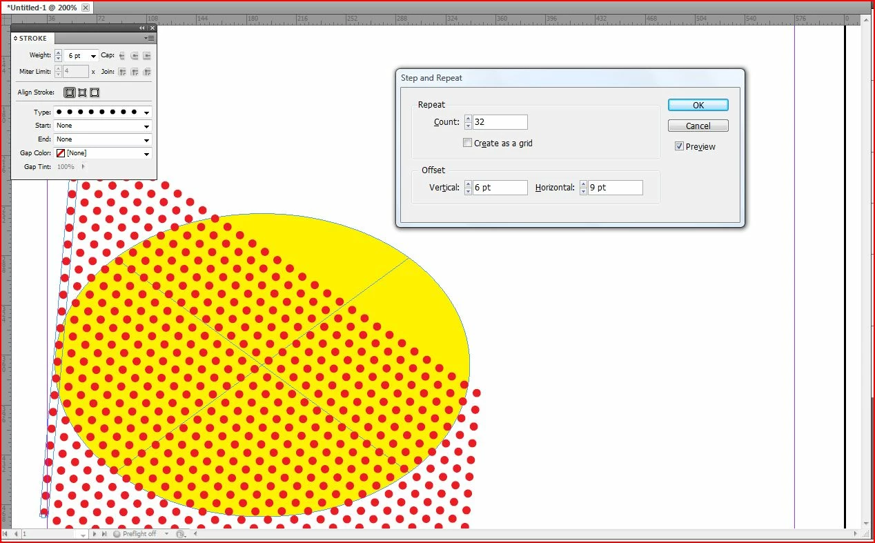

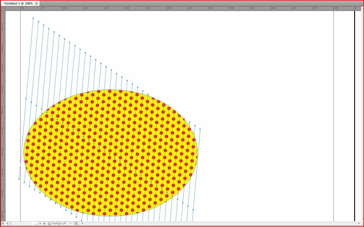

As Obi-wan noted, start with a shape
Finish with a grouped set of objects and use Paste Into. (Cut or copy the group, select the frame to fill, Paste Into)
I have used a stoke, set at an angle. I defined the stroke as dotted.
(A custom stoke could control the distance from dot to dot)
I work in values I can divide in my head. 6 pt stoke, step & repeat at 3 or 6 or 9 or 12 pts.

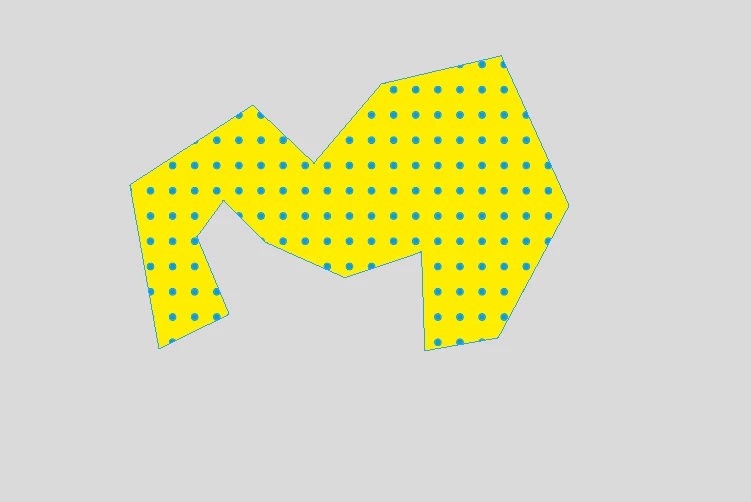

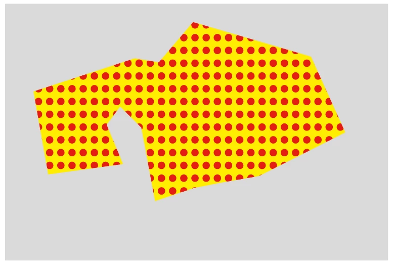

Salut Daniel,
In french, it's easier for me. I prefer create a basic pattern element (here, with a circle), apply an object style and duplicate it. That give me much more controls on the pattern: can be anything!
Obi-wan Kenobi
May 29, 2014
Samples:
Obi-wan Kenobi
May 29, 2014
HI,
ID can do a lot of things (but not coffee!).
If you begin with this:
… want to do that:
… have several actions on the pattern and the shape, directly with ID elements, e.g., as:
… you can do it easily.
