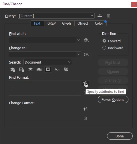

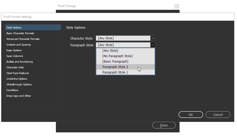

  1. In the Find/Change dialog, click the Specify Attributes button next to the Find Format field:
    That will open the Find Format dialog, where you can choose the paragraph style to find...

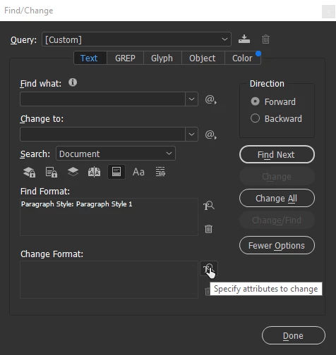

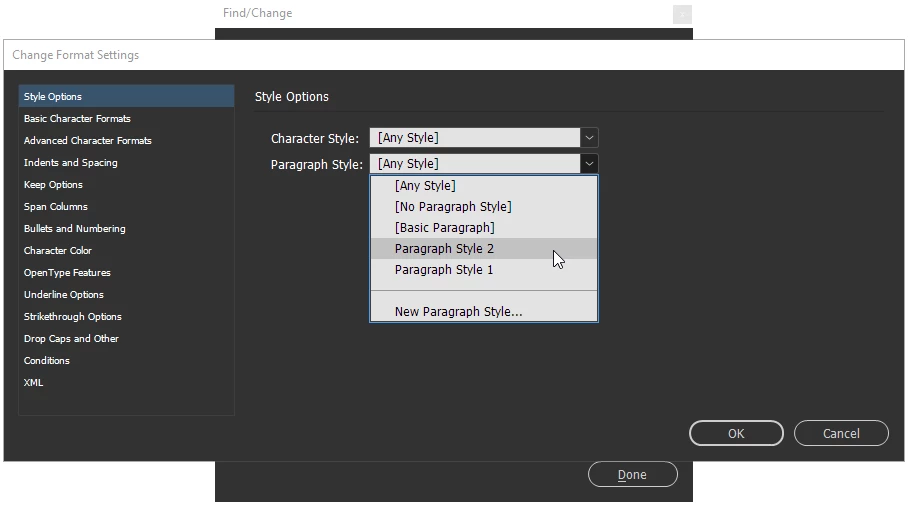

  2. Similarly, click the click the Specify Attributes button next to the Change Format field:
    ...and choose the paragraph style to serve as the replacement...

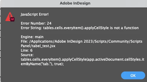

Dear Brianp311, thank you, but the problem seems to be that I didnt understand the original solution, I made a script with document.stories.everyItem().tables.everyItem().changeText(); but got an error:
So I think I made a mistake in the script... Thanks for your quick reply!
brian_p_dts
February 8, 2023
That looks like different code than the single line script:
app.activeDocument.stories.everyItem().tables.everyItem().changeText();
