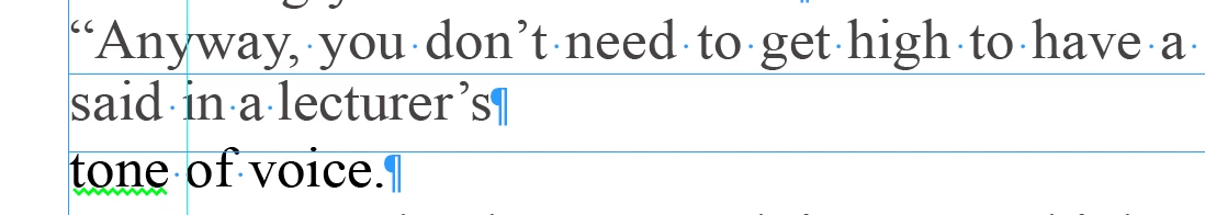

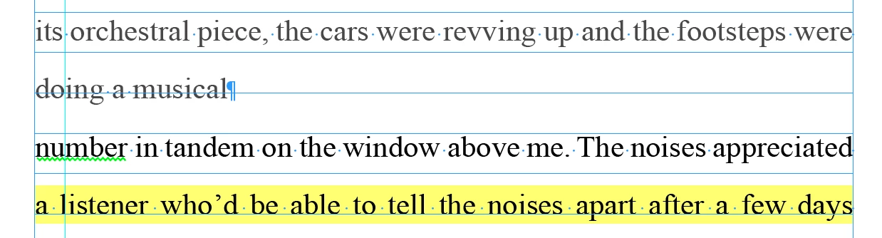

A client has given me a word document converted from epub to word, to be typeset in indesign. The word document is a complete mess and there are random carriage returns inbetween sentences. This is making the sentences break in the middle. Is there any quick fix for this using grep?
I'm able to find all the broken sentences using this find grep :  ^[a-z]. But to join them back I'm not sure what to put in the replace grep. So I'm having to manually delete the carriage return, add a space and join the sentence. Any help would be appreciated. Please find a picture attached.

Find:
(?<=\l)\r
Change:
type a spacebar space

May 15, 2025 1:13 PM UTC
Hi thank you..this works for the sentences when they're broken with upper case letters like proper names. so I'm using this to find those instances. Thank you so much!! Much much appreciated!

Hi i found the solution thank you! if anyone else needs it, this worked for me
Find: (\r)(?=(^[a-z]))
Change: Spacebar space
This chooses the carriage return before the break and changes that into a space!

May 15, 2025 12:38 PM UTC
^[a-z] this grep finds all sentences that start with a lowercase in the new para, so i know those are the broken sentences since this is a novel I'm working on. But only way to join it to the previous para seems to be to manually backspace the carriage return. Hope that clears my query a bit. Thanks!
