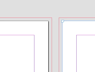

I'm designing my ID document with facing pages. Because it's going to be bound with Wire-O, I followed the good advice here and unchecked Facing Pages and moved the pages apart. The red boundary lines should show the bleed.

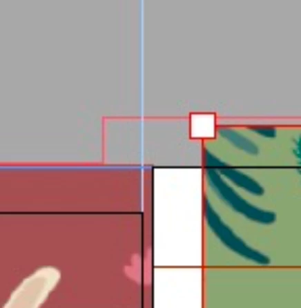

In most cases the system seems fine, but there are some pairs of pages that have uneven or overlapping red lines. Overlapping ones are shown in the screenshot. If they are overlapping, what should I do? Why are some uneven? Is this because ID thinks they are for a traditionally bound book and is making some kind of binding choice?

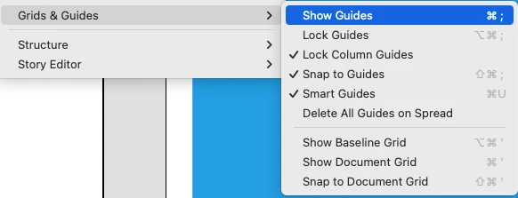

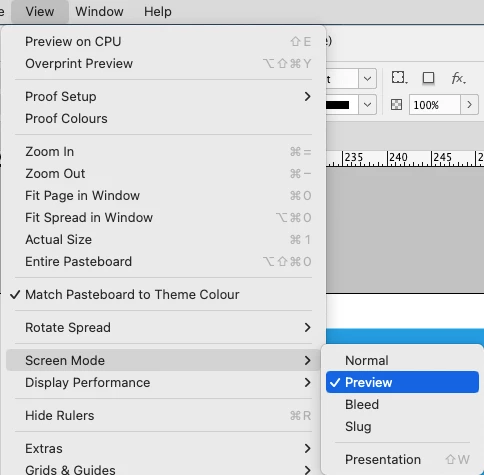

Are you maybe in Preview Mode?
or did you hide your guides? – also to find in the View Menu …
I saw those screen modes today, but the problem was solved after I deleted the cache. Thanks!

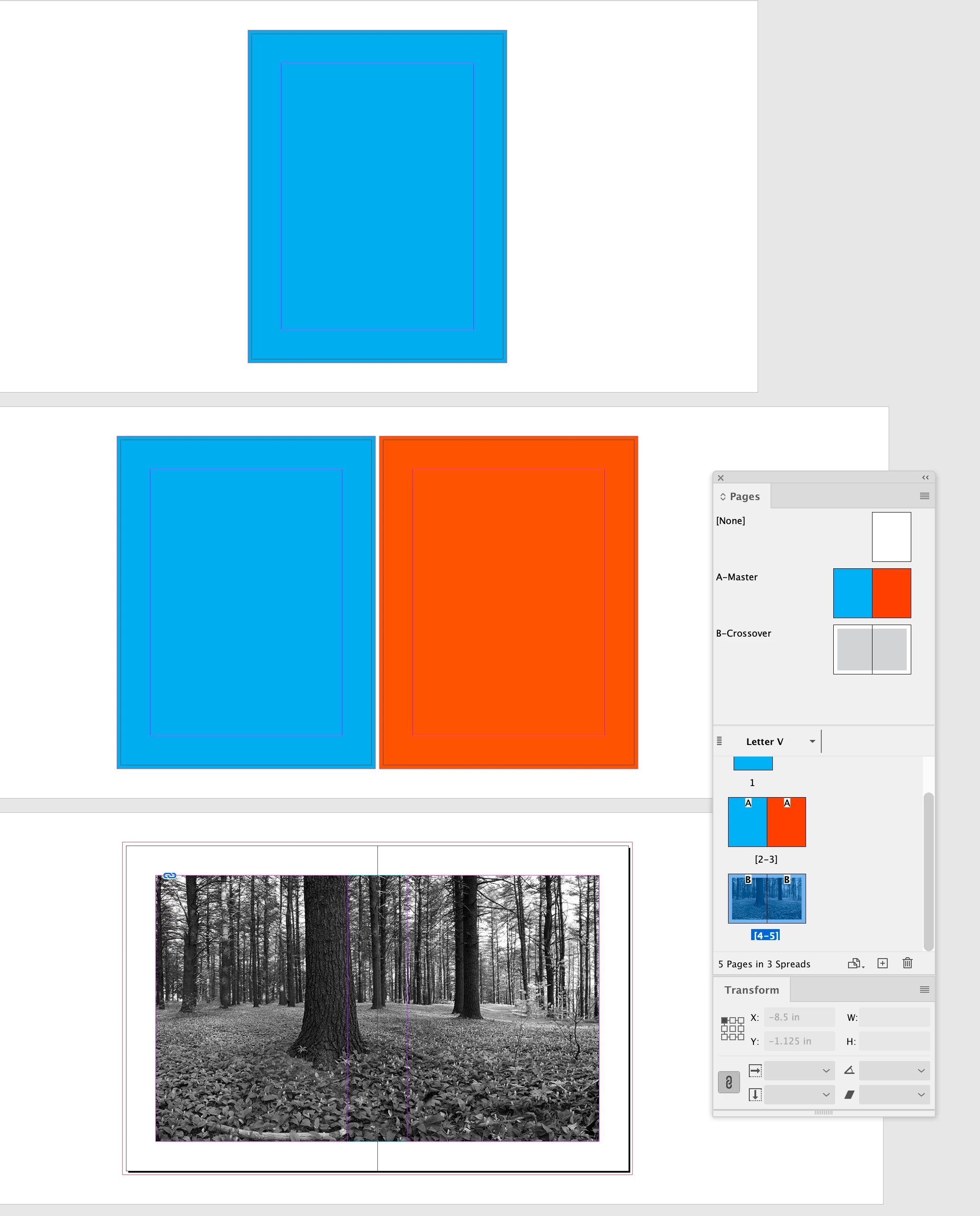

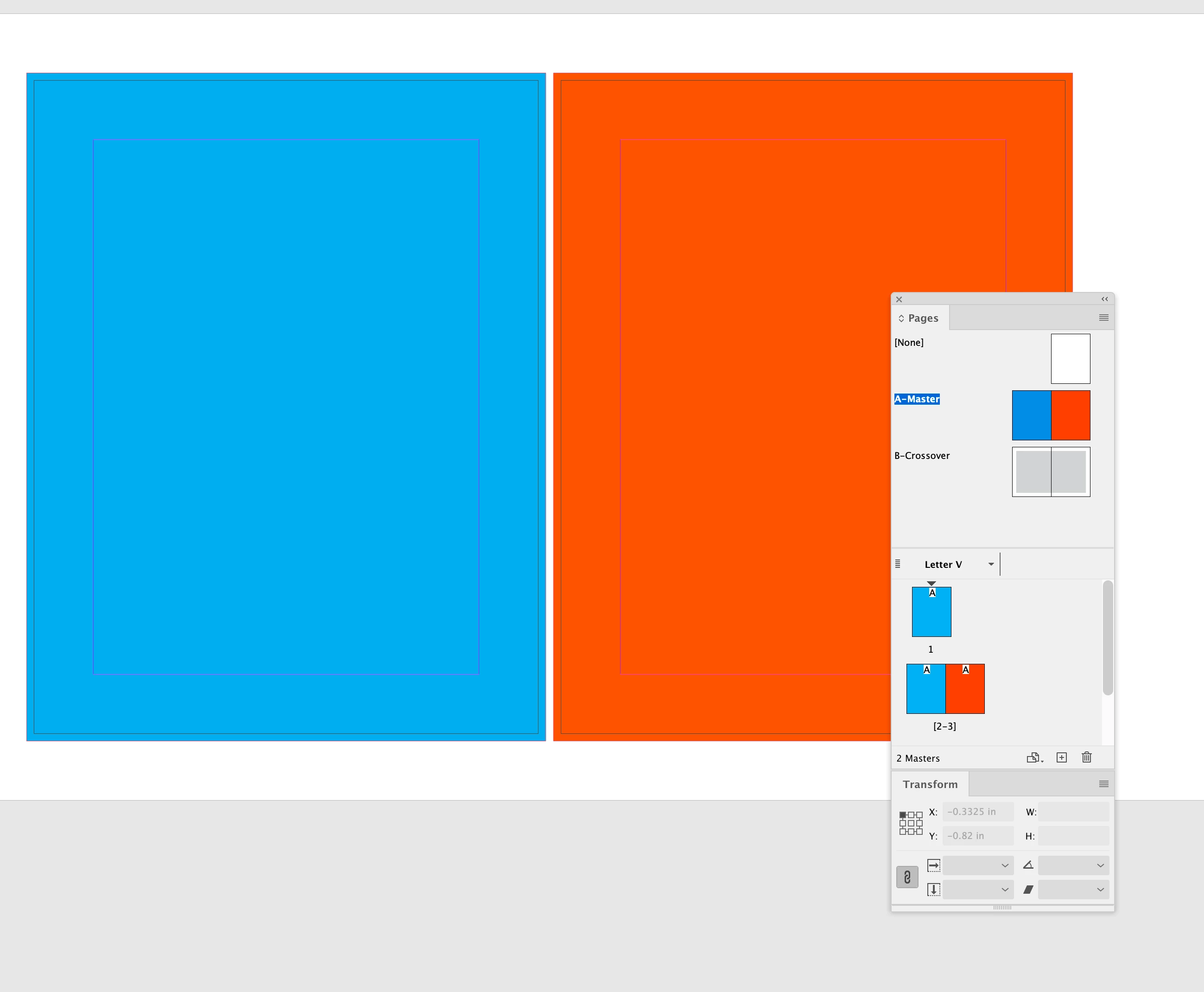

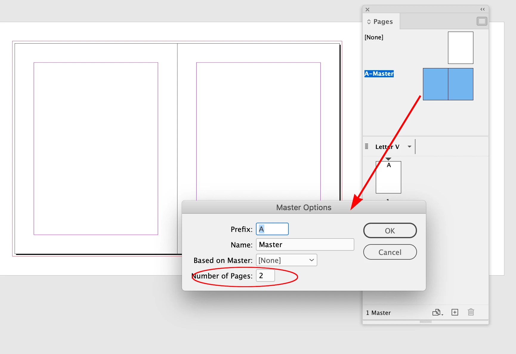

Hi @vixler , You can avoid misaligned spreads by setting up two page, parent page spreads
Then use the Transform panel to move the righthand page of the spread.
Here I have the right page selected with the Pages tool, and with the Transform panel’s anchor position set to upperleft, I’m adding 3/8" to the X value, which puts 1/8" space between my 1/8" bleeds:
Also, if your page items crossover the spread, you don’t need the split pages because the bleed will be picked up from the opposite page, which is what you want in that case. So here I’ve made a crossover parent with no gap:

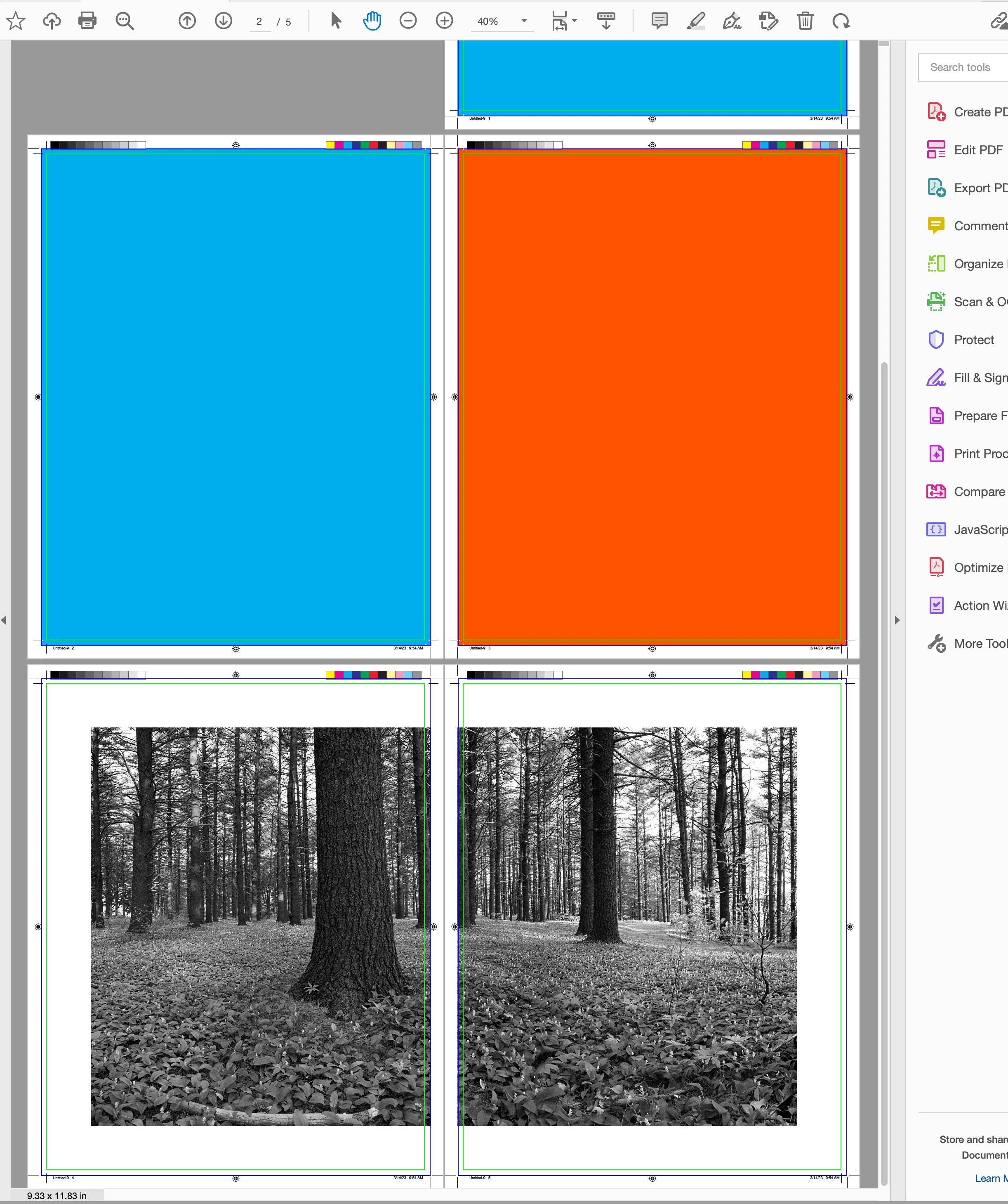

An Export to PDF/X-4 with printer marks and document bleeds:

Rene Andritsch
March 16, 2023

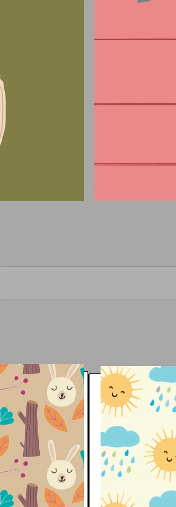

"Another question and I don't think I need a screenshot, is that sometimes there is white behind the pages, as shown here but in other cases there isn't--is that something I need to worry abnout?"
Hi @vixler ,
yes, that is something to worry about.
Could be that the document is corrupt. Every page should show "white" behind its area when no object is on the page.
( Unless the standard swatch [Paper] is not defined with 0,0,0,0 for CMYK or 255, 255, 255 for RGB; something you should never change! )

@vixler please show us a screenshot of an instance where the background is not white.
vixlerAuthor
March 15, 2023
Here it is attached. This kind of things happens several times in the document, not at a regular interval.
Rene Andritsch
March 14, 2023
Your screenshot shows that the bleed from both pages is overlapping because the pages are to close together. Select the Page Tool and then the right page. In the Control Panel click into the x-value and enter a higher value as you currently have. This should solve it.
The white background is the blank page. Make sure that your frame in which your illustrations are places reach to the red bleed lines all around if the the color should be printed to the edge of the page.

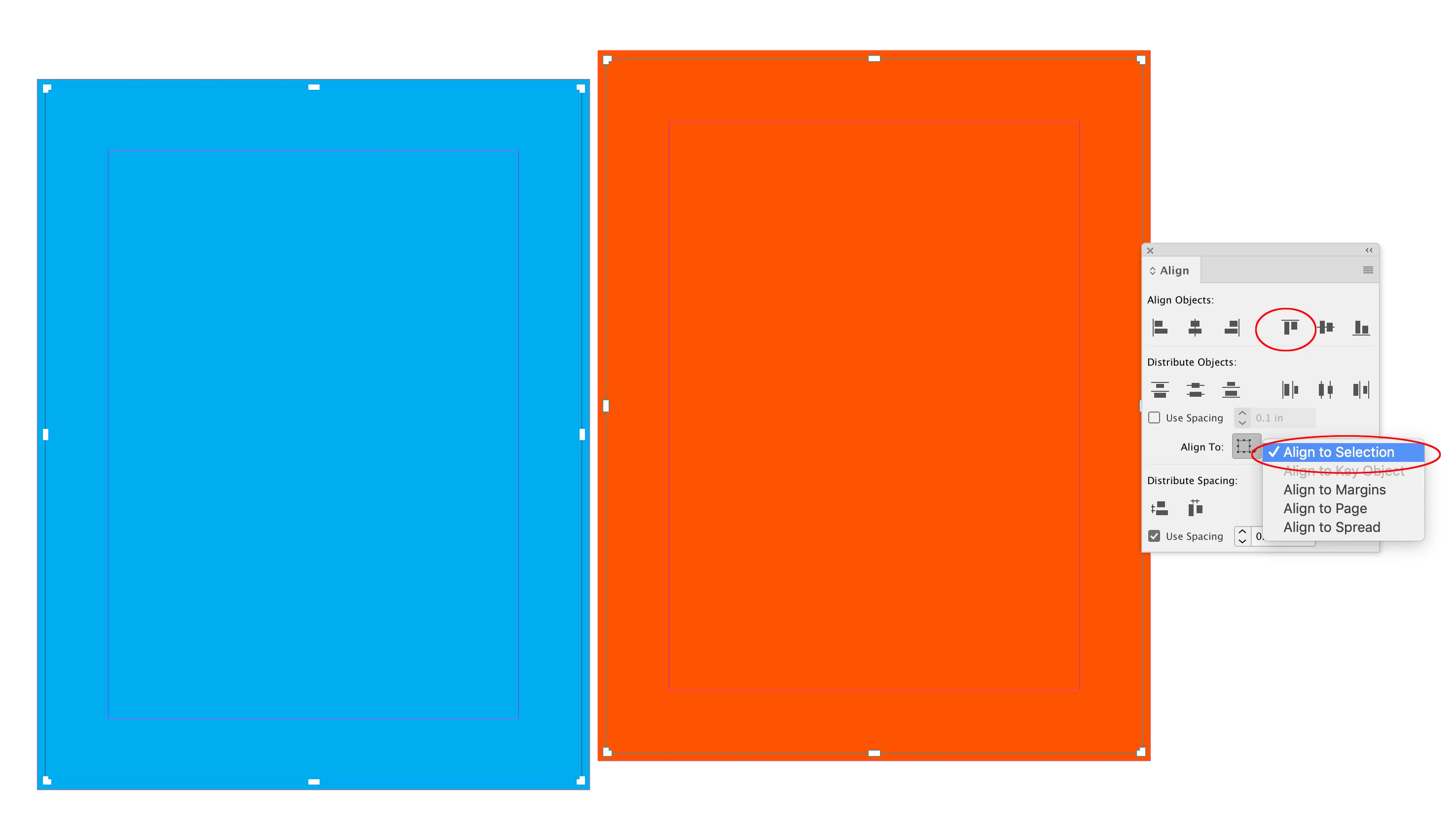

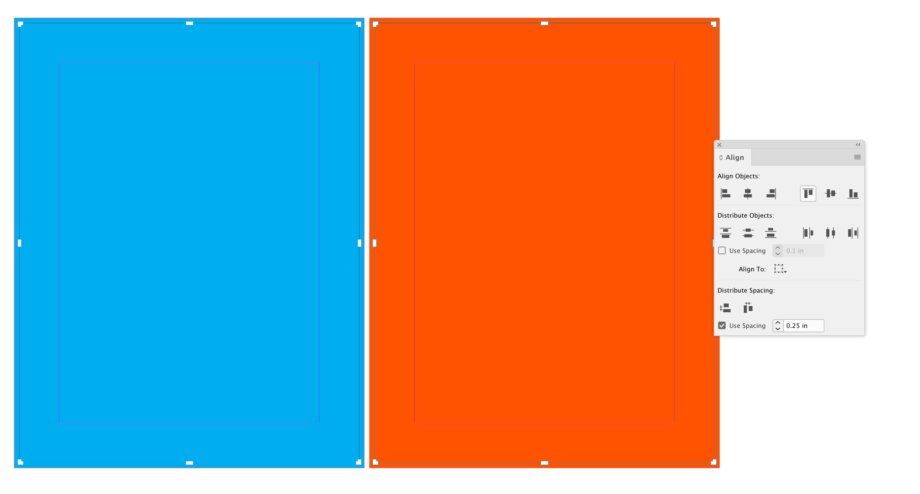

Also you can use the Align panel to align pages. Select the spread pages with the Pages tool:
