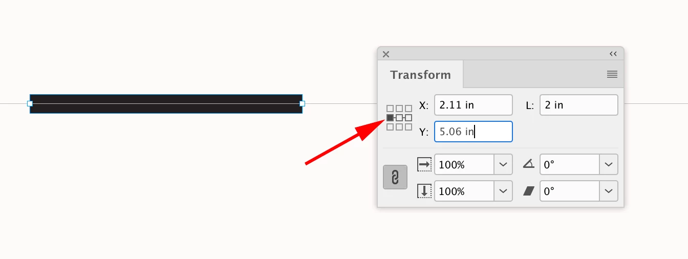

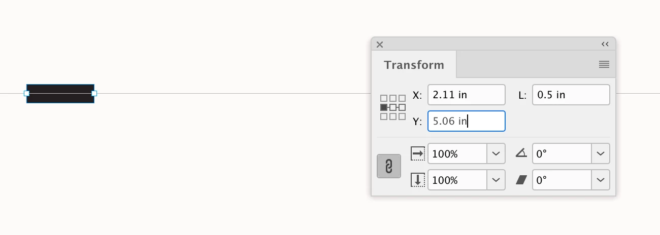

Hi @Lucy28695073yi3k , How are you changing the length of the line? Does it happen if you use the Transform panel to change the length with the Reference Point set to Left Center?
An X position move:
Sep 17, 2024 3:06 PM UTC
Hi Rob,
I usually select and drag the endpoint to change the length, but I just tried using the transform panel, and the issue still persists. You can see that the Y-value changed when the length changed.

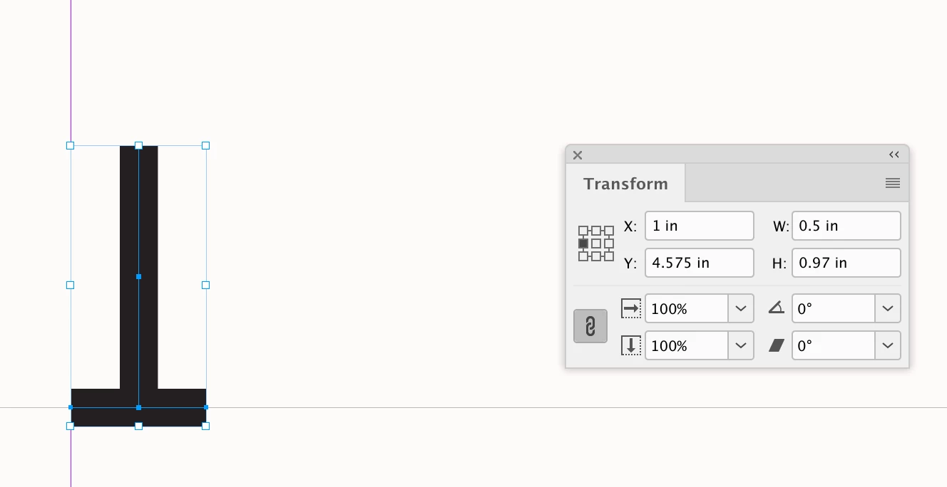

And here's what happens when I try to do an X-position move on the line with the endcap.
It didn't change the Y value this time, but it was oddly off by .0625...
And if I have the reference point set to bottom middle and change the Y-value, it correctly changed the Y value, but you can see that it somehow changed the X-value as well.
Lots of odd things happening...
