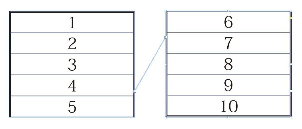

How to get cells in a selected text frame
Hi, I have an ExtendScript question.
When there are connected text frames and one table object straddles both sides, I want to get the cells in the selected text frame.
In your screenshot, you want to get cells 6-10.
What is a good way to do this.
Thanks.

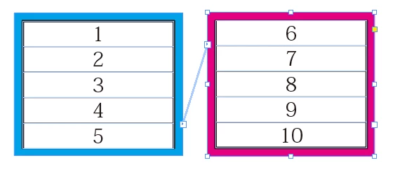

One idea.
It will take processing time.
If all cells are looped through, the stored text frames can be obtained. Determine if the text frame is selected.
I wonder if there is an approach that uses the text frame as the starting point.

Hi @ajabon grinsmith ,
the short answer is no. You can determine the first frame of the parentTextFrames array.
And that's it. Just like you did this.
The more interesting question would be:
How would you get the text frame if some or all cells in that table are graphic cells?
One idea:
Insert unique labels to every cell of the table.
Use cell.insertLabel( keystring , valuestring ) for this.
Duplicate the text frame you selected.
Then you can determine which cells are in by looking at all cells of the table of that duplicated frame.
Use cell.extractLabel( keystring ) and see what value string is returned.
Keep in mind that tables can come along with header and footer rows.
