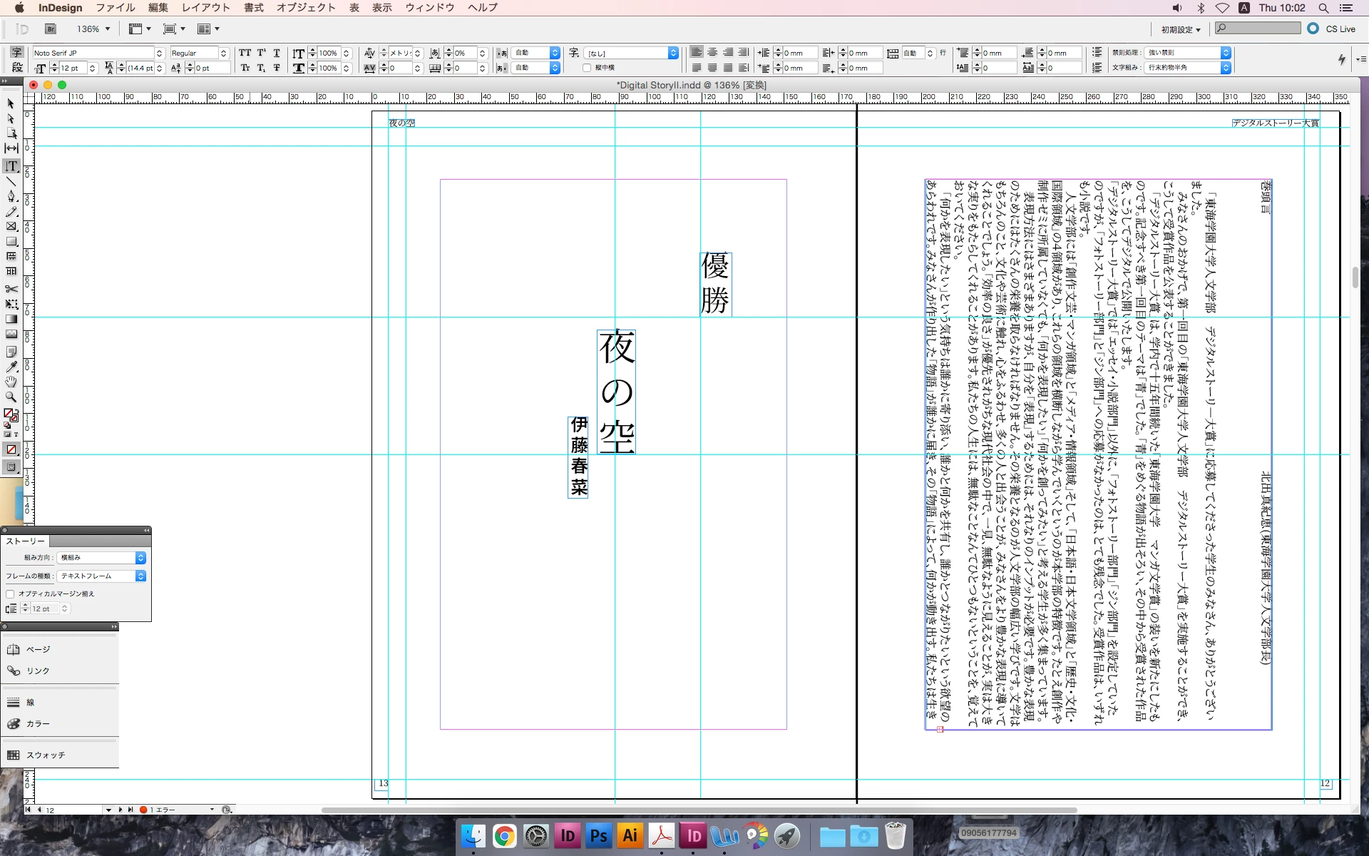

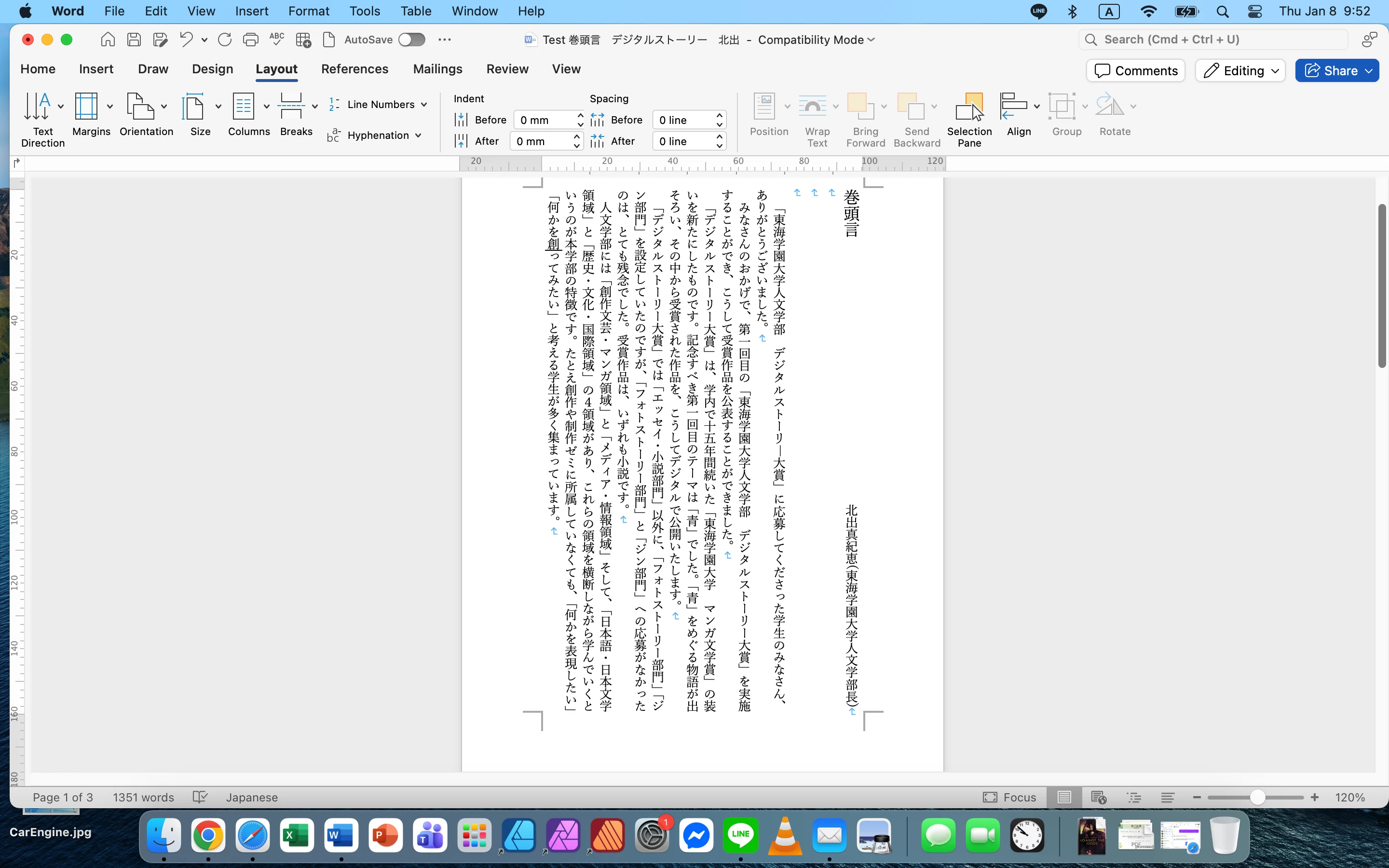

I am trying to import Japanese text, vertical from right to left, into InDesign CS5J so I can edit the text.
The text is in Word written vertically and from right to left.
However, when imported it into InDesign CS5 it changes to horizontal.
The format (書式) is set to vertical composition (縦組み) and the text tool is set to vertical (縦組み文字ツール).
I know CS5J is old, but it is what I have and has worked fine until this.

Stripping formatting by roundtripping through raw text is a good idea. How did you do it? I see you're on a Mac; TextEdit's default format is usually .rtf so it might well be retaining styling information, if copy/pasting into TextEdit was your method. (It has been a few years since I used a Mac regularly, but I recall a "Make Plain Text" menu entry in TextEdit.)
Did you try placing the Word document but stripping out Word styles? There's an option to do so if you check the Import Options box in the Place file select dialog.
What happens if you just start a new vertical text frame in a new document and start keying in Japanese?

Jan 10, 2026 1:36 PM UTC
I thought it was a good idea as well, but it didn't work.
There was no "Make Plain Text" option that I could find but there was a "Make RIch Text" option which I tried.  And didn't work.
Never thought about the stripping out Word styles option.  Tried that and guess what?
It actually worked. Thank you very much for your help.

Forgot to mention that when I started a new vertical text frame in a new document and started keying in Japanese everything worked as expected.

The screenshots are what I see in Word and CS5J.
