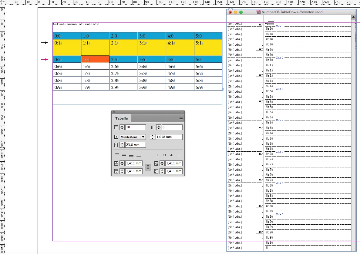

1. Copy a range R of rows from table A
2. Paste the range to a new text frame => that will become table B
3. Add a column at the right edge of table B
4. Merge the cells in table B columnwise, but not the new added column
5. Select and copy the merged cells of table B only
6. Select the first cell in R of table A
7. Paste the copied cells
Now table A has rows where the length of cells is zero.
Here a screenshot from a sample where I set the contents of each cell to its name:
The Table panel is showing 10 rows and is obviously following: table.rows.length
The Story Editor panel is showing 7 rows. That's the ones with cells that can be edited.
If you run a snippet like that on the table where I loop through all the rows of the table:
// Select textFrame and run this script:
var rows = app.selection[0].tables[0].rows.everyItem().getElements();
var rowsLength = rows.length;
for(var n=0;n<rowsLength;n++)
    $.writeln("row"+"\t"+n+"\t"+"cells.length:"+"\t"+rows.cells.length);
The result of cells.length is that:
row    0    cells.length:    6
row    1    cells.length:    6
row    2    cells.length:    0
row    3    cells.length:    0
row    4    cells.length:    0
row    5    cells.length:    6
row    6    cells.length:    6
row    7    cells.length:    6
row    8    cells.length:    6
row    9    cells.length:    6
