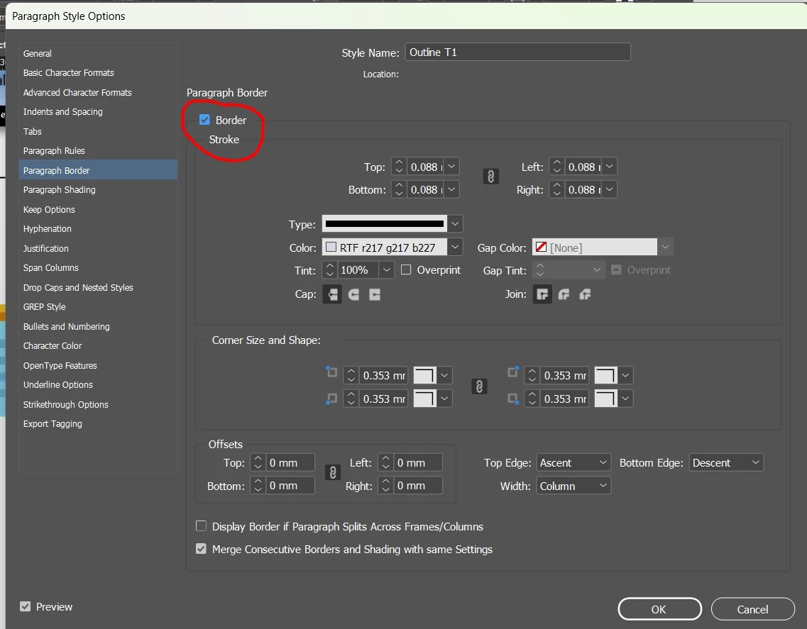

February 22, 2024
The same problem is encountered, but even after doing so [i.e., the solutions given here] the stroke remains. therefore, after several attempts, I found this solution:
- go to the Paragraph Style [where the stroke around your text has visibility, like a table fine linner], Edit-> Paragraph Border -> deselect Border -> OK
Simple...for me now! Good luck!
