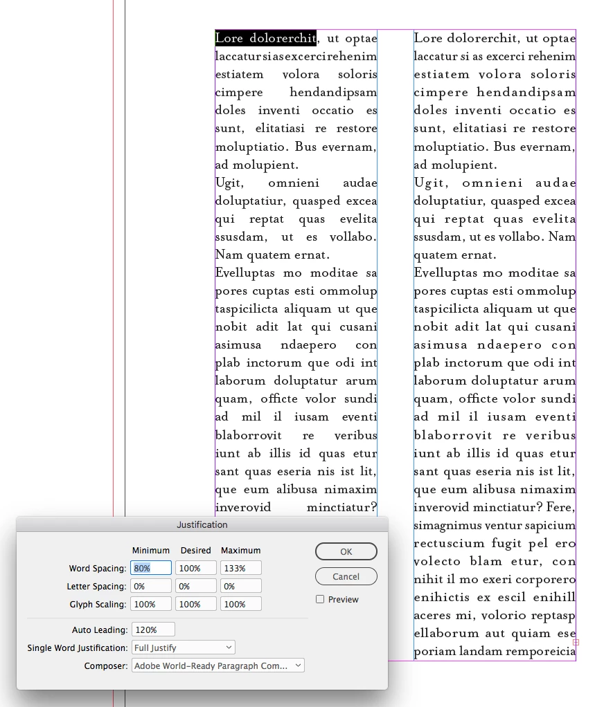

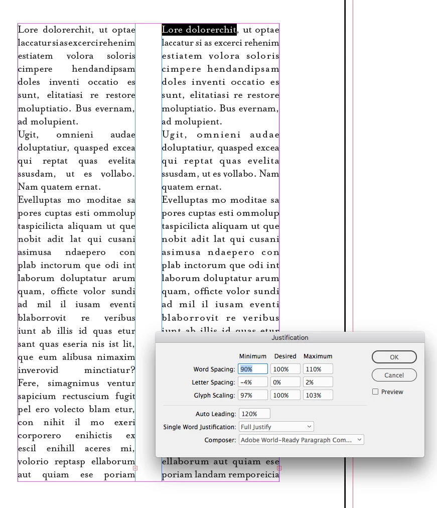

The typeface would have an affect, as well as the point size—in the end it’s the average number of characters per line that will determine whether there will be problems with justification. You certainly can improve how text will justify by changing the defaults.
With a very tight measure—4-6 words per line— you can see the problem with default Justification and no hyphenation on the left vs. a custom Justification on the right:
A 4" column with 12/14 text and no hyphenation:

In my experience, I had similiar tasks, I got the best results if I did some adjustments in the Justification section of the Paragraph Styles. Depending on the selected font and the selected lenght of the lines and paragraphs (the longer the better) I did not only allow the spaces between words, but also between the glyphs to have a range. In the last caste I allowed the space between the glyphs -4% 0% 5%.

Yep! Especially that Letter Spacing Minimum value of -4 or even -5 seems to do half of the trick. While pumping up the Maximum does not, for me.
