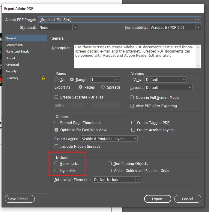

First, a confirmation that links don't work reliably in all export modes, although it seems more accurate to say that they don't work in "Smallest File" mode than anything else. They work (for me) in High Quality Print and Press Quality, for, me if the Hyperlnks box is checked, and in the interactive PDF export as well. So it's that one mode, which is clearly omitting something in the name of file size — but I don't recall links not working in prior versions, either. Acrobat has been put through the AI wringer so thoroughly it's not surprising to find that obvious, basic features are no longer what they once were.

If you still want to have interactive funtionality in PRINTed PDF - you need to check manually:
Nov 6, 2024 8:05 PM UTC
I mean, you would think, right? But it doesn't hyperlink the endnote references. Should but doesn't.
I actually went through and confirmed that the ONLY PDF setting that works to create links in endnotes or footnotes is the "High Quality Print." Makes no sense; must just be a longstanding oversight.
