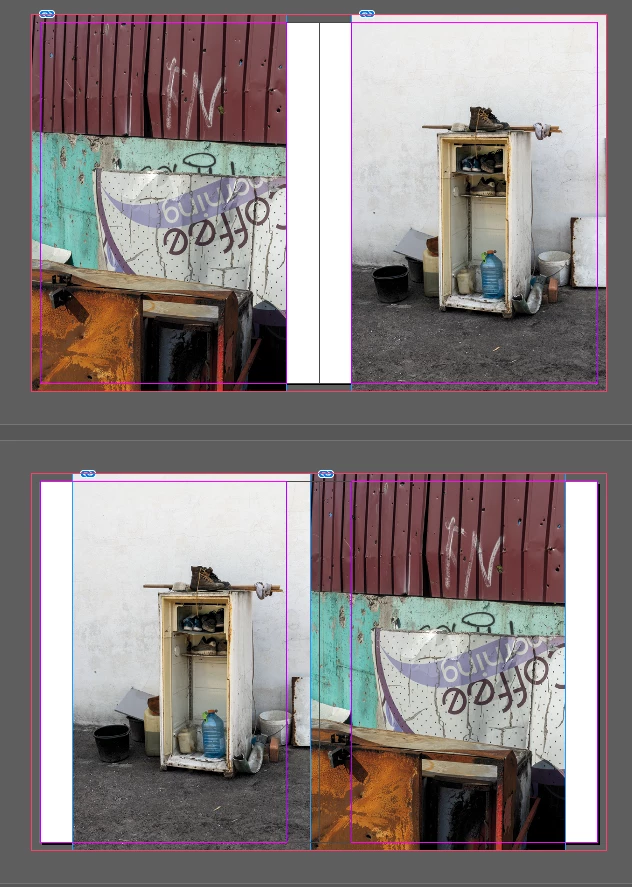

I’m trying to do something in inDesign which I believe to be relatively basic, but a solution is eluding me. I frequently use the software to lay out books of images, using documents with facing pages. This often entails having just one image on each page. The images are not centered on the page because of the space lost to the gutter when the books are bound. Images typically have a smaller outside border than inside border.
If all the images are the same size, I will lay out a spread with a frame of that size on the left page and another frame of the same size on the right page. Let’s just say in a sample document the frame on the right page is drawn 1” from the outer (right) edge of the right page and 2” from the gutter. On the left page, the frame is drawn 1” from the outer (left) edge of the left page and 2” from the gutter.
Once those frames are positioned, I will duplicate the spreads until I have about 100 pages in the document and then start placing images in the frames on the pages. Once I have all the images in the document, I may decide to re-sequence or remove some of the pages by moving them in the page panel. However, this causes the page layouts shift. If a page that was layed out to be on the right of a spread is moved to the left side of the spread, the image on it will have a 2” outer border and a 1” border to the gutter.
I want to be able to move pages in the pages panel back and forth from right (odd) to left (even) pages and have the frame automatically shift so that it’s position relative to the outer edge of that page will be the same whether it is an odd or even page.
I can get this to work if, and only if, the frame matches the size and position of the page margins. That’s an ok solution for some situations, but it doesn’t work for full bleed images since the page margins cannot be set to the bleed marks (beyond the page dimensions). It is also a hassle for documents where the images have many different sizes because it requires setting the page margins manually for each page.
The attachment illustrates how the inside border gets pushed to the outside when I switch the order of pages with full bleed images on a spread. These image frames do not (cannot) match the page margins.

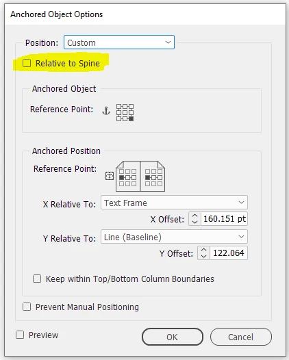

You can position anchored frames relative to the spine, which I think is what you're after. But whether that's feasible in your workflow I'm not sure.
February 18, 2024
Thanks for the tip. After messing with it a bit, I can get that to work if I place an empty text frame over the entire page and then insert an anchored image frame inside that text frame. This method seems a little clunky to me since it entails using empty text frames on every page, but my limited understanding of anchored objects is that they have to be anchored to text frames. If there is a more elegant solution than my kludge, I'd welcome it, but for now this works. Thank you!
