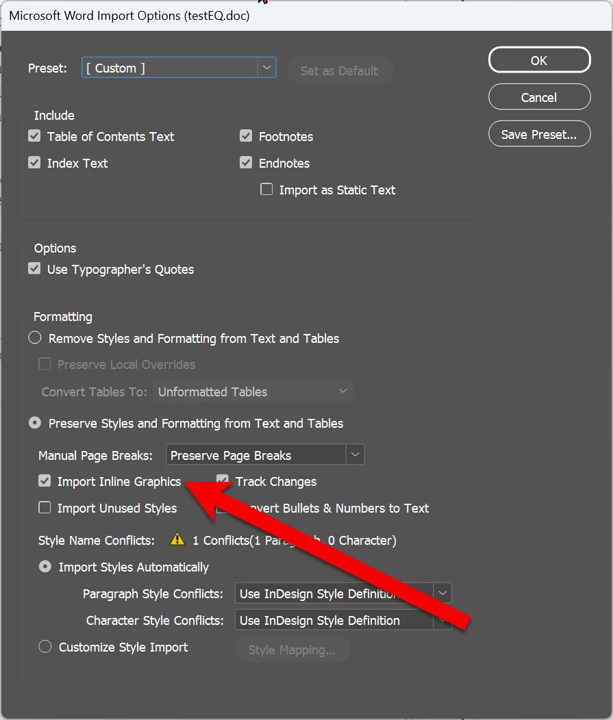

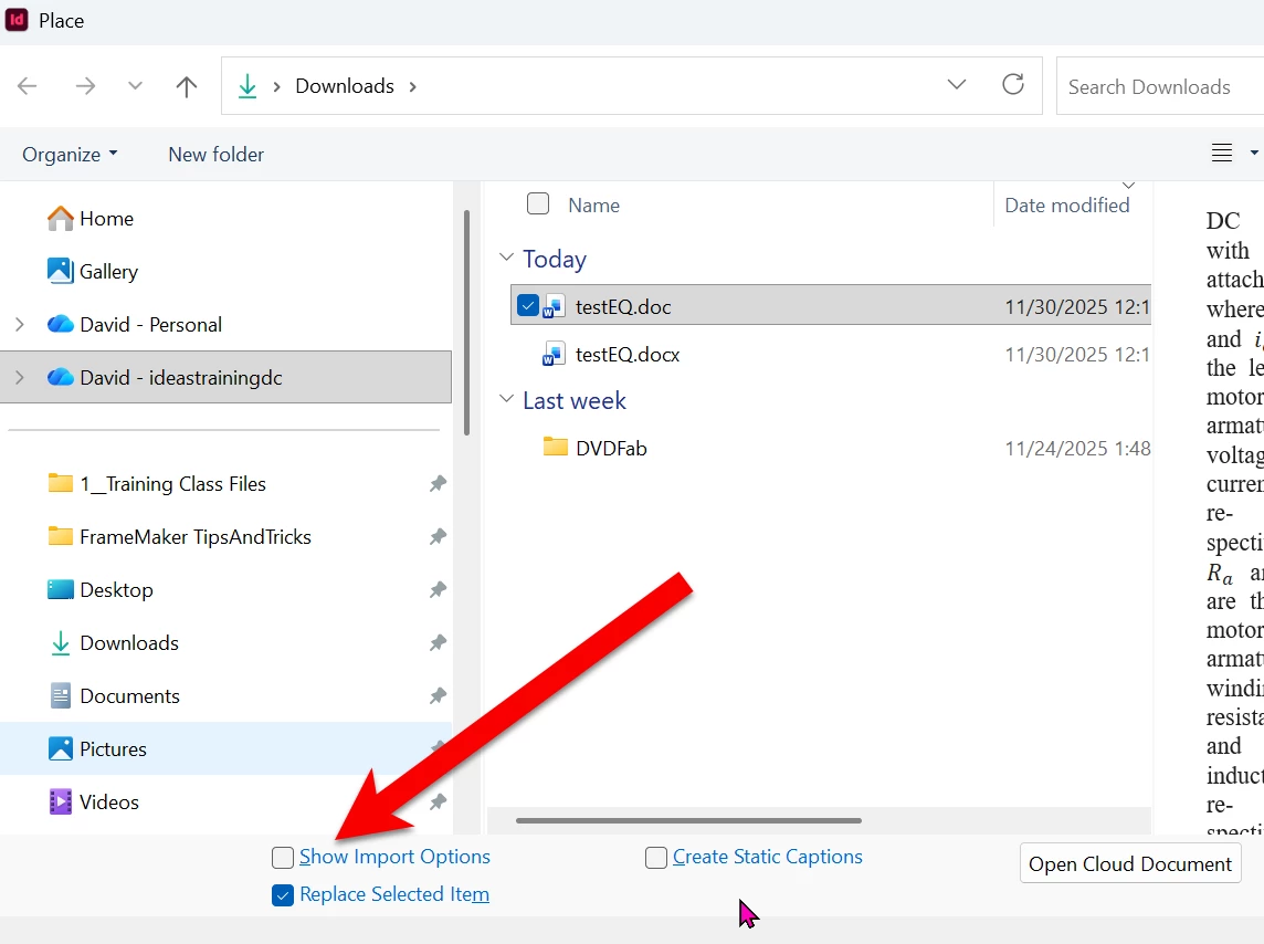

  1. Save your Word docx as a 97-2003 version. This will convert all the equations to images.
  2. Place in InDesign with Show Import Options selected.
  3. Select Preserve Styles and Formatting and make sure Import Inline Graphics is checked.
If the quality is not good enough, make the equations larger before doing step 1.
