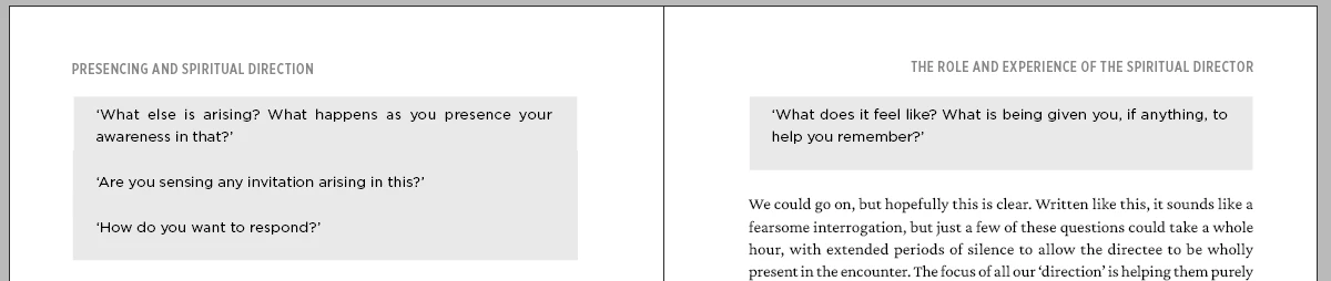

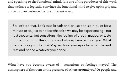

I'm using Paragraph Shading to create text boxes in a text frame, by intending the text left and right, and using a top and bottom offset of 1 x leading, and Space After/Before = 2 x leading.

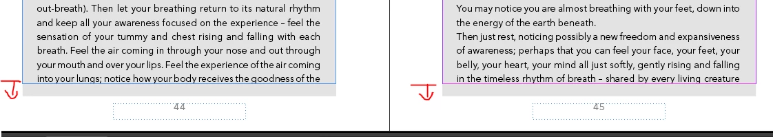

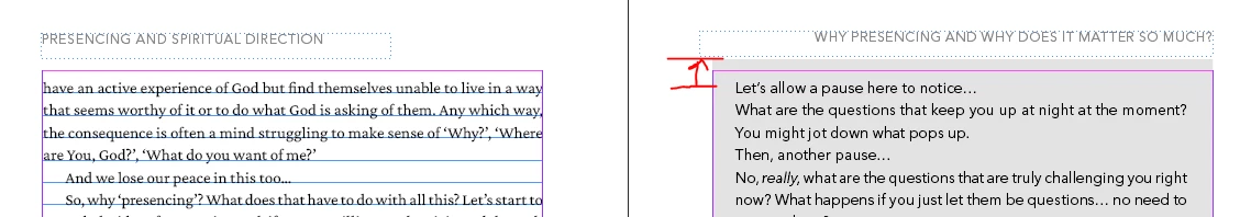

This works fine when the text box is contained entirely within a single text frame. But if the paragraph text occupies the first and/or last line in the text frame e.g. when it flows across multiple text frames, we have a problem.
The only solution I can think of is to resize the text frames on those pages (moving the text frame top edge down by 1 x leading, or the bottom edge up by the same amount). But this cumbersome, and needs to be adjusted back if the text reflows. Parent Pages can help with this, of course, but still clunky.
This is the result after adjusting the bottom edge of the text frame, which is the the layout I'm after (Paragraph Shading clipped to frame, and no text on bottom (or top line):
Is there a way to achieve this just by using Paragraph Style or other settings, so the correct layout happens automatically rather than having to be adjusted manually?

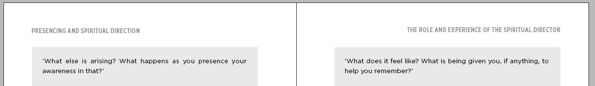

The Paragraph shading is used to create a text box with one leading height of inner margin at top and bottom and similar on the left right.

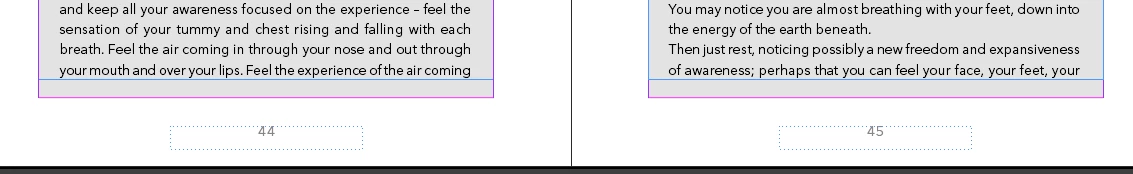

Using Clip to Frame doesn't help unfortunately. All this does is chop off the shading at the top/bottom of the frame, but I also need to move the text down by a line (at top of frame) or up by a line (at the bottom of the frame) to maintain that inner 15pt border.
This is the result I'm after, using the method outlined in my previous post.
If I use Clip to Frame, this is what we get:

You could add top and/or bottom inset to the frames in text frame options...
That could be achieved with an Object Style, I think, which might make changing after reflow a bit easier
