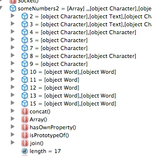

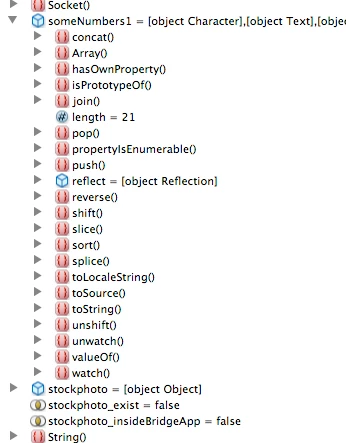

    But I've run into a problem that I cannot figure out. Below is the code:
    var myDoc = app.activeDocument;
    var firstPage = myDoc.pages[0];
    var lastPage = myDoc.pages[15];
    var myRange = myDoc.pages.itemByRange(firstPage,lastPage).textFrames.everyItem().texts.everyItem();
    //array below is all one to three digit words.
    var someNumbers1 = theGrepFinder(myDoc,"\\d{1,3}");
    //var someNumbers2 = theGrepFinder(myDoc,"\\d{1,3}",myRange);
    function theGrepFinder(docRef,grepFindIt,theRange){
        app.findGrepPreferences = NothingEnum.NOTHING;
        app.changeGrepPreferences = NothingEnum.NOTHING;
        app.findGrepPreferences.findWhat = grepFindIt;
        var arrGrepFindIt = app.selection[0].findGrep();//use with someNumbers1
        //var arrGrepFindIt = theRange.findGrep();//use with someNumbers2
        return arrGrepFindIt;
    }//end theGrepFinder
    There are two alternate vars here. The first (someNumbers1) calls up the function when text for the first 16 pages is selected. This works fine.
    The second (someNumbers2) calls up the function when a range of pages is defined, again pages 1-16, But I get a different kind of array when I do this. It will make me have to dive deep into the array for the Position property. As I also have to filter all the found numbers for only those that are superscripted, then sort them numerically, then find duplicate and missing numbers, I'd rather not mess with all the neat code I have written that already does this.
    I'll post two pictures of the data browser window for the arrays I get for someNumbers1 and someNumbers2. I know you two experts will see right away what I am talking about. What I'd like is that someNumbers2 looks like someNumbers1.
