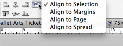

CS4. I have 4 event tickets I want evenly spaced. I put the left one where I want it, the right one where I want it. I select all and none of the alignment options at the top of the screen shot are doing anything. They align on top of each other to the left, right or center but not equidistant which is what I'm trying to do. Is there a button or setting I'm missing? Thanks.

    Found it. It's a sub menu of Objects and Layout. Dumb ass place for it.
    FivePicaPica
    May 5, 2010
    You likely have "use spacing" checked on the Align panel. It happens to me all the time.

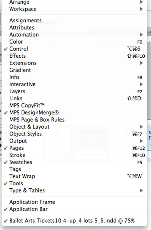

    Where might I find this alignment panel?
    This is what I see.
    And in the window menu, there is no ALIGNMENT option
    Window > Object and Layout > Align or Shift + F7

    In the alignment panel, make sure you  Show Options to see the full panel.
    Distribute Spacing is at the bottom of the panel. Click the vertical or horizontal distribute buttons to auto distribute or check "Use spacing" and put in a value to give an exact amount of spacing around each item.
    Edit: I have CS3 but I think the procedure is the same or very similar in CS4.
