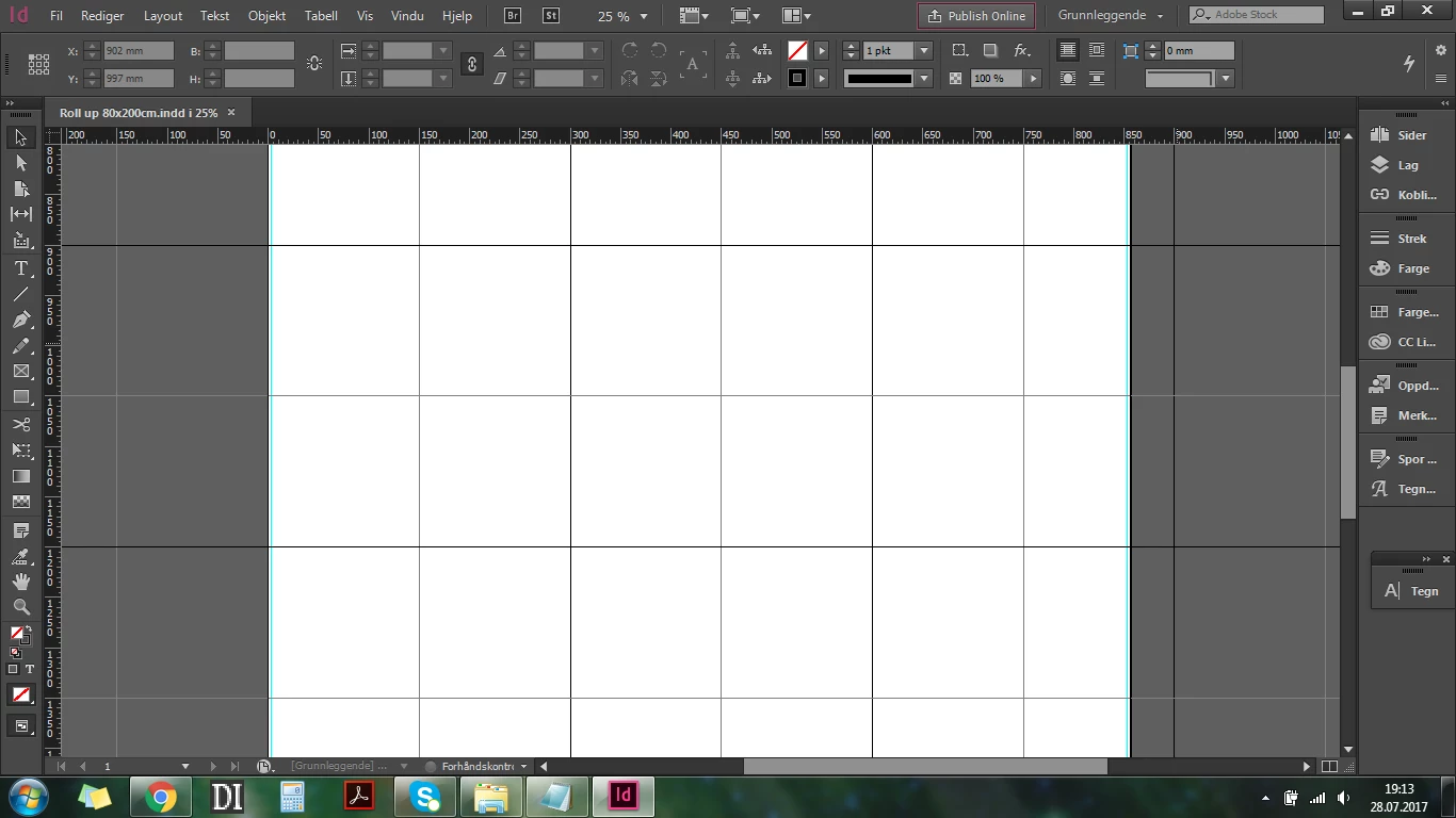

How to make the grid of squares in the middle of the document?
  • July 28, 2017
  • 4 replies
  • 8533 views

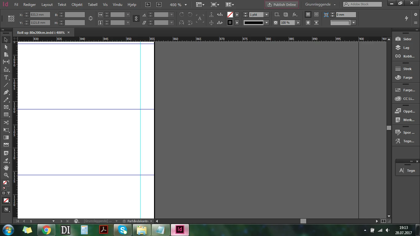

How do you place a square-format grid placed exactly in the middle of the document? Now it's going out of the document to 900 mm. I tried different values, but they all give me wrong result, sometimes it' goes far out of the document. I want it palced so that there is equal boxed all over the document. I want it stop 857 mm exactly.
Would be glad if anyone could specify the exact values I need to put in, or any other way to solve this problem.
Kind, Modassir

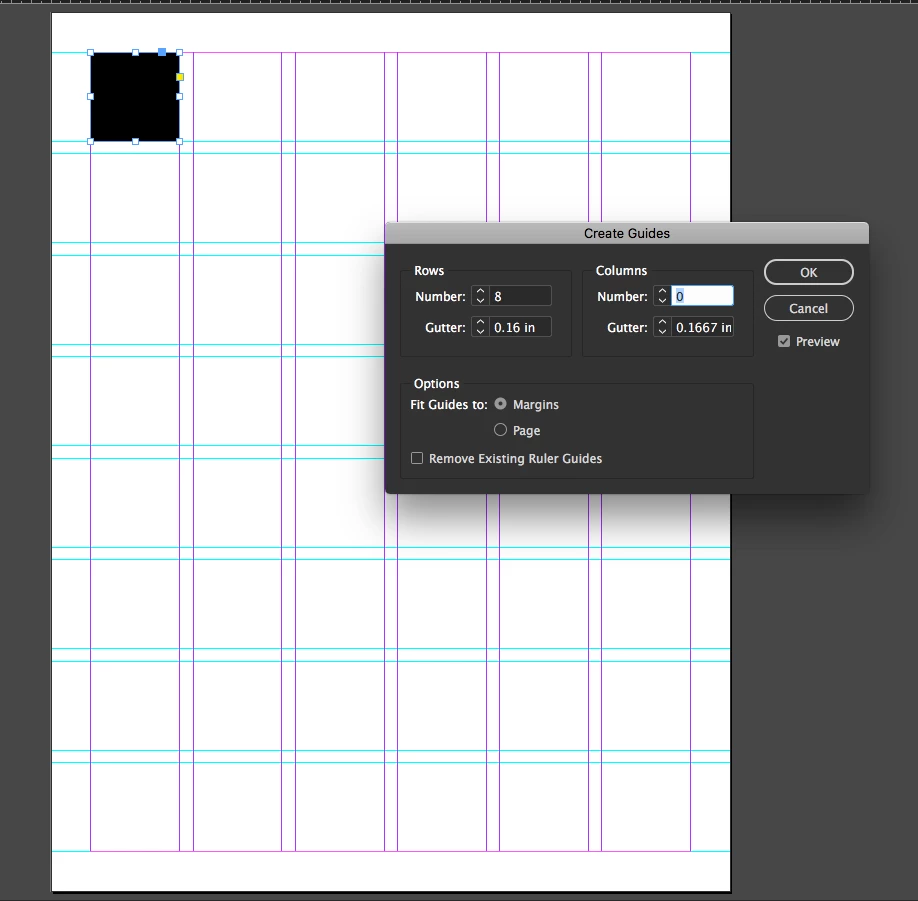

JonathanArias
July 28, 2017
i use the guides on a separate layer and lock it and use it as my grid to layout. do it for web mockups of magazine layout. i find that works. sorry. i don't use that option you speak of.
JonathanArias
July 28, 2017
as in using grid lines? like attached?
