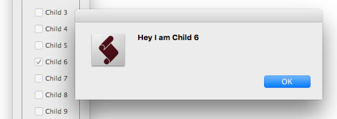

Loic.Aigon
June 20, 2016
In this kind of stuff, I would definitively avoid having to tell any of the instances to switch true/false all the time.
Here is a proposal based on a event programming approach:
var main = function() {
  var ev = new EventManager(),
  u;
  var cbx = function(p, label, v) {
  var cbx = p.add('checkbox', undefined, label);
  var mainHandler = function(data){
  cbx.value = data.value;
  cbx.onClick = function () {
  alert("Hey I am "+cbx.text );
  //Adding event listeners
  ev.addEventListener ("MAIN_FIRED", mainHandler  );
  return cbx;
  var w = new Window ('dialog','About CBX & EVENTS');
  var p1 = w.add('panel', u,'MAIN CBX');
  var cbxMain = p1.add('checkbox',u,'MAIN');
  cbxMain.onClick = function() {
  ev.dispatchEvent ("MAIN_FIRED", {value:cbxMain.value} );
  var i = 0, n=20;
  while ( i<n ) {
  new cbx ( p1, 'Child '+(i+1), false );
  i++;
  w.show();
main();
Using a library of mine:

which produces the expected result:
And yet allow some differenciation at the child level
Loic
