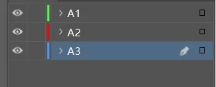

For example, I have three layers, and I want the final order from top to bottom to be:
A1
A2
A3.
I’d like to know how to use code to move A1 to the top.
Additionally, I want to move the selected object to A2.

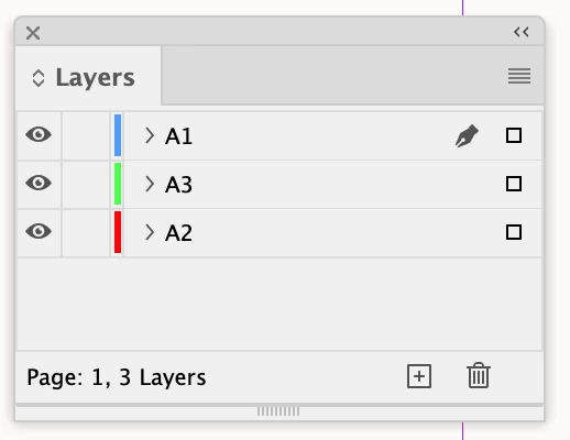

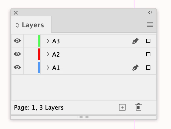

    This moves the layer named A1 to the top:
    //a layer named A1
    var a1 = app.activeDocument.layers.itemByName("A1")
    //moves A1 to the top
    a1.move(LocationOptions.AT_BEGINNING)
    Before and after

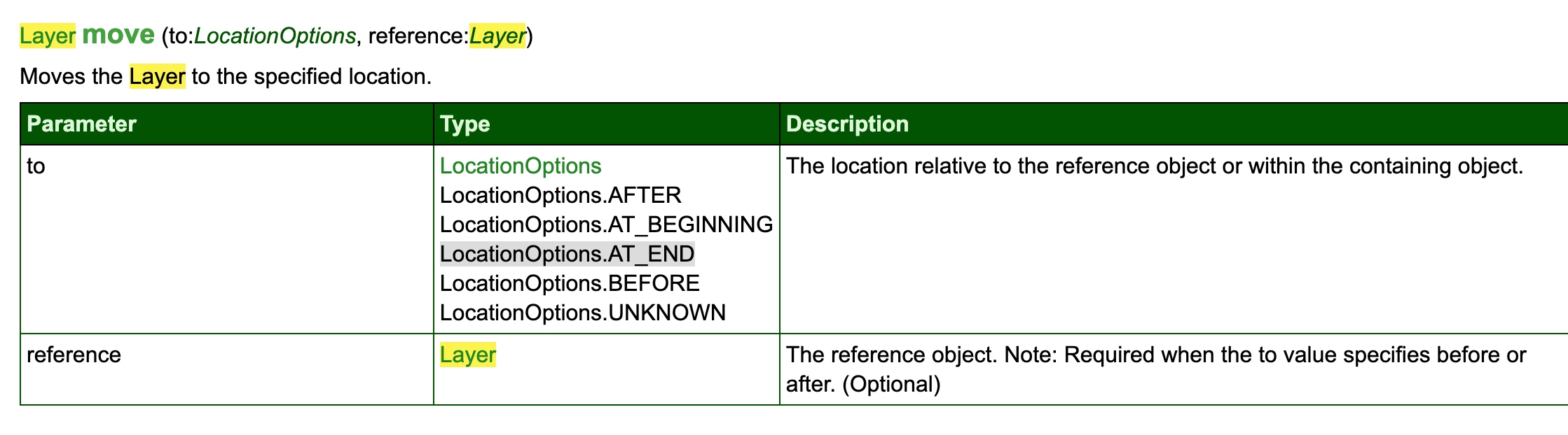

    Can I set the position while creating the layer?
    In other words, can I combine “myLayer.move(LocationOptions.AT_END);” with the following line:
     var myLayer = app.activeDocument.layers.add({ name: “A1”, layerColor: [18, 60, 29] });
    Like this:
    var myLayer = app.activeDocument.layers.add({ name:“A1”, layerColor:[18, 60, 29], position: LocationOptions.AT_END});
    rob day
    May 1, 2026 11:55 AM UTC
    There is no position property and index is read only, so I think you have to use the move() method
    https://www.indesignjs.de/extendscriptAPI/indesign-latest/#Layer.html

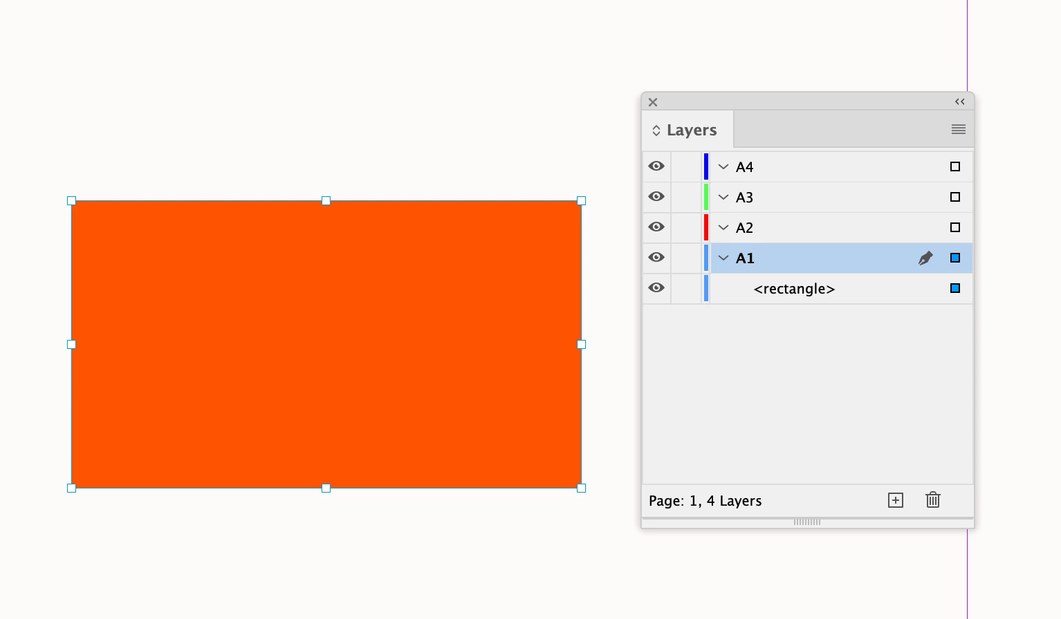

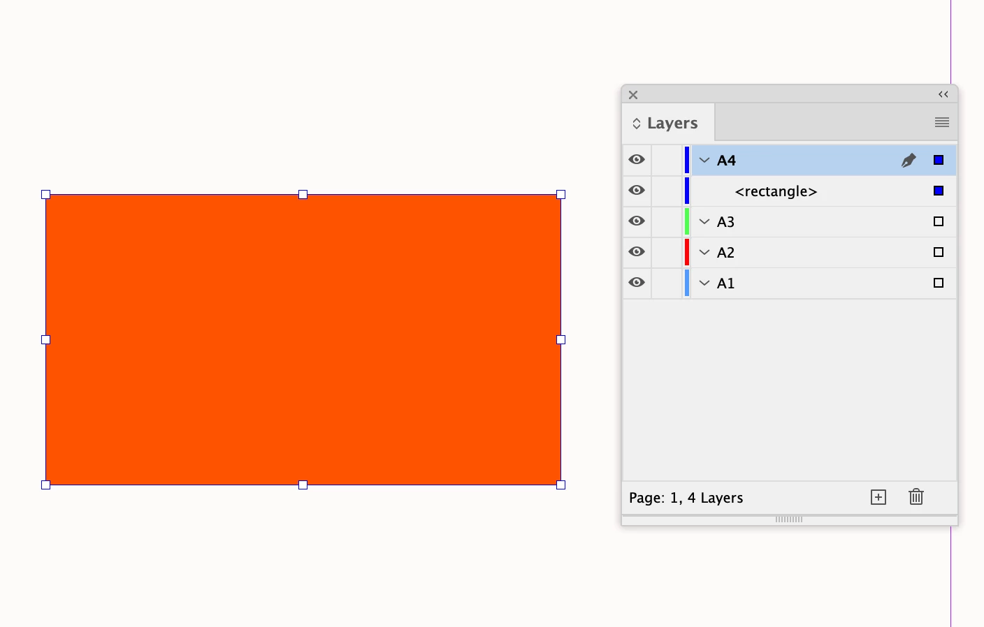

    Missed your 2nd question—this moves a selection in the bottom layer to the top layer:
    var d = app.activeDocument;
    var l = app.activeDocument.layers
    var s = d.selection[0]
    s.move(l[0])
    Before after:
