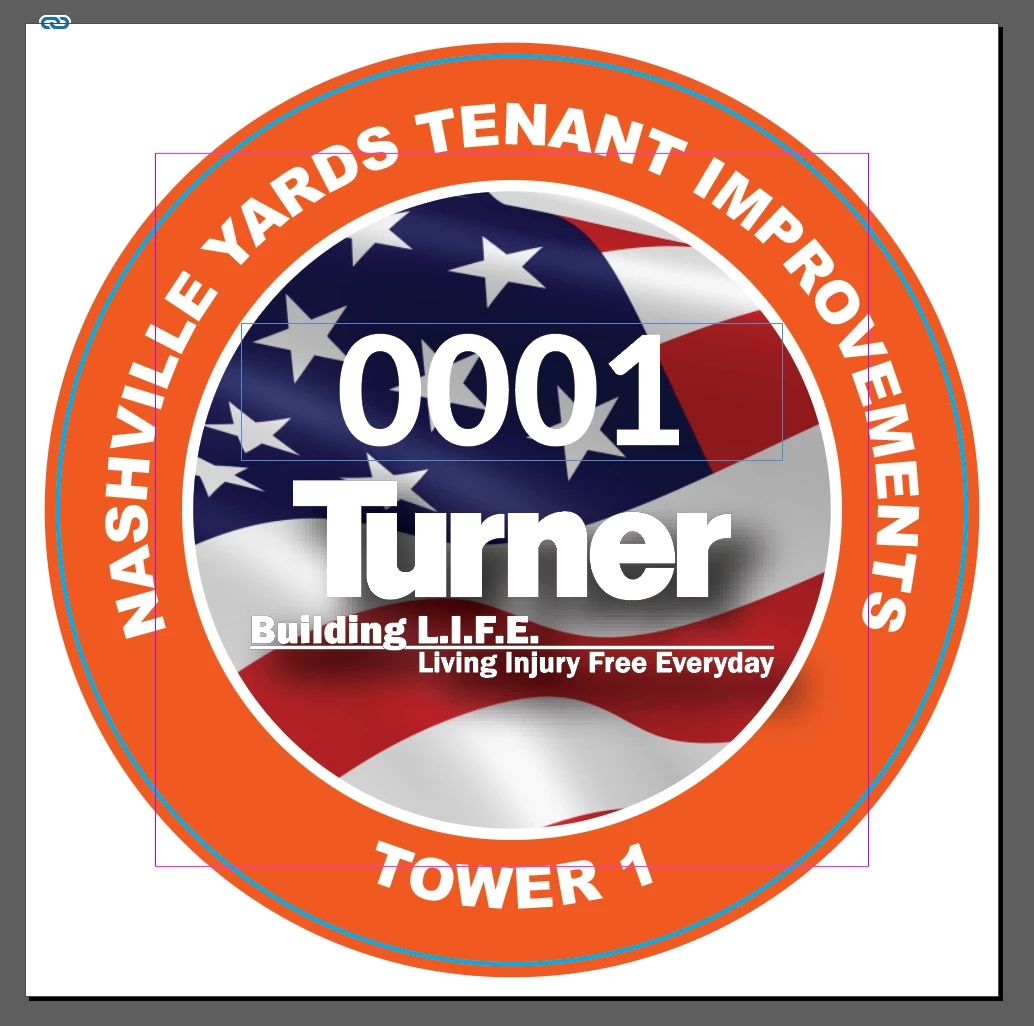

I know how to create a data merge and have already done so for my mac in excel. I took the .txt file and performed the data merge in InDesign. Everything looks great. Now my question is, is there a way to create a DIE LINE in InDesign and have it exported and still be recognized in the software for production? Does this process somewhere already exist and am I possibly creating things the hard way?
The picture I have attached with the die line is a die line file on a seperate layer in InDesign imported as a PDF. the file was not created in InDesign and my software for production is not recognizing it as a dieline.
