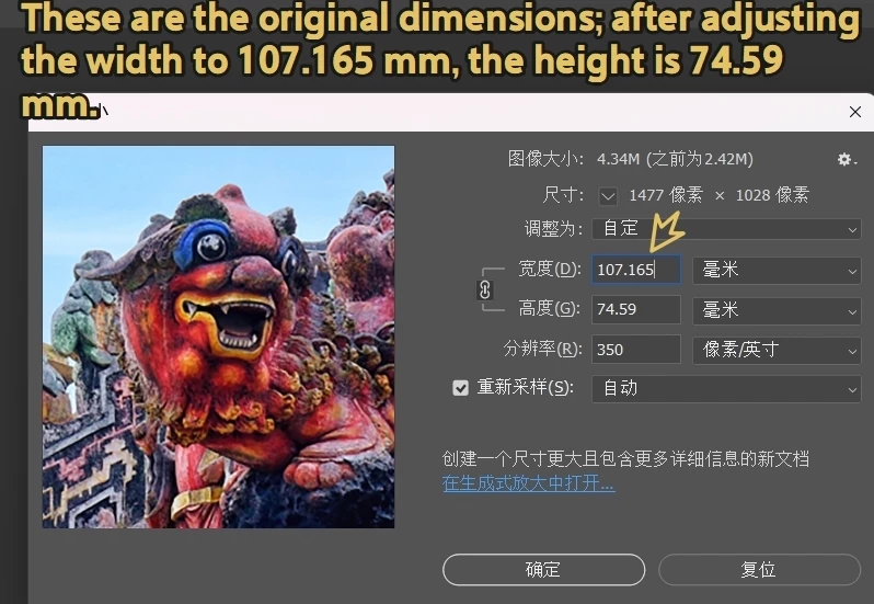

How to obtain the original height/width ratio of an image?
There was originally a piece of code used to obtain the height and width of an image.
I found that when an image is distorted in InDesign, using this aspect ratio calculation is incorrect.
This code can only be used to obtain the "usable width" of the image in the ID.
Cannot execute s.redefineScaling([1, 1]);Because it may be a design requirement at this point.
Thank you.

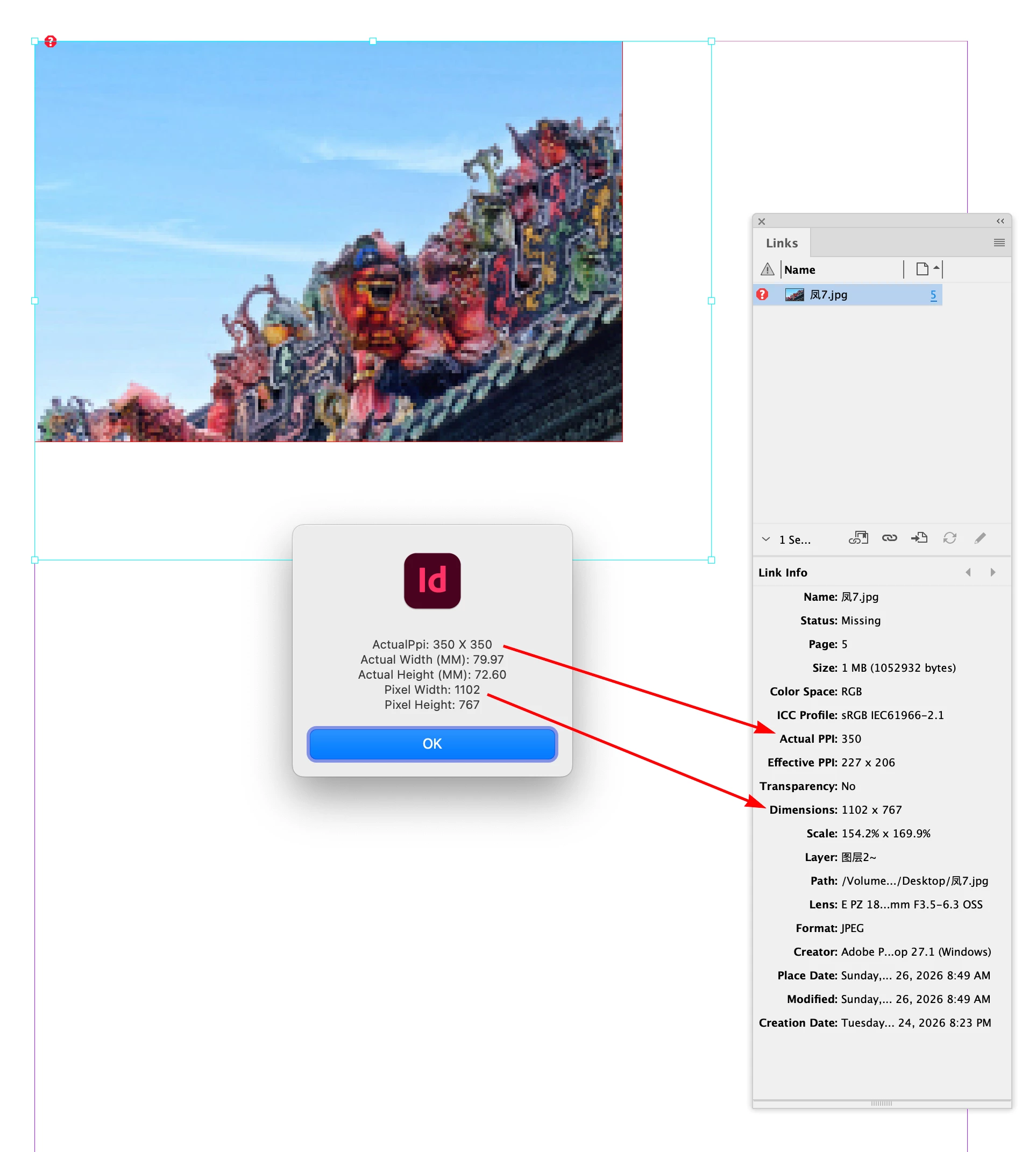

    Hi ​@dublove ,  Something like this gets the Actual PPI and the original pixel dimensions:
    //Need inches, the I in PPI is Inches
    app.scriptPreferences.measurementUnit = MeasurementUnits.INCHES;
    var d = app.activeDocument;
    var s = d.selection[0]
    var api = s.actualPpi
    var hs = s.horizontalScale/100
    var vs = s.verticalScale/100
    var b = s.geometricBounds
    var w = b[3]-b[1]
    var h = b[2]-b[0]
    alert("\rActualPpi: "+ api[0] + " X " + api[1] + "\rActual Width (MM): " + ((w/hs)*25.4).toFixed(2) + "\rActual Height (MM): " + ((w/vs)*25.4).toFixed(2) + "\rPixel Width: " + (api[0])*(w/hs)+ "\rPixel Height: " + (api[1])*(h/vs))
    app.scriptPreferences.measurementUnit = AutoEnum.AUTO_VALUE

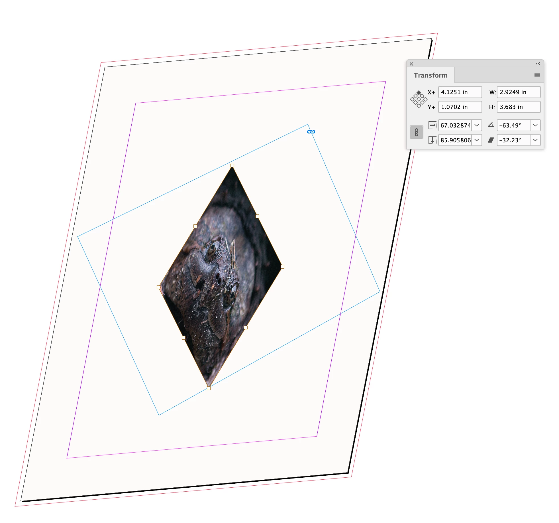

    rob day
    Apr 30, 2026 12:11 PM UTC
    The issue now is that after rotation:
    The indiscripts.com article I posted earlier explains transformations in depth.
    A transform could be more complex than your one simple rotation, and all the nested containers (including the page) could have different transformations applied:

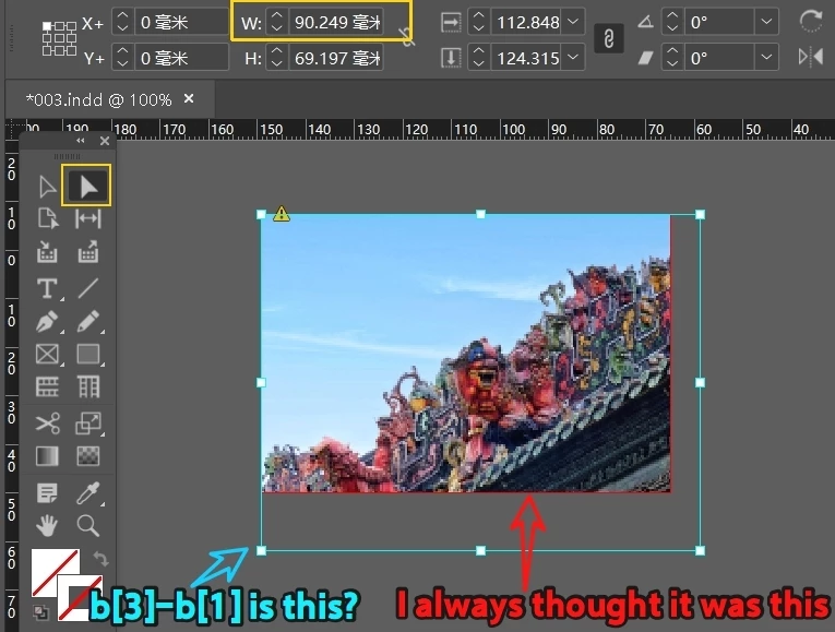

    Hi ​@rob day
    Thank you very much.
    I don't understand the difference between the following two lines:
    var b = s.visibleBounds;
    The width below turns out to be the width of the image when using the Direct Selection tool; I always thought it was the width when using the Selection tool;
    w = b[3] - b[1];

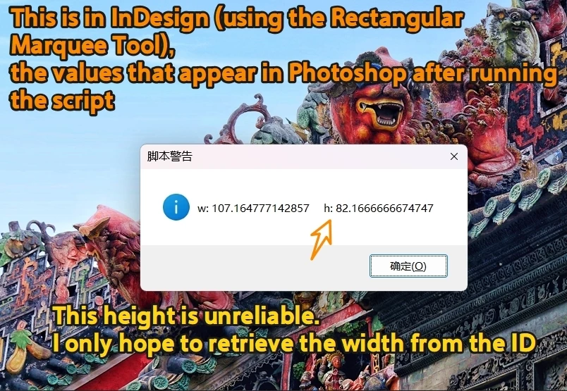

    Additionally, I noticed that when the image is 72 dpi and has been modified but not updated,
    the actual width (uw) is incorrect, and the resulting value is very large.
    app.preferences.rulerUnits = Units.MM;
    var myFile = new File(imagePath);
    var myDoc = app.open(myFile);
    myDoc.resizeImage(undefined, undefined, myResolution, ResampleMethod.NONE);
    var uw = myDoc.width.value * hScale * 0.01;

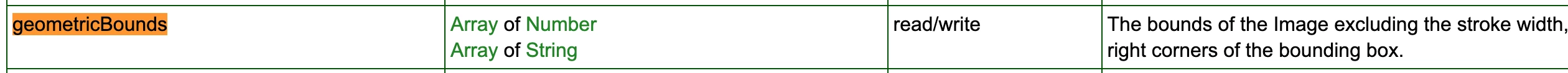

    Apr 27, 2026 4:54 AM UTC

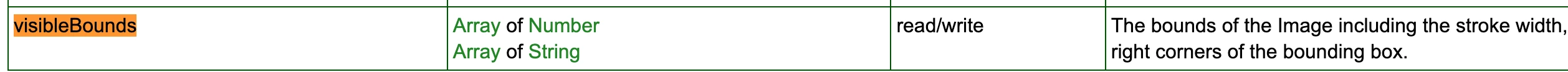

    https://www.indesignjs.de/extendscriptAPI/indesign-latest/#Image.html
    dublove
    dubloveAuthor

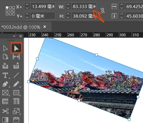

    Apr 27, 2026 10:19 AM UTC
    I understand.
    However,
    how do I indicate the boundary of an object when it is selected with the black arrow (selection tool)?
    In other words, how do I indicate the boundary marked by the red arrow?

    rob dayCommunity ExpertCorrect answer
    Apr 26, 2026 10:01 PM UTC
    var w = b[3]-b[1]
    var h = b[2]-b[0]
